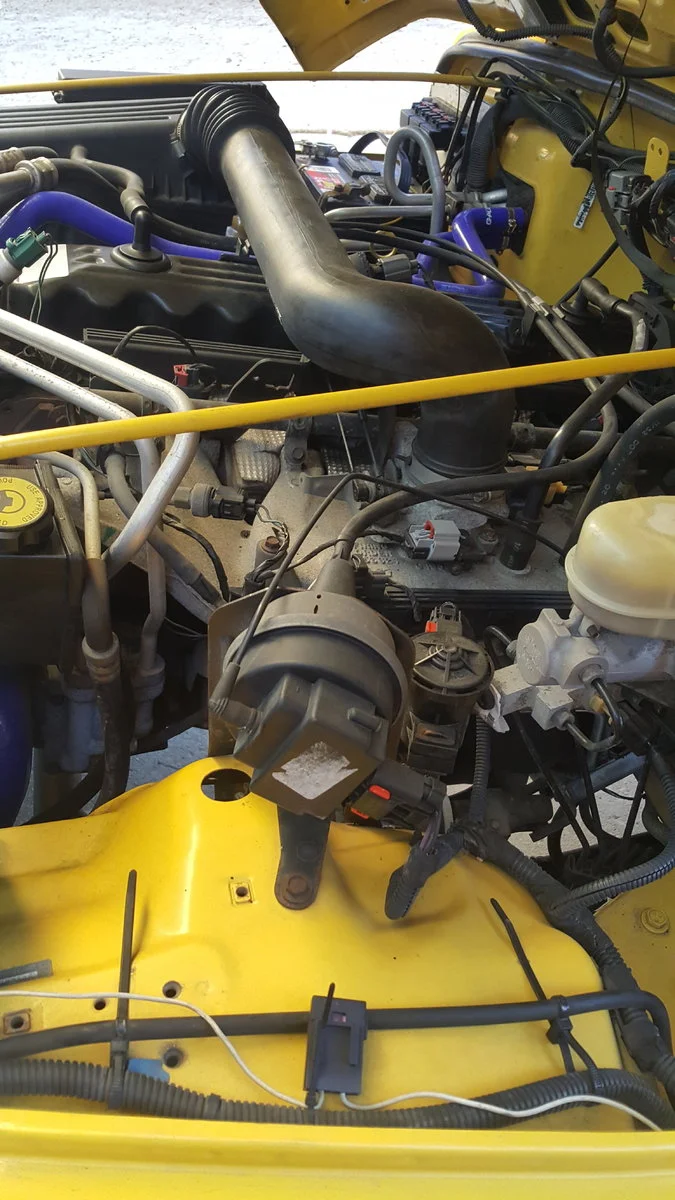

Purge solenoid is in the middle of the picture. CC connector is laying at the right. Not sure how the CC actuator mounts up with the purge solenoid. Anyone have an 03' thru 06' with CC and the purge solenoid and can send me a pic of how it all fits?

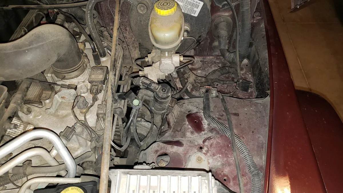

Found the entire assembly at a local salvage yard today for... $19. Was quoted $125 from a yard in FL. Big shout out to 'Wheeling diver' for the pics on what to look for. Thank you.

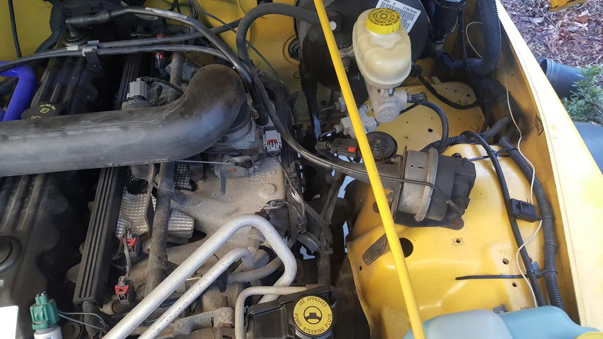

Well, I've been out of town and on vacation for a while so I finally got around to installing the servo and cable today. Cruise control works great. Again, thanks for all your help in getting this sorted out.
