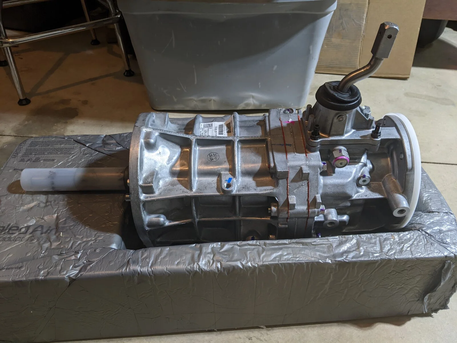

On the plus side, the new trans I put in feels and shifts like it should, and have not had any issues at all.
I am not certain, bell housing may be different, but it might be the same trans in a JK. I know a lot of the rebuilt (reputable) NSG370s have the redesigned parts in them, and should not have the same issue.

Here's my solution to the NSG370 problem.
