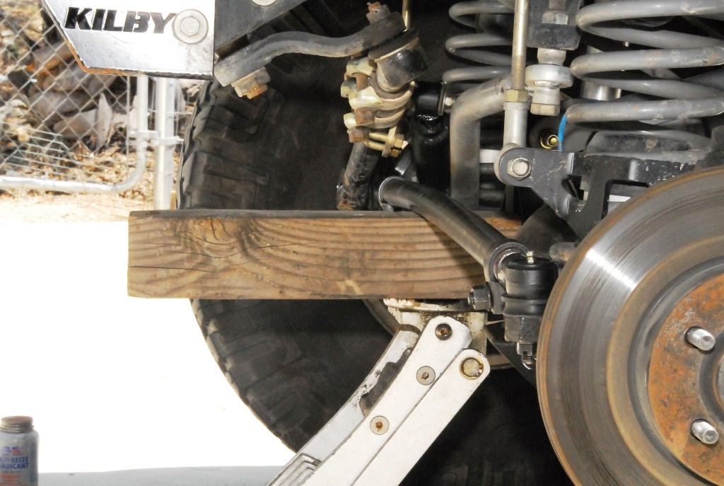

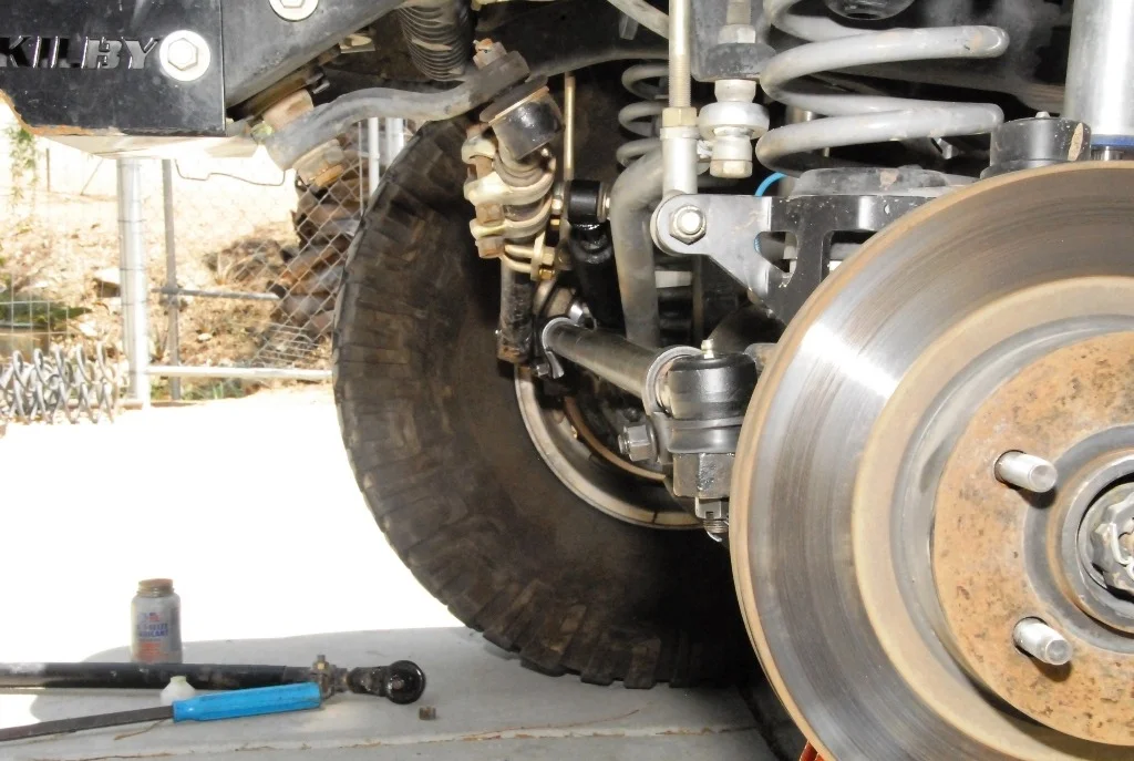

The Savvy aluminum tie rod is also thicker than Currie/RockJock and can create clearance problems that the BMB heat treated steel tie rod does not. BMB is the better product.
Reactions: Irun and Mike_H
1.25" vs 1.5". Another vote for the 4340 tie rod.
