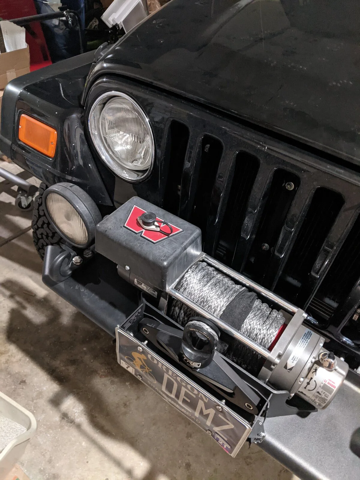

I think the only somewhat prominent non-Jeep logo I have on mine is the Warn sticker on my winch. I like it that way.

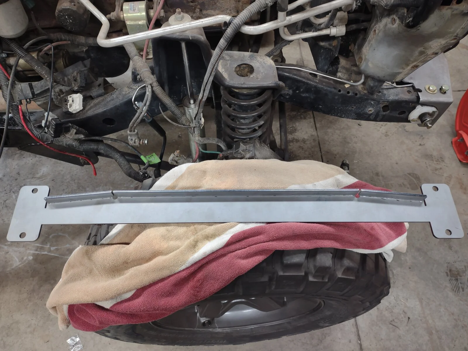

Finished up the rear bumper tonight. Mostly ready for powdercoat. I need to drill a couple more holes near the hitch, and make sure all my mounting holes line up.
Got the reinforcement plate done for the hitch. This is a convenient place for tie downs and what not... Not safety chains, lol. View attachment 238768
When I got the bumper, I was disappointed that the shackle mounted were not welded on both sides. Make sense, cuz it's supposed to fit flush with the cross member, so a big weld bead would be in the way. I had another idea and got my 1/2" roto-broach out. Bored a couple holes through the plate into the shackle mount and plug welded.

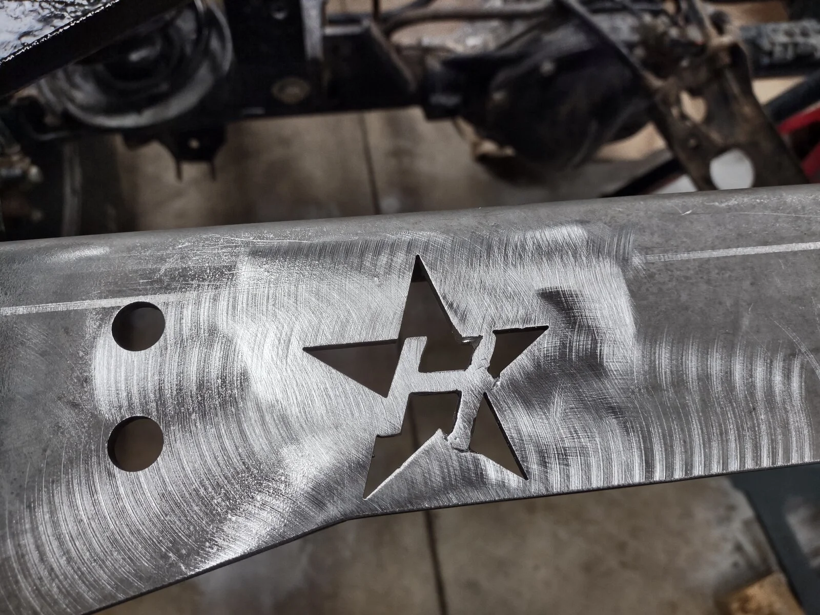

I'm not a big fan of logos cut into the products I buy. I've already given them money, I don't need to also be a billboard. Plus... This thing isn't really a Barnes bumper anymore. So...I changed the logo..
Finally, I fired up the grinder for little bit. Got rid of the weld beads on the ends, so they look like one piece.

I'm really happy with how this turned out. I can't wait to get it powder coated and see how it looks with the rest of the Jeep back together.
I feel the same way. Drives me crazy specially when it removes material. I like the idea of this bumper and may steal it this summer! The current bumper in the back of mine is a Smittybilt unit and it is heavy.
Same here. Other than that red W, there is nothing on mine. Since mine is older, the W is on the top instead the front. I have contemplated covering it with a sharpie! I also removed my Rubicon decal. What's the point? 🙂
