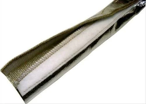

This is the insulation Mopar specifies for that fix.
https://www.amazon.com/gp/product/B007O3QHDK/?tag=wranglerorg-20

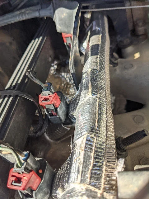

The mopar kit is a bit overpriced. I just did mine and used this thermo-tec stuff. It works really well and you can do the whole fuel rail.
This cost less, that's all I was getting at. Either work and I saw the ship had sailed, really just posted so other people see there are other options.
