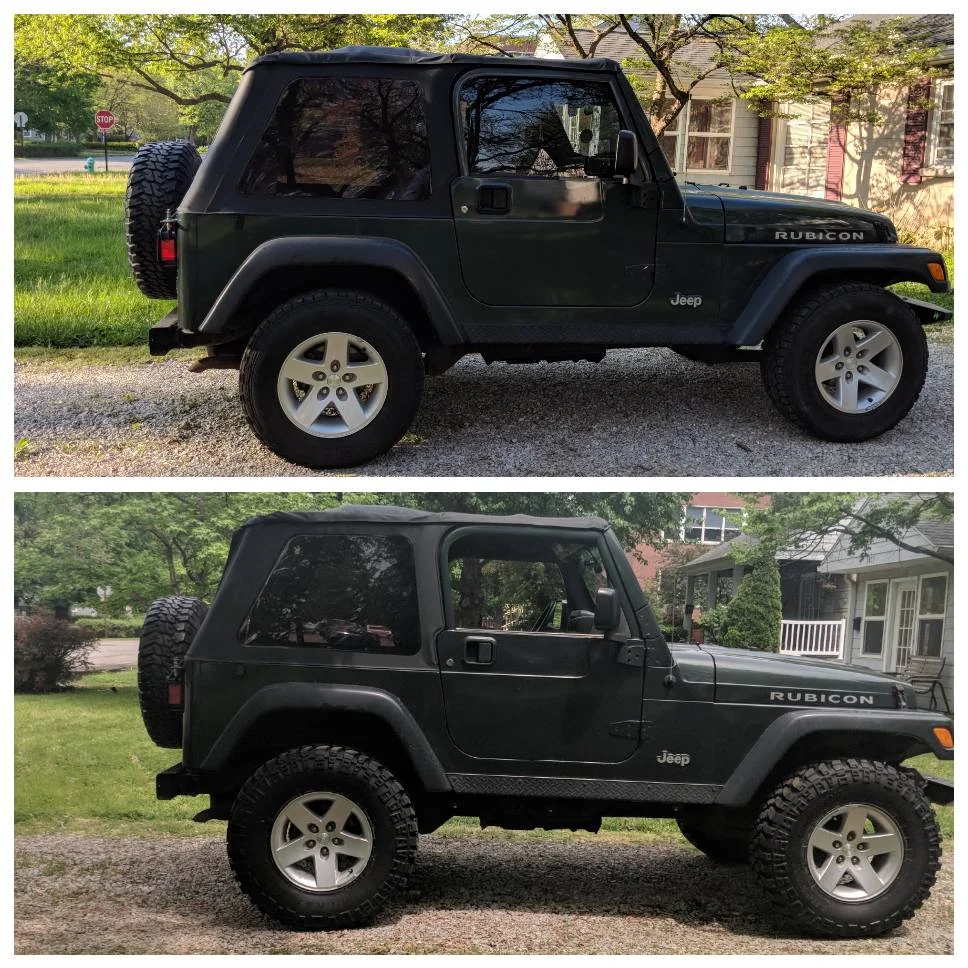

Big fan of the ELG color! Sharp looking Jeep! Mine is shale green metallic. I also recommend the OME kit. On top of that I also have a 1.25 body lift (and a few other minor suspension parts) to fit 33s. Before /after pic. Rides great.

I needed new tires so I made the jump to 33s but my original plan was to use the tire size you have and just the OME kit, I don't think the tires will look too small.

Big fan of the ELG color! Sharp looking Jeep! Mine is shale green metallic. I also recommend the OME kit. On top of that I also have a 1.25 body lift (and a few other minor suspension parts) to fit 33s. Before /after pic. Rides great.View attachment 43322

That’s a nice green Iperk. Yeah I’m going for it. 2” 0ME springs, Probably Rancho shocks, and small BL up front to level.
