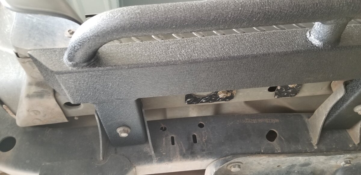

Mated up very nicely. Nice and snug with no interference.
They bolt onto the body mounts. Remove body mount and bolt, slide the 3 mounting plates into the body mount channels with the rubber mounts inside the slider channels and reinstall the body mount bolts. Very simple. Installed by myself today.

They bolt onto the body mounts. Remove body mount and bolt, slide the 3 mounting plates into the body mount channels with the rubber mounts inside the slider channels and reinstall the body mount bolts. Very simple. Installed by myself today. View attachment 165994

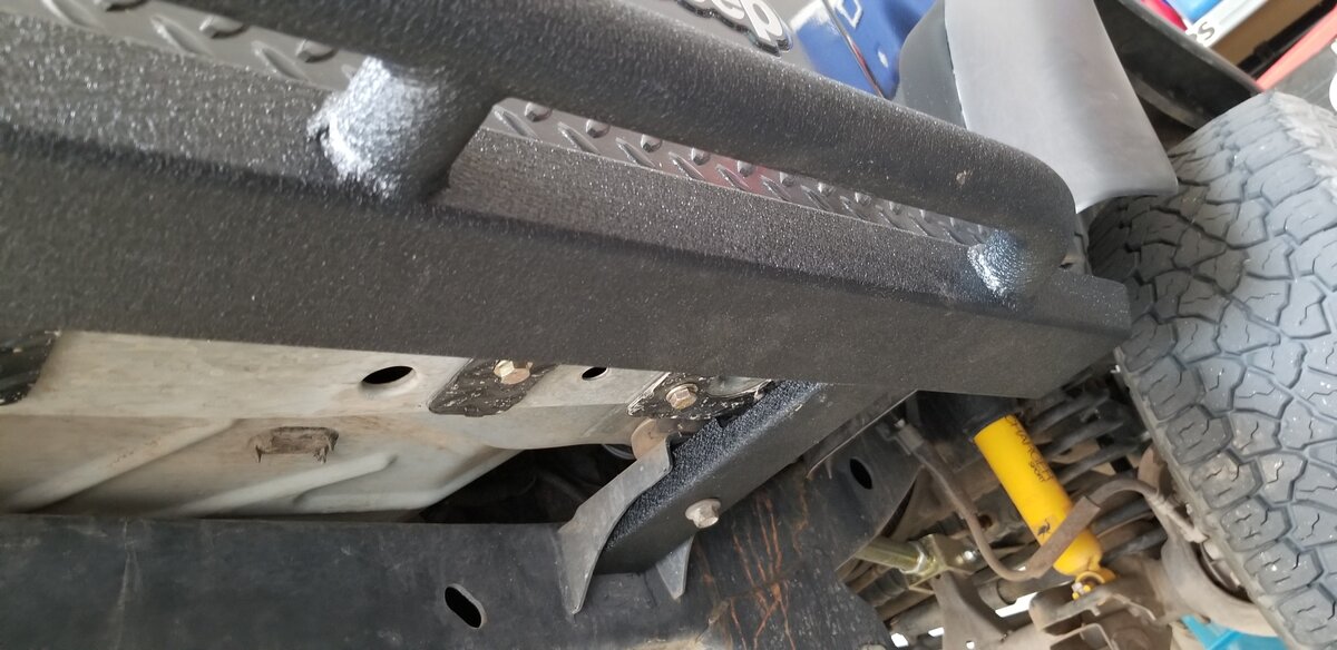

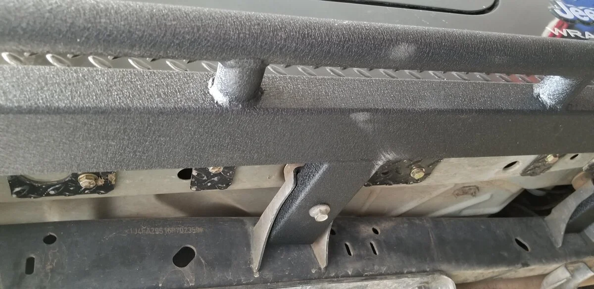

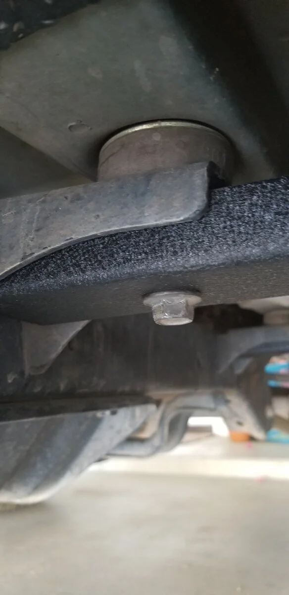

They do make for the LJ as well. More than a flat bar. The sliders themselves are a beefy rectangular tube under the rocker panel and the 'arms' we'll call them that mount are channels that slide into the frame channels where the body mounts are. These are looking at the mounting arms/ channels from underneath the passenger side; rear, center, front.

Here you can see the both the Rubicon rail mounts (2 black tabs wrapping under the rocker) and the body armor channel mounts.
I don't have any pictures underneath from before mounting but if you look under your jeep, you'll see the body mounts have 2 rubber pieces, upper and lower, with the lower ones on the underside of the channel in the frame.
To mount the body armor rails, you remove the lower rubber piece and insert it into the channel on the body armor rail and reinstall the bolt up through the body armor rail and rubber snubber back into the body mount where it came from. That factory rubber snubber is still there; it's inside the body armor rail channel, below the visible one. It's the same for all 3 of the channeled mounting results.
