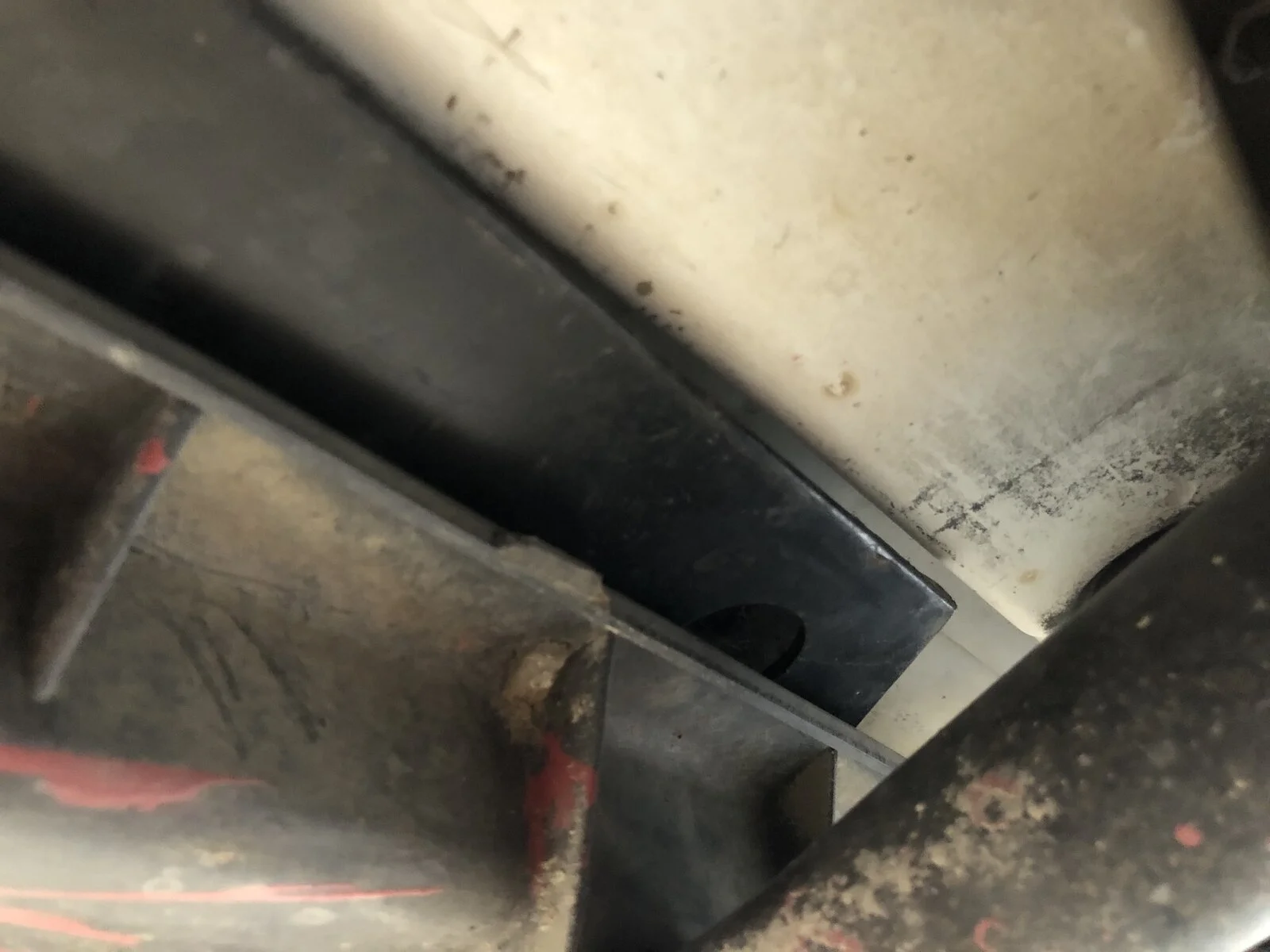

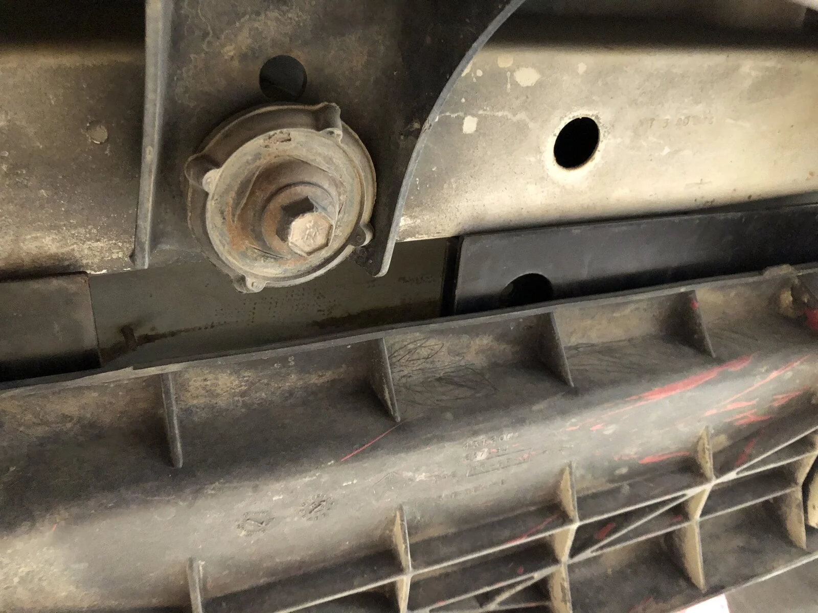

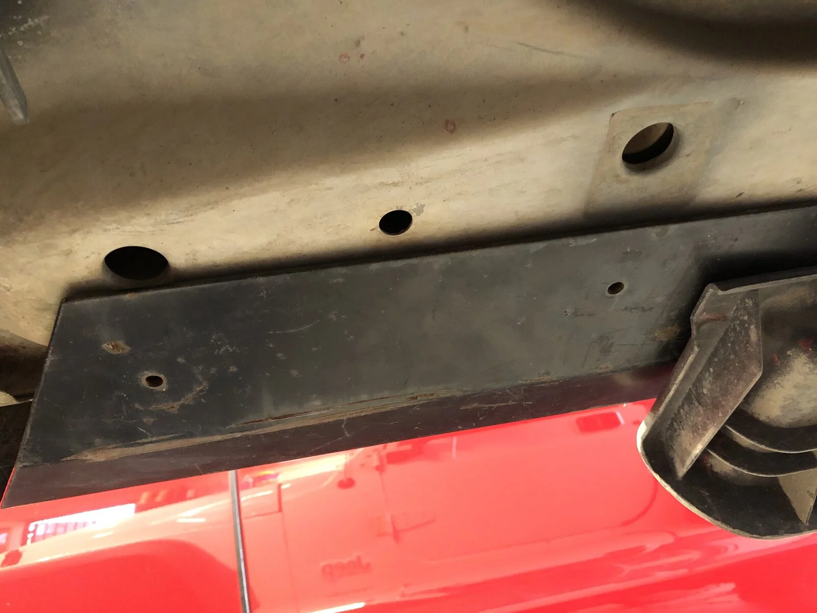

4)Look at the bottom pictures, (I know they are not pushed in all the way but this allows us to see where the bolt holes line up. They line up with the big drain holes and recesses in the tub. Do I drill through these holes and put a bolt and washer in these or a nutsert?

Also, just for clarification, I need to drill through the large drain plug holes and into the cab portion of the tub to install the nutsert? If I am going all the way into the tub from the bottom, can I just use a nut on the inside? Or do I move the rocker slightly forward or behind the large holes to get the nutsert in the square tubing of the tub (I may have it slightly off in location since I have not taken the fender flairs off yet)? I hope I am making sense with that.

I don't recall anything but nutserts in blind holes that you could not get a nut on the other side. If they are hitting in a hole, that seems to be improper location of the slider.

They are rock rails, they bolt to the tub. Where you can through bolt, you use nuts, where you can't, you use nutserts. This isn't hard and it really doesn't need instructions. Just push them up in place, drill through all the holes with them where they go, drop them, any place you can't see how to put a nut on, enlarge the perfectly located hole and install the nutsert that works with the fastener of choice.
