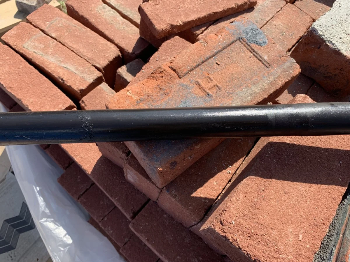

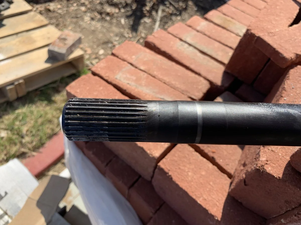

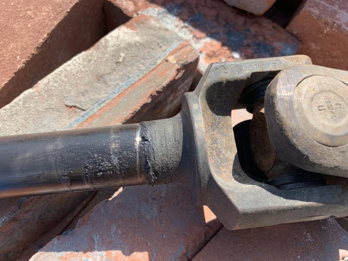

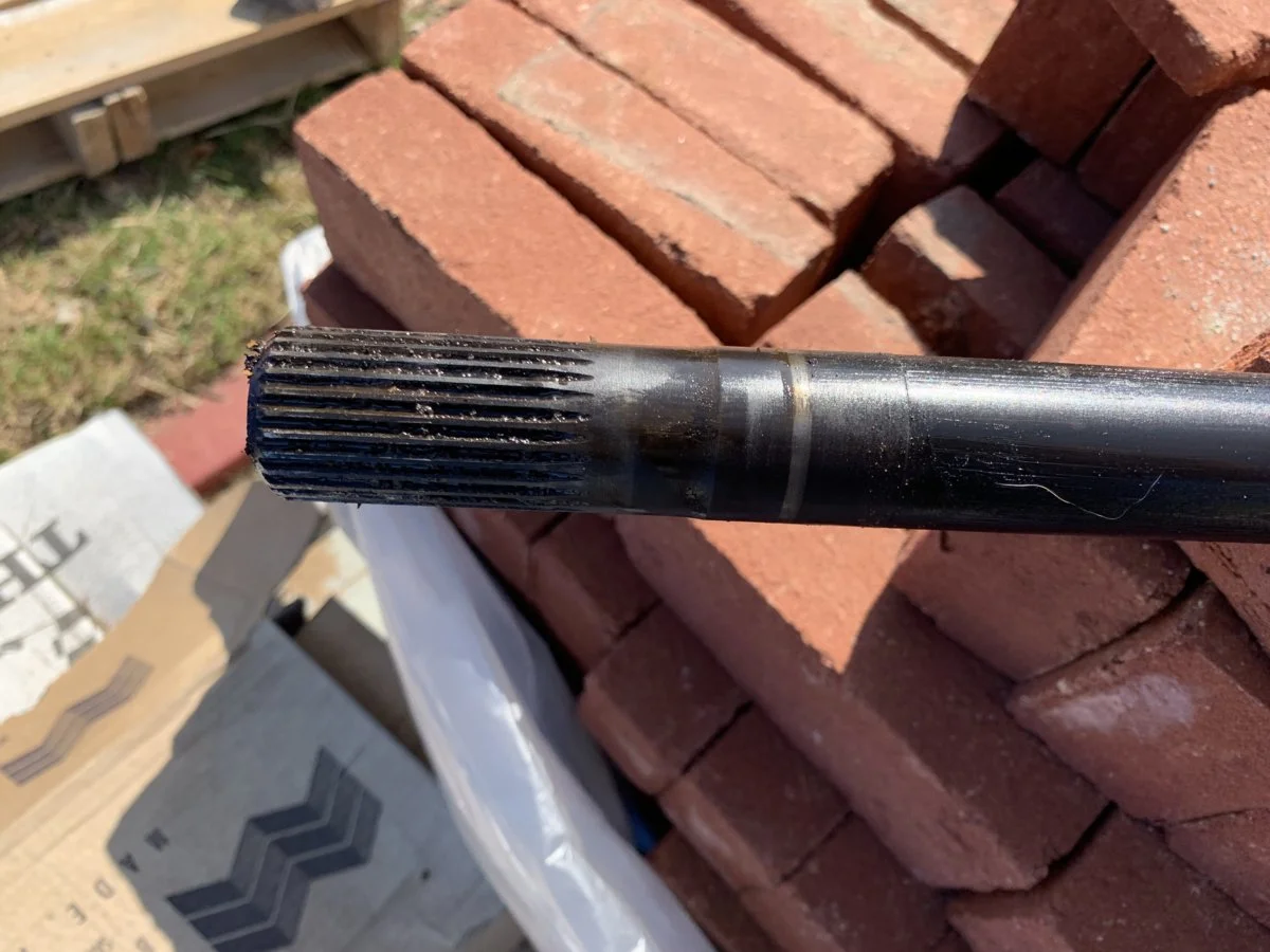

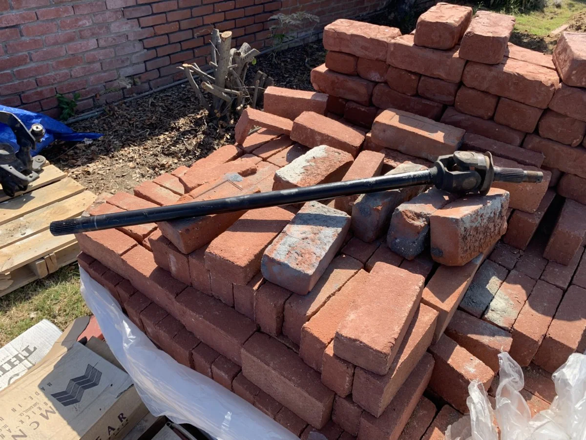

How can I tell if my my axle shafts are stock or upgraded Chromoly?

Post pics of shafts, and we can tell you if they are stock or aftermarket.

The gears are not transferable between LP and HP axles because they are cut differently but everything else is. Diff cover bolt patterns are the same. It's easy to tell most aftermarket rear shafts from OE factory shafts but I'm not thinking there's an easy way to tell the front shafts without experience with both shafts.

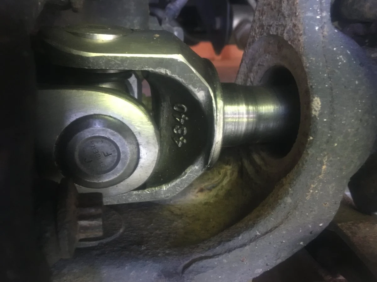

My front alloy chromoly shafts have no distinguishing marks. My RG&A front shafts however, have Foote stamped into the ear. I believe even the old superior shafts had "superior" stamped on the ear too
