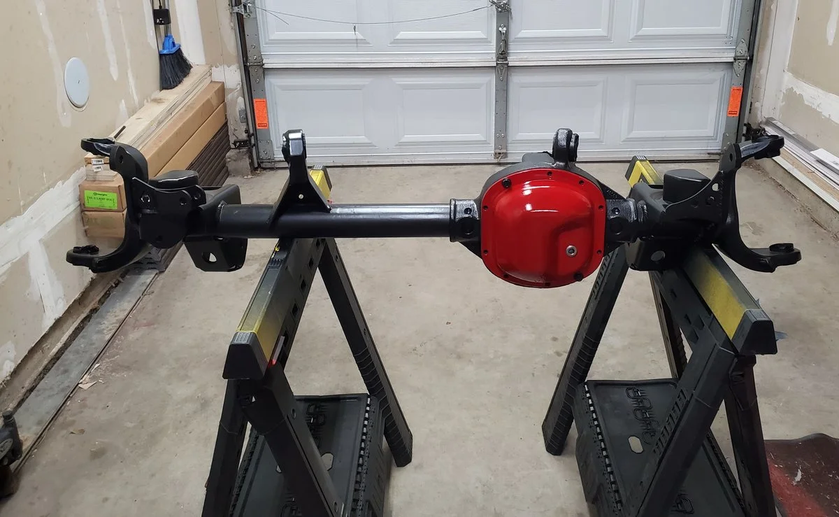

My last two d30s held up to regular rock crawling here in CO. I got a decent deal on a pair of high pinion d30s and built one of them up. With 3/16" brackets and chromoly shafts, its the last thing on my mind when wheeling. The 44 shares all the same parts as the Dana 30, it just carries the "44" name that people like. Save your money, build a 30 (or straighten out your current one) and go have fun
