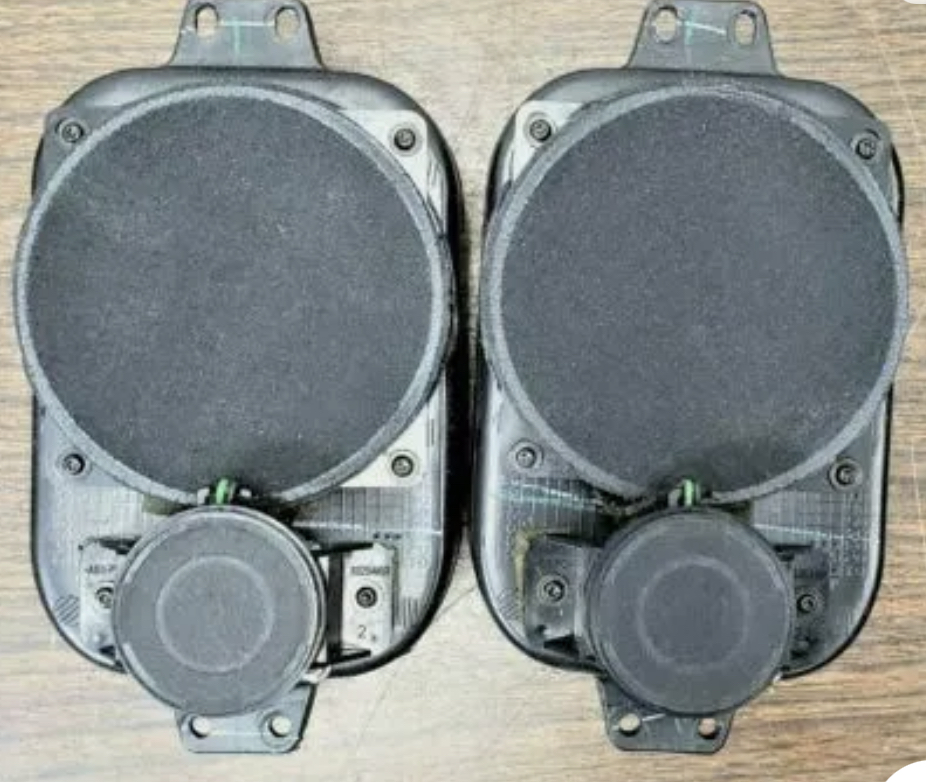

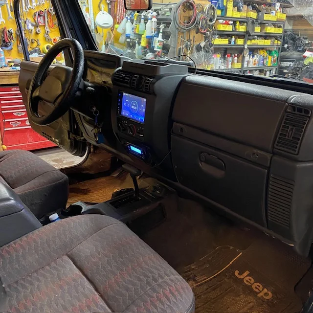

related note I am not sure all TJ years have same component speaker arrangement as my 05' . I have only seen coaxial posted so just sharing a photo. I already tried changing the mounting orientation to better tilt these up- which was not successful change to front staging.
If you put the mid of component set under the dash by your knees, don't expect any mid-bass. They are free-air when they are mounted in that location. I moved my 6.5" mids to the roll bar, with the inside of the pods dynamat-ed and polyfilled, and the mid-bass is still severely lacking, and almost non-existant.
I'm running the component set off of a 400x4 amp, bridged down to 200x2.
Great pic, that is were I’m think my about

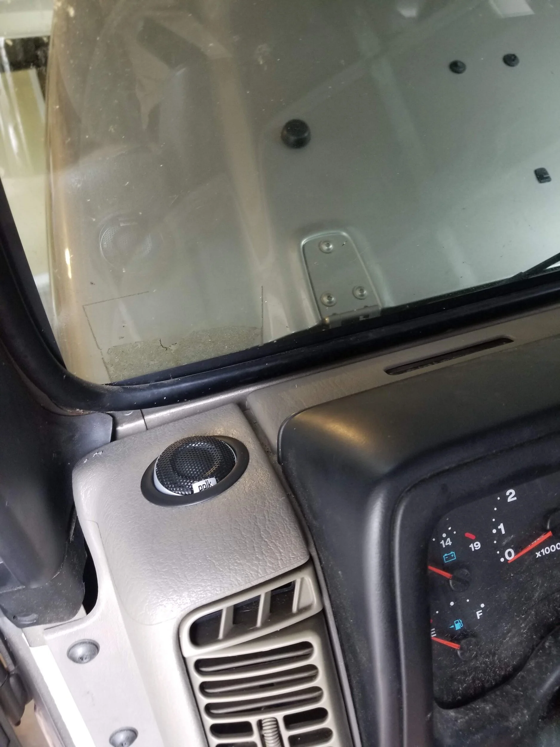

What did you use to make holes? A hole saw, a dremmel, utility knife.
