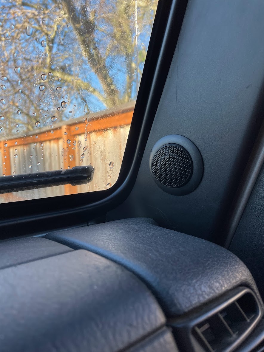

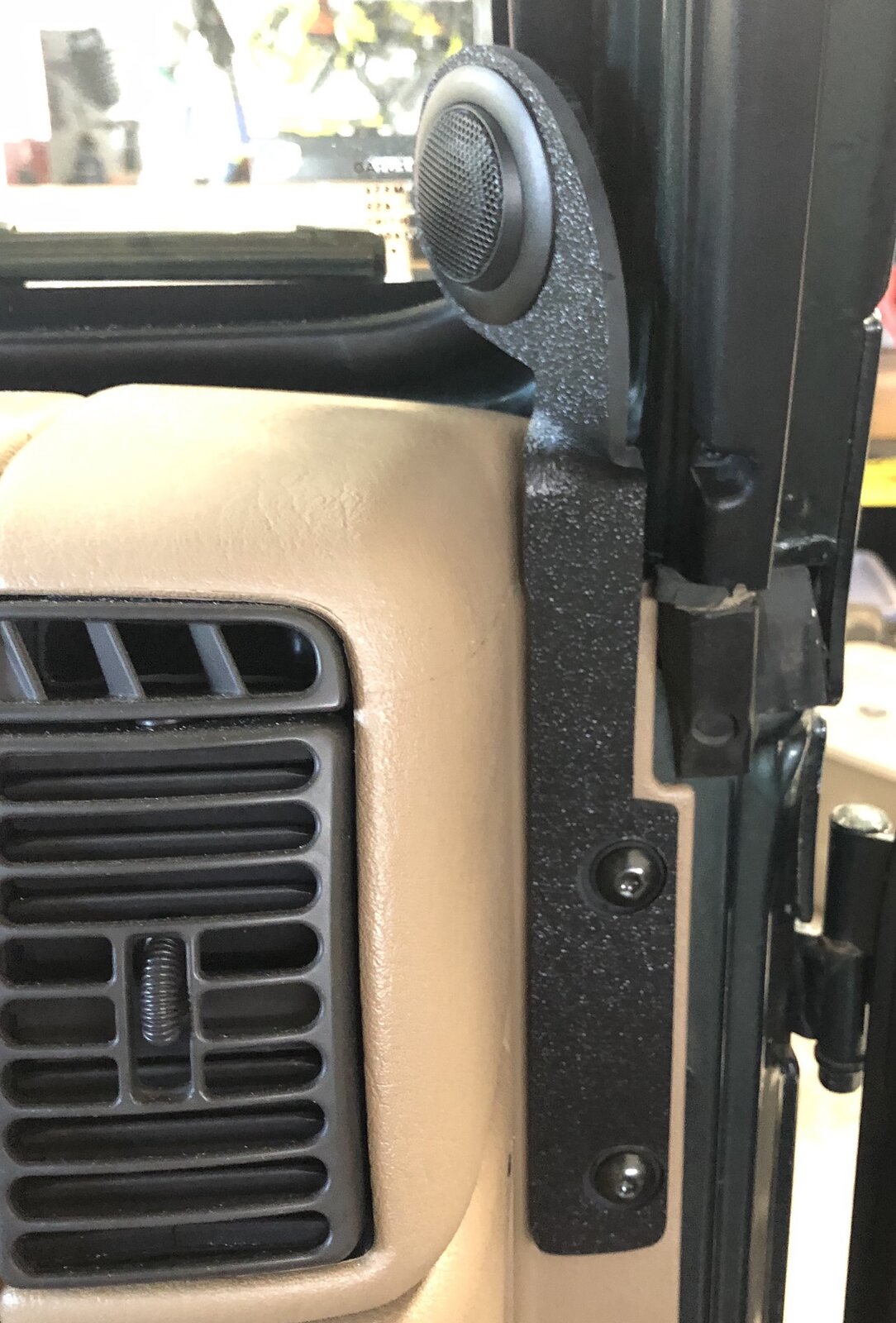

I built these out of 1/4 ABS. 2 inch hole. Alpine R-series Tweeter. Made a huge difference from down below.

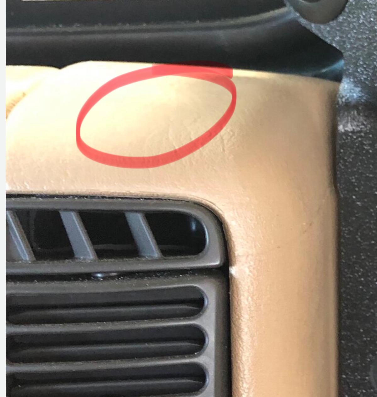

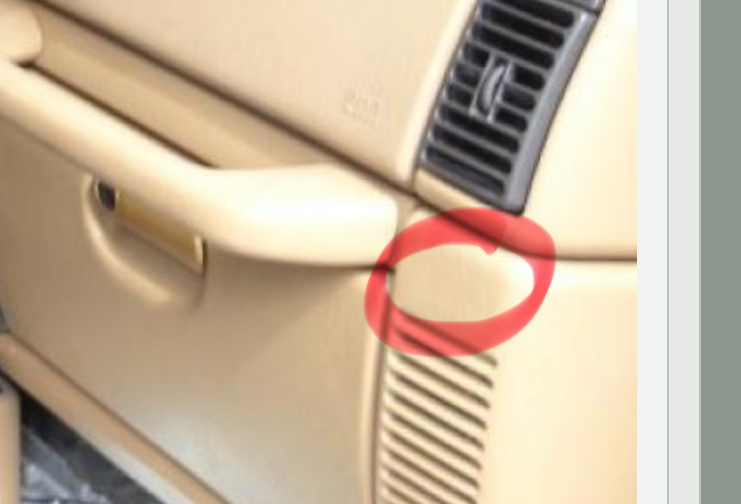

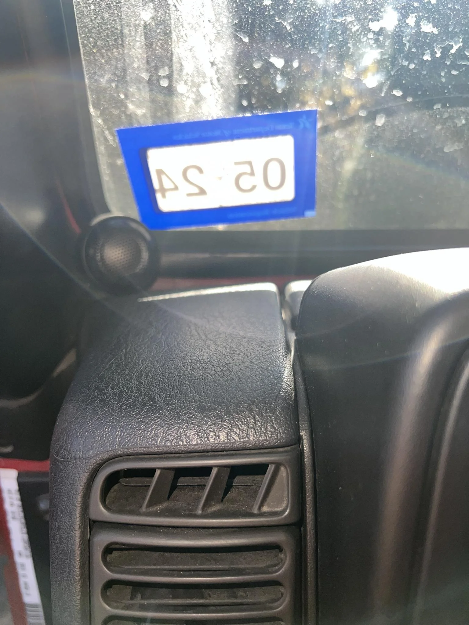

Was looking for options to mount tweeters and saw this old thread so decided to use it. Has anyone mounted tweeters in the top of the dash? I’m wondering if there is room to recess or surface mount a tweeter on top. It might be tricky to drill the hole up there. The other thought I have is to surface mount / recess the tweeter in the area just above the speaker opening.
I think there is enough room in the top image. Felt from the back and I think its pretty open above the vent. Need to find a tweeter mount that sits in at an angle so you can direct the sound toward and not upward. Or just surface mount with a pod.
Thank you. Was wondering if it would need to be angled or could just face it up or not.

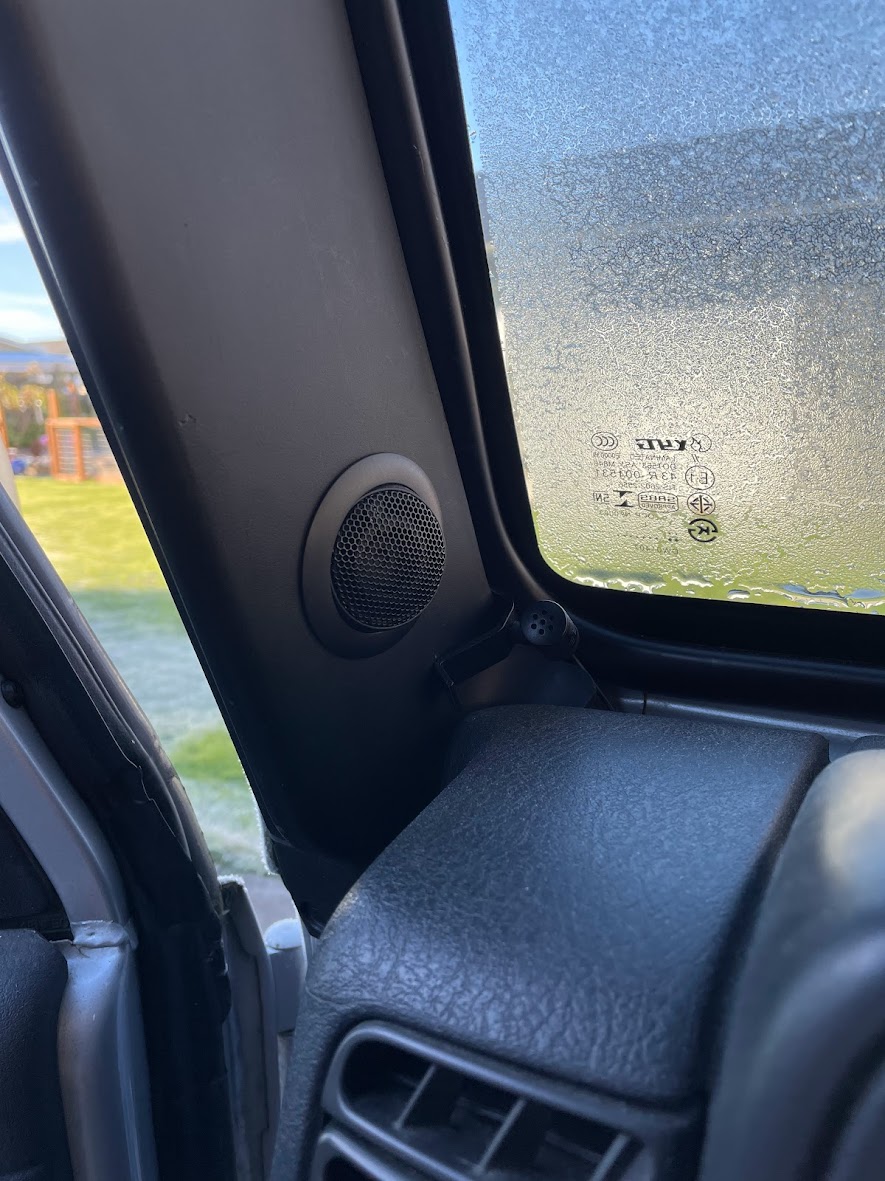

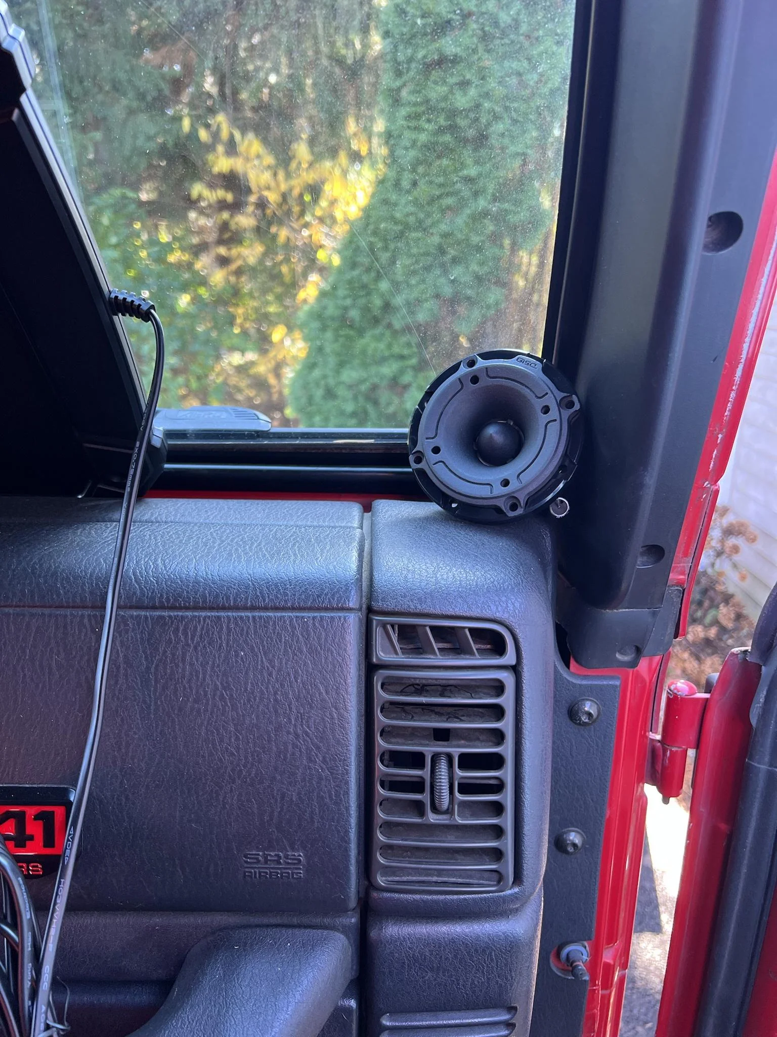

My tweeters are on the dash in the corners with 3M tape behind their factory enclosure. I considered 3D printing a mounted pod, but this is simple and just works perfectly. They are sticking to the corner facing the listener. Now I have a far better sound stage

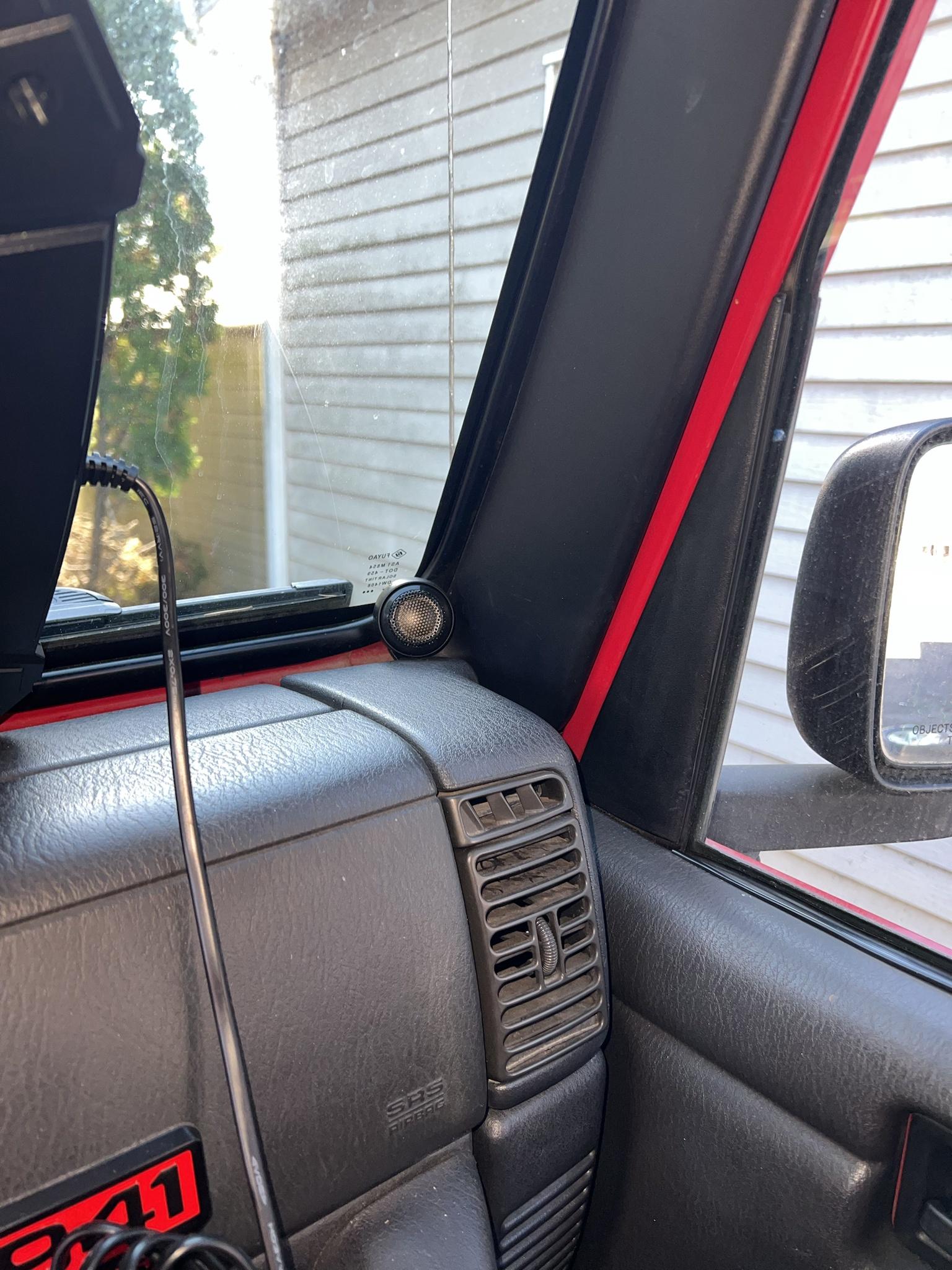

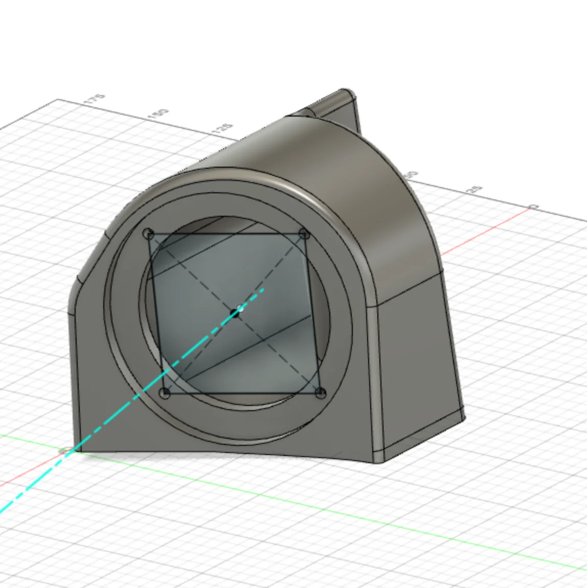

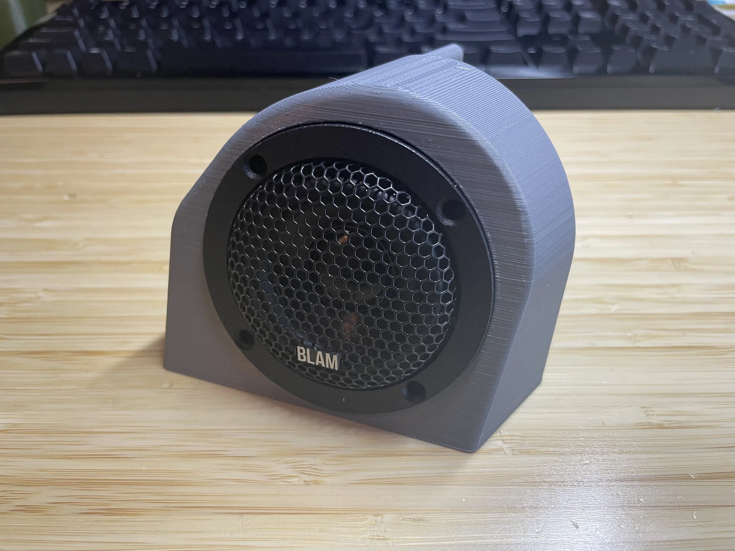

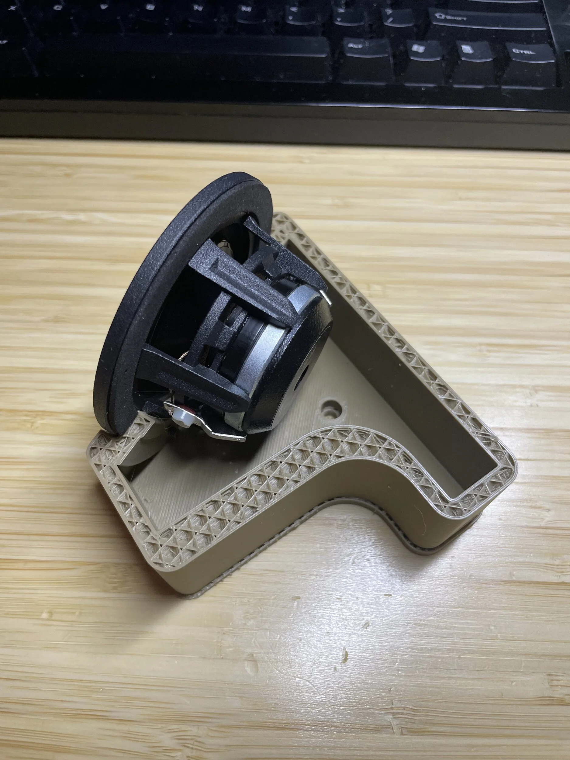

I started playing around with 3D printed dashtop pods. This is for a BLAM 2 inch driver. Unfortunately, PLA+ isn't up to the heat of the Floridian automotive environment.
I may use this idea for the larger tweeters Im gonna try out.
I like the idea and how you mounted it to the dash sides.
So this and a jig saw and some sanding eh??
https://www.amazon.com/dp/B0B7MDWGJR/?tag=wranglerorg-20
Yep.
Actually a template and a router to finish it off once you've rough-cut the ABS with the jigsaw. Luckily the dash is pretty much symmetrical, so you can just flip the ABS, tape both sides together with some double sided tape and have at it.
I also had to counter-sink the bolt areas to about 1/8 thickness but that may not have been necessary.
