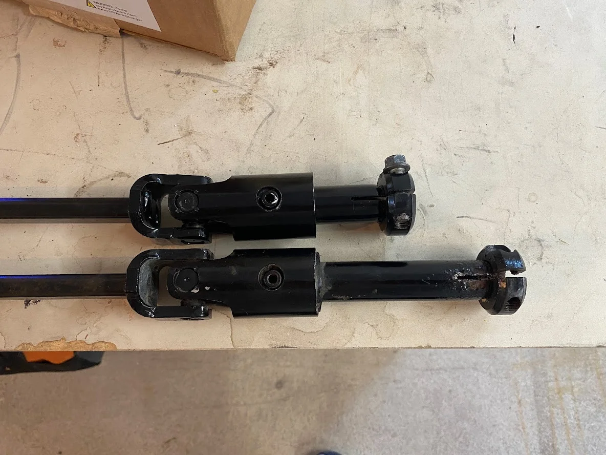

I thought I had my Death Wobble tracked down to a worn-out steering shaft joint (not the u-joint, but rather the pin+isolator that joins the upper and lower halves). I finally got my new PSC XD box in the mail and I installed it this weekend, alongside a brand-new Mopar steering shaft, with no difference at all :confused: I am still getting the typical road-induced DW about ~48 MPH.

- "Dry Test" - after performing this a handful of times, I was able to track down the joint at the above-mentioned steering shaft. Nothing else can or has been noted.

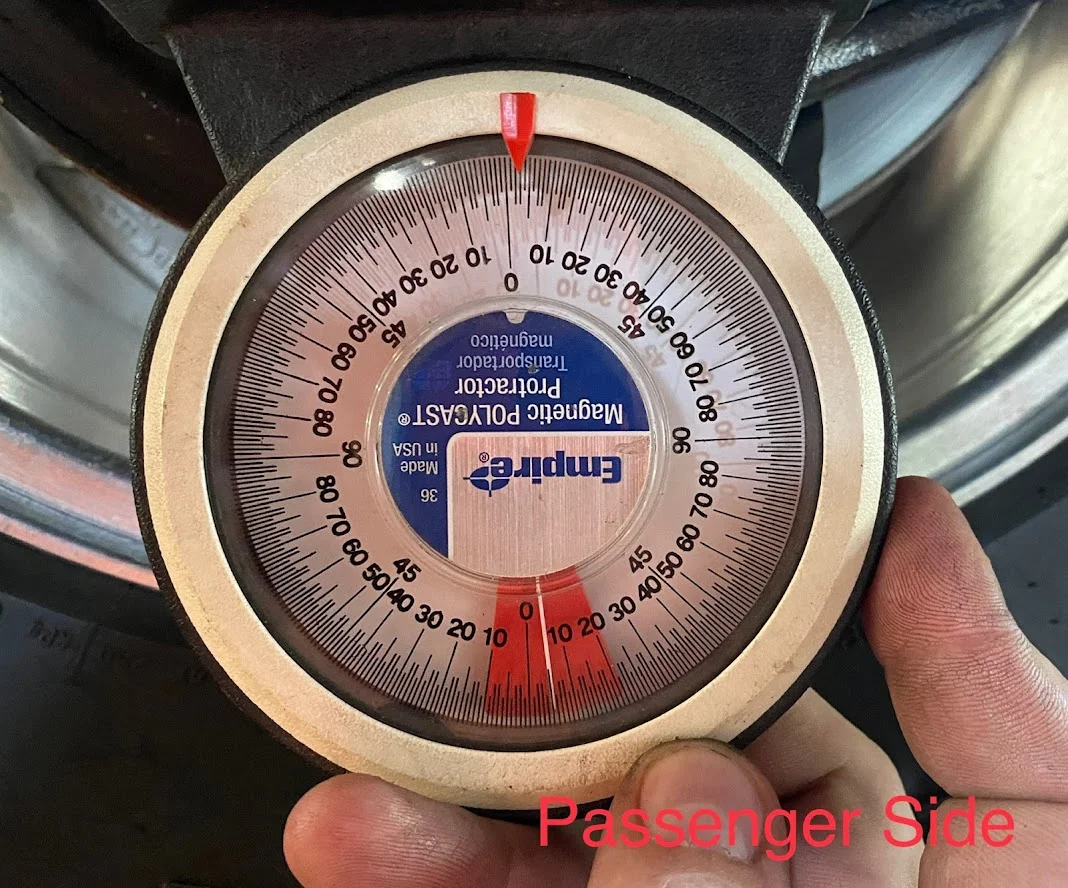

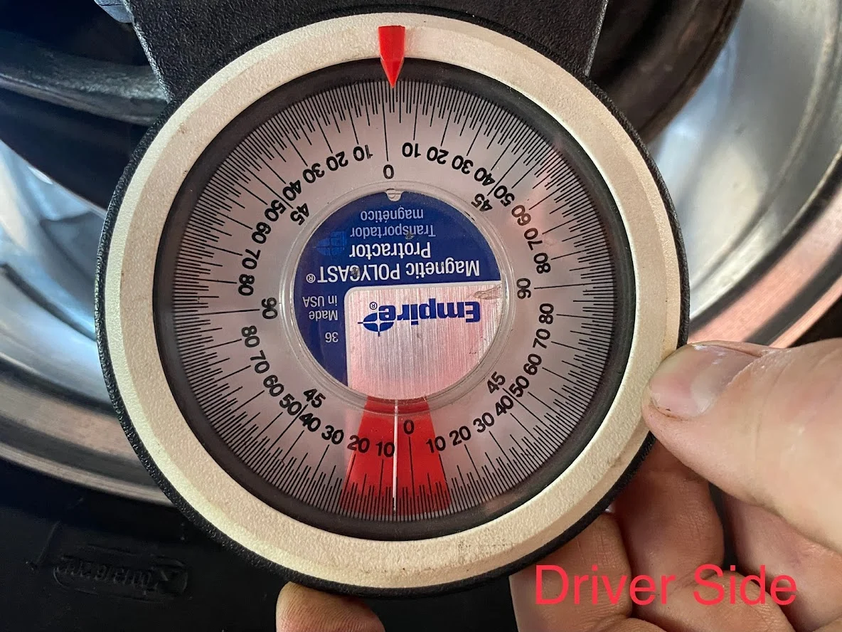

For caster, I checked both sides under the axle "C" and got the following:
To my eyes, it shows what I would expect (~4.5º on the driver side and ~5.5º on the passenger side, which is consistent with what most people target with 35" tires). No major disparity that would suggest a damaged axle housing or twisted tube.
