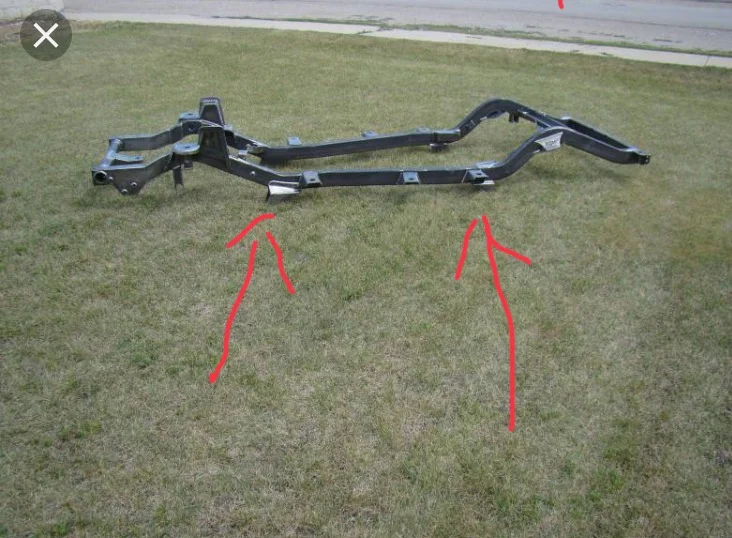

There was definitely some poor design choices made with the frame in terms of drainage for the frame. Makes me wonder if they even attempted to fix it with the JK or JL.
They fixed the issue. My JK has big bottom holes on them and rectangular slots in the sides that I can insert the wand to power wash the inside of the frame.
Would one of you fine folks draw up a schematic of the TJ frame and show where you've drilled drain holes.
Size of hole ?
Thank you !
I drilled four 5/8” holes in my frame. In front of the rear wheels and behind the front wheels at the low point of the frame.
