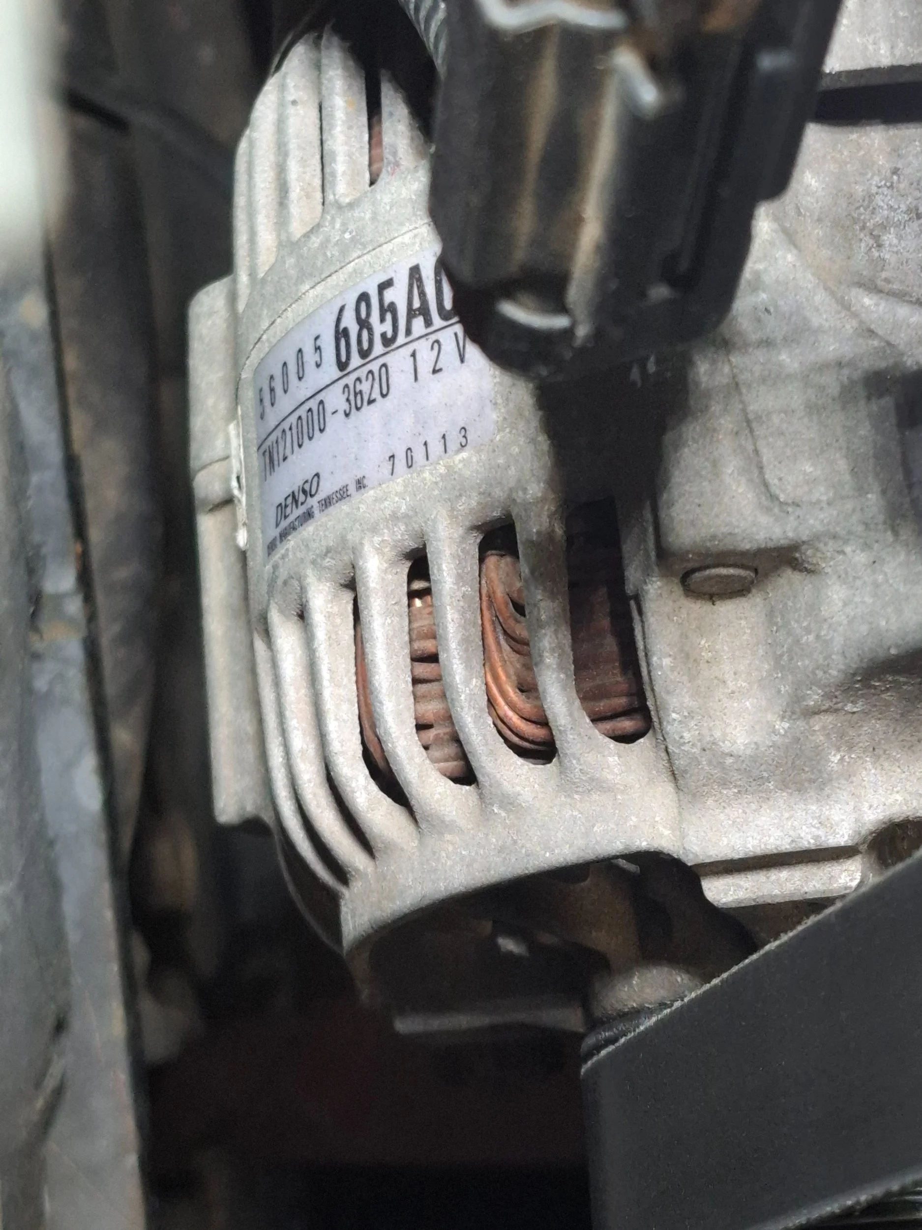

Did my alternator just die?
OK update time - issue seemed to sort itself out as soon as I ordered the replacement alternator but when I fitted the new alternator and took her for a good thrash the check gauges light came on again and voltage output dropped to 12.1V again after about 5 minutes of driving.
So, whatever is wrong, it doesn't seem like its the alternator, something else is causing this issue.
Any ideas?
