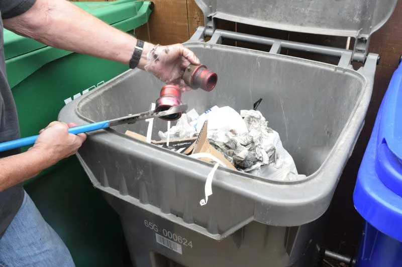

The axle tube seal is a bad idea, don't install one. First, they're not needed as no lubricant is supposed to be present inside the tube. Second, if the inner axle seal started leaking and letting lubricant out of the pumpkin, that seal would prevent you from knowing about it.
My present TJ I purchased used came with them and this is what I did with them when I had my axle shafts out.
