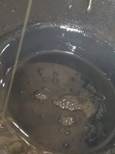

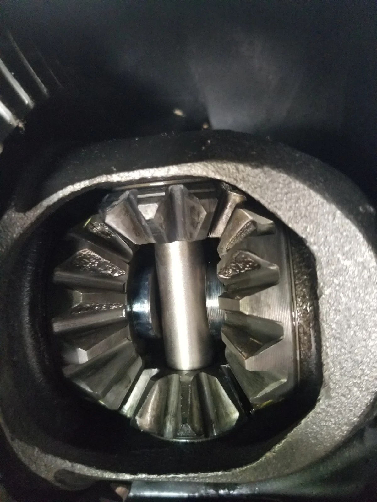

I was getting a "clunking" sound every time I engaged a gear.
My mechanic opened up the rear diff (DANA 35) and this is what it looks like before brake cleaner:

After brake cleaner:
Clunking sound when moving gears
Replace? Overhaul?
Thanks, gang.
You might be able to get away with just replacing the spiders, you might need to replace the bearings, who knows. If I were you I'd replace the spiders and bearings.
Carrier and pinion bearings are recommended, but you will know more once the carrier is removed.
Spider gears are a definite, but again.... you will know more once the carrier is removed.
