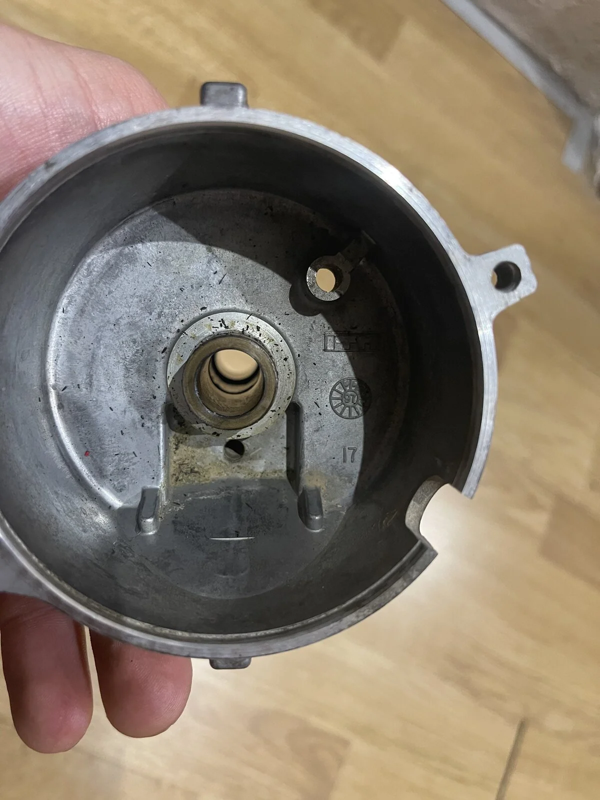

Well yeap, whe I turned it by hand I looked good, I think that the gear pattern was exactly the same, and I called both the place were I bought the cam and they said it’s a normal cam, material and everything.
The things I thought of are maybe lack of lubrication, since I don’t know how those gears gets lubricated…. I thought about cam play as well…. The distributor had about 1or two vertical mm of play, but I don’t know if is enough reason to get destroyed in 150 miles…
Just to be clear, you‘ve turned the distributor shaft by hand and it turns smoothly, yes? And your oil pressure gauge read what pressure after the rebuild?

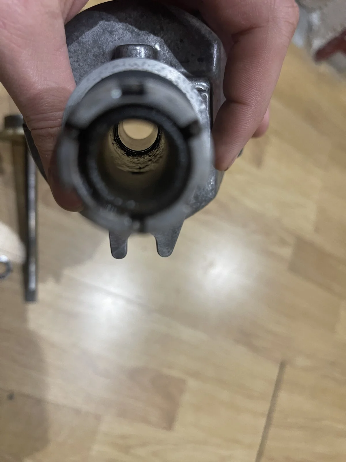

Ohh sorry, yeap oil pressure was great, 2 at idle and over 4 when reving, and the distributor seems ok, it turns ok, I thought it might have broken bearings… or something like that, but I opened it and I doesn’t have bearings, I think only the 05 and 06 opda’s had bearings which went bad and made similar mess on cam and distributor gears…

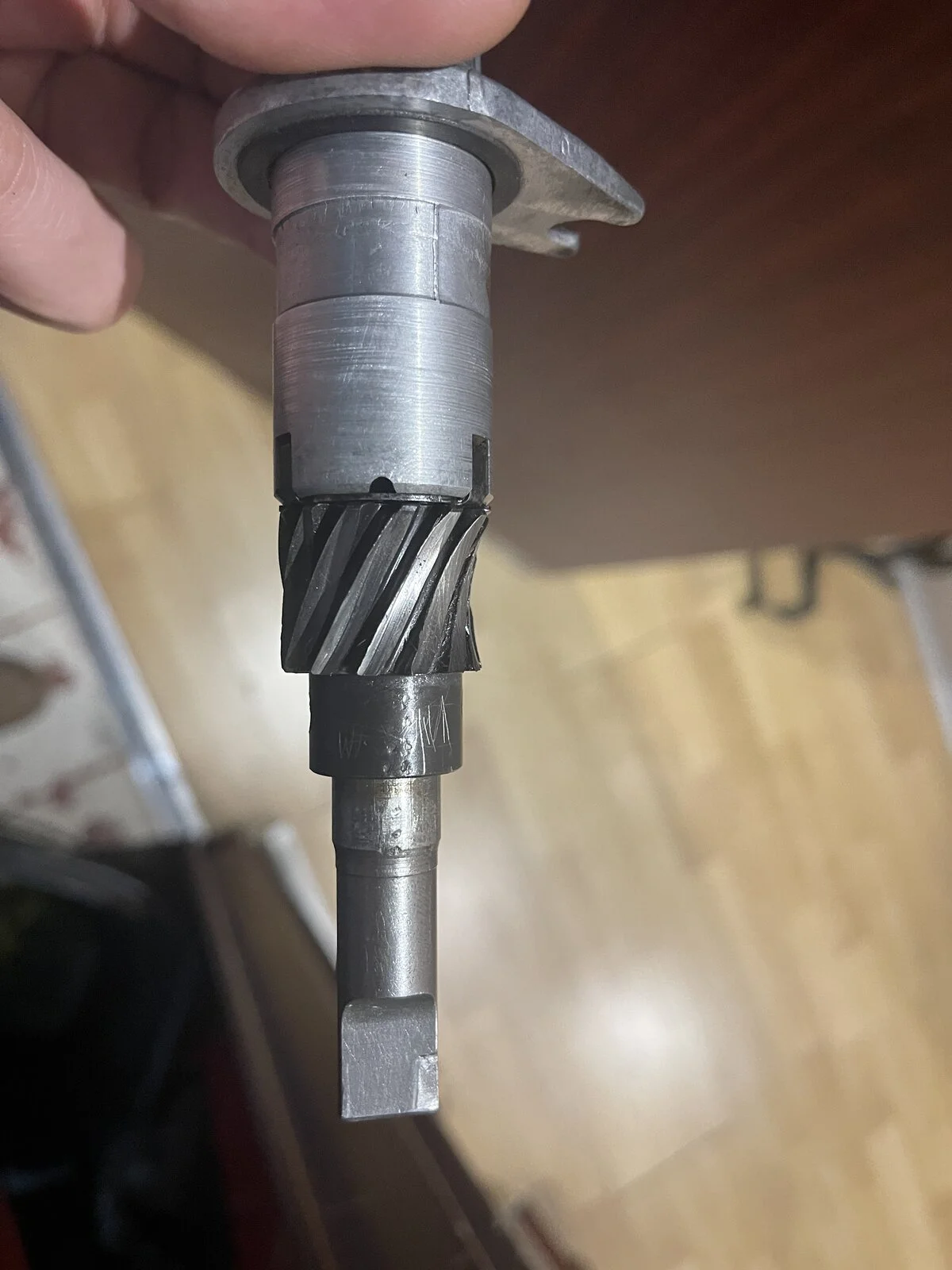

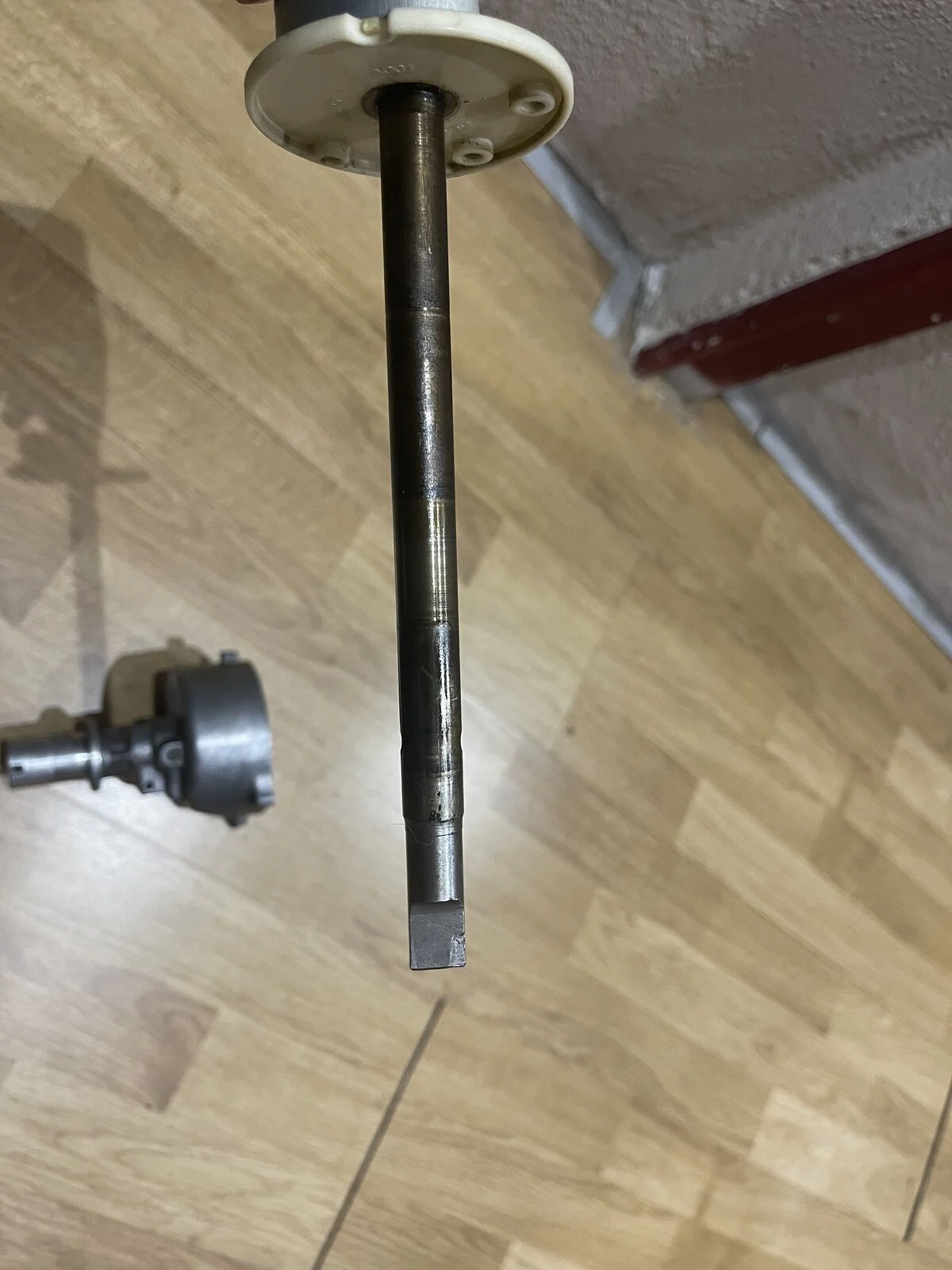

What does the oil pump drive shaft look like?
I don’t think it looks too bad, you tell me… There was like tiny pics of plastic chunk inside of it, but I think it was old oil…
You can see the play it has once mounted, could that be enough to brake it?
Stick a large flat blade screwdriver into the oil pump and see if you can turn the shaft.
Yeah it turns with no problem, I even took the oil pump out and cleaned it sucking diesel and turning it by hand, worked really good… wasn’t hard
Well, I don’t have an answer as to why the gear failed. You know the camshaft & distributor gear need replaced. If you decide to reuse the distributor, at least polish the shaft before reassembly. I’m also not a fan of crown parts. Get a gear from pioneer or someone like that.
