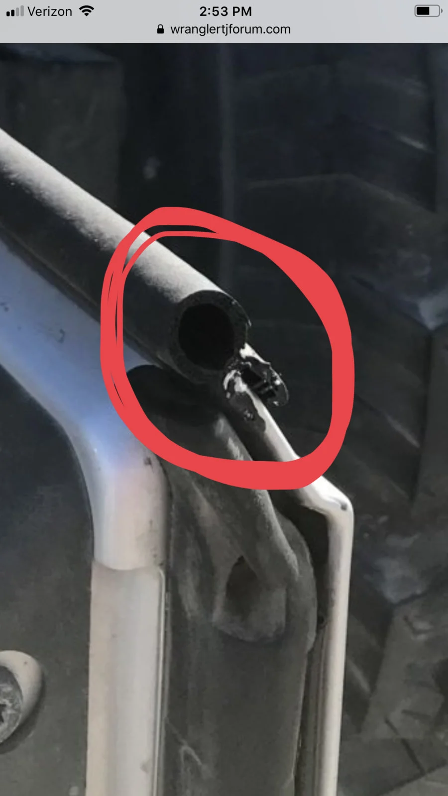

I bought the 5 foot and trimmed to fit
80502
80503
Reactions: anarce and nk24
I dont think the hard top came with the same type retainers if any at all.
this solved my rattle issue.

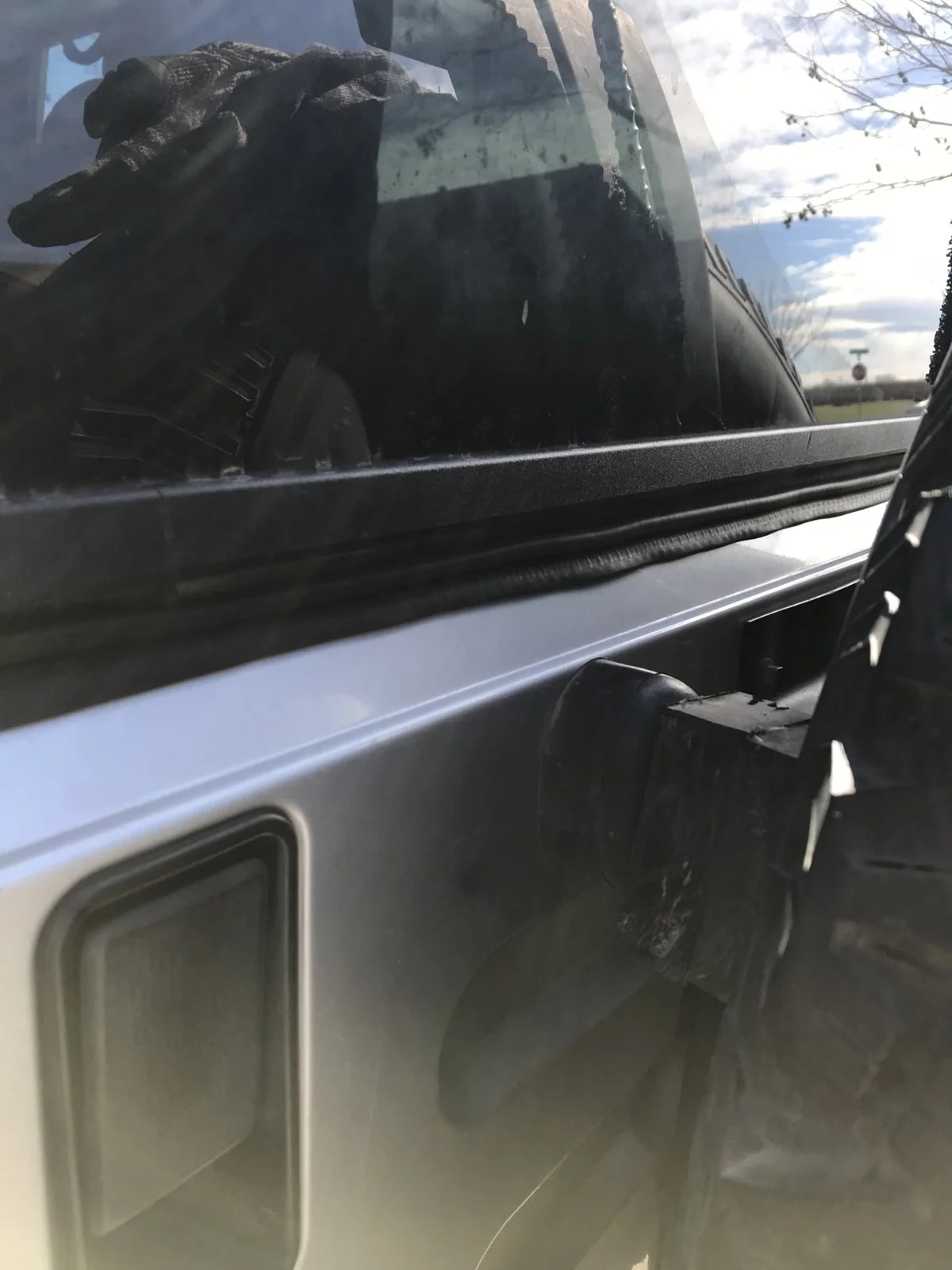

EDITED - already asked/answered while I typed. Thanks a bunch for including pictures - would you say that addressed the problem? I'm thinking it might keep the glass more firmly in place in my situation...

Yes I became so irritated with the rattle I had a dish towel (seen above) to keep it quiet. This slides on the tailgate, shut your glass and the tailgate makes a much better contact
This worked very well by the way, thanks. It put a tiiiiny but of pressure on the tailgate latch initially and I could hear it sounded a little different when opening but it seems to have since broken in.
I had already removed the soft top clips but this really mitigated leftover rattling/shaking. I'm pleased for $9.99

That's a little unusual... Put on the same added trim piece and it made mine very very snug.
Your side gaskets around the glass may be collapsed.
also the strike plate on the tailgate is adjustable where you can make it close further.
Realistically that glass shouldn't move it all with the tailgate shut.

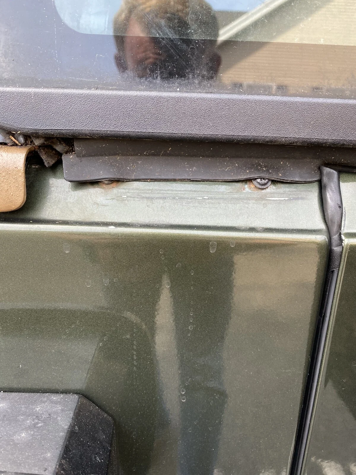

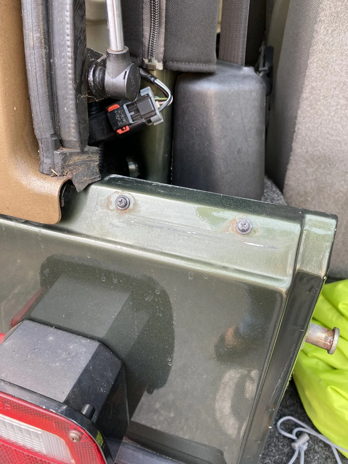

Hi Jerry,
I just purchased a hardtop, and took the rear retainer clips off that came with my soft top, because they look like they would interfere with the glass window closing fully. I wanted to be sure, are there clips that I can buy that screw into the same location that help the glass stay secured? Right now it looks like i'm missing something.
Hi Jerry,
What you have is it, nothing missing.
