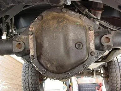

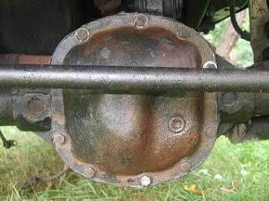

If it is tilted the pink trick wont work. you will need to tap a new hole. BUT if it is tilted hope you have the right drive shaft because the yoke on the axle housing side will sometimes get damaged if tooooooo tilted.
