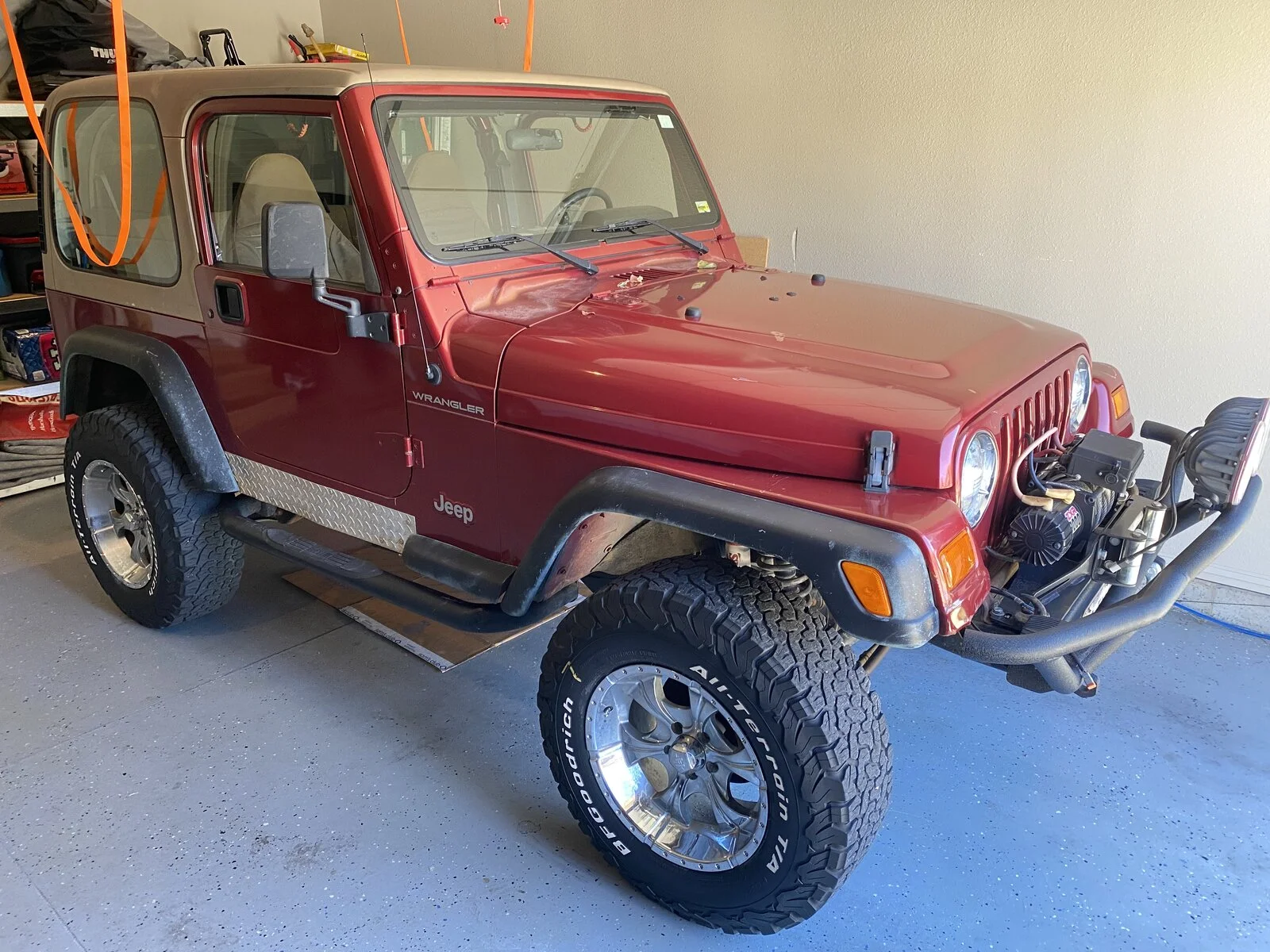

I just got a somewhat maintenance neglected 99 2.5L that I have virtually no history on and I’ve been trying to get her healthy.
It has a pretty good vibration. I’ve replaced the timing chain/gears/tensioner/damper/crank seal.
Exhaust seems good.
The vibration is still pretty intense. I’m looking at motor mounts next. The Jeep does have a lift—not sure how to measure how big a lift it is.
How does a lift determine what mounts I choose and is there anything different that must be done when installing mounts to a lifted Jeep?

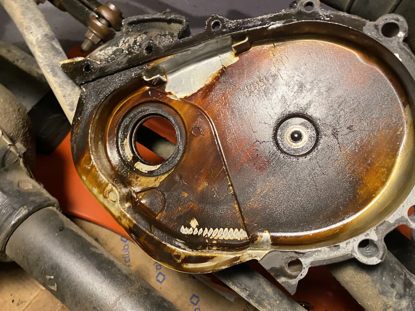

I thought it was the timing belt guides. When I opened the timing front cover, I found a trashed tensioner and NO damper here’s the pics:

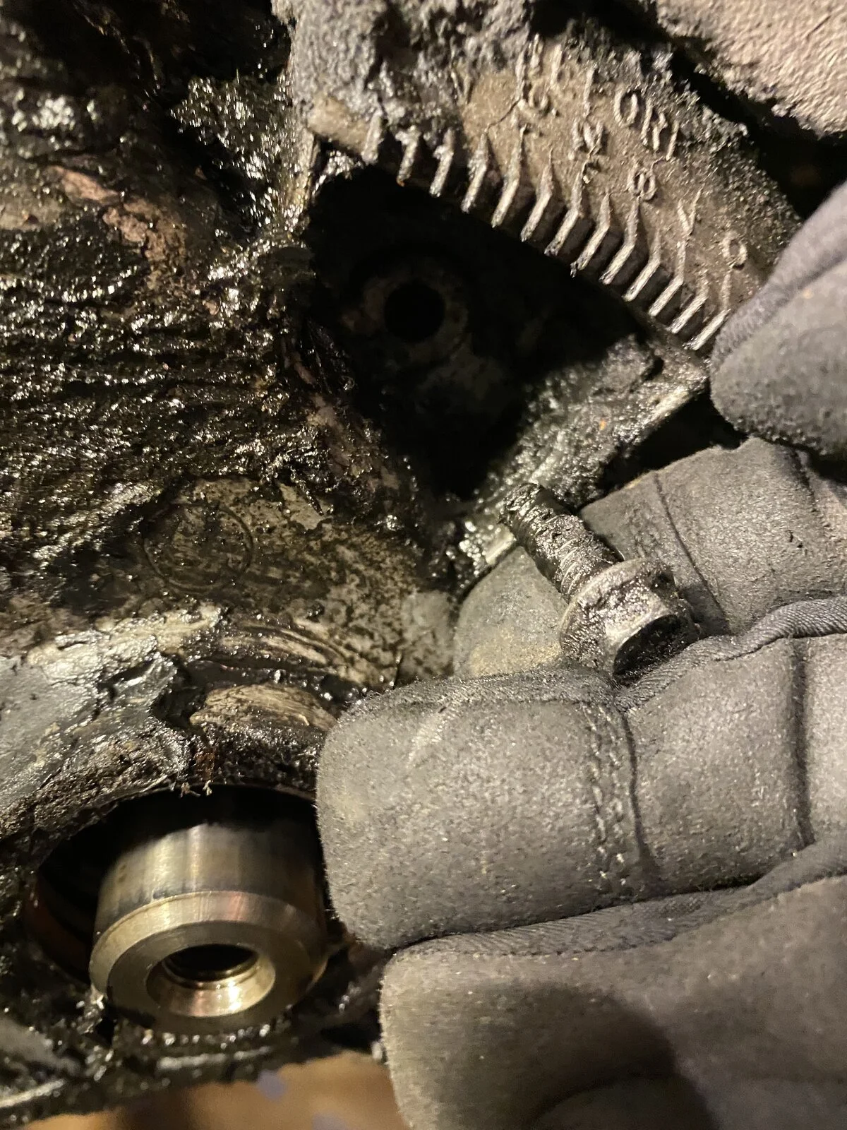

There was also a fastener that had come out and was just sitting in the caked up grease in front of an empty hole where it should have been.
Here is the pic:
