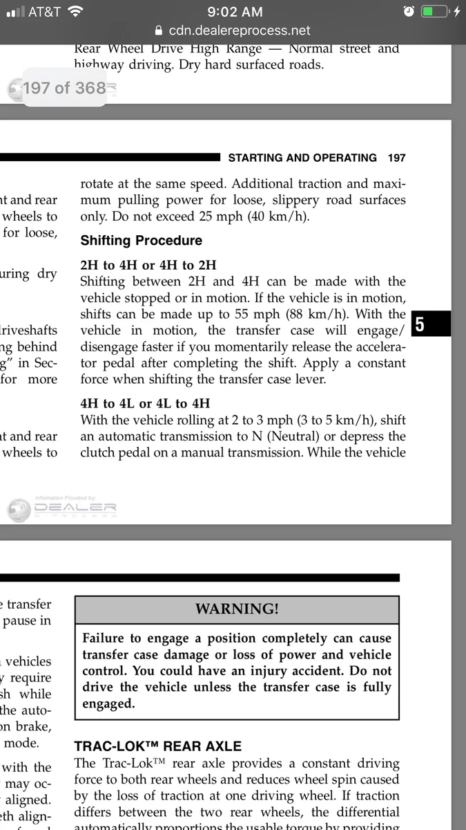

Ive havent used 4H yet. This is what the manual says. Any tips though?
Why would i need these? This doesnt seem like a needed item for my trip
Weight is weight. If it's good, these will help. If it's bad, they won't help.
I
idk why but it seems so sketch to do it while moving😬
Shifting on the fly is only bad when the rear tires are spinning faster than the front tires. Let off the gas, shift into 4WD and hit the gas again. No problems. I think the max 55mph is "save my ass" lawyer talk.
Which is perfect cuz I was thinking max 45 in my head to save my own ass😂
