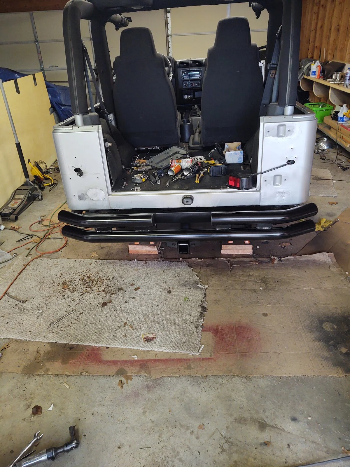

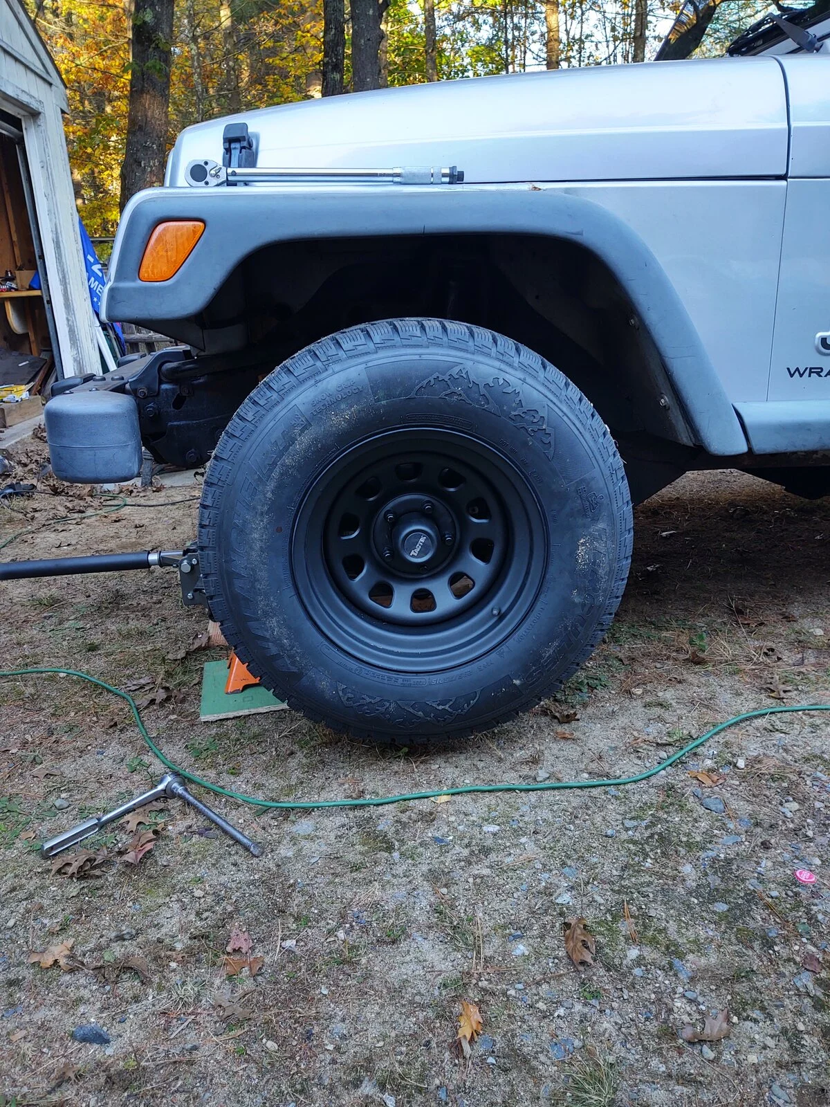

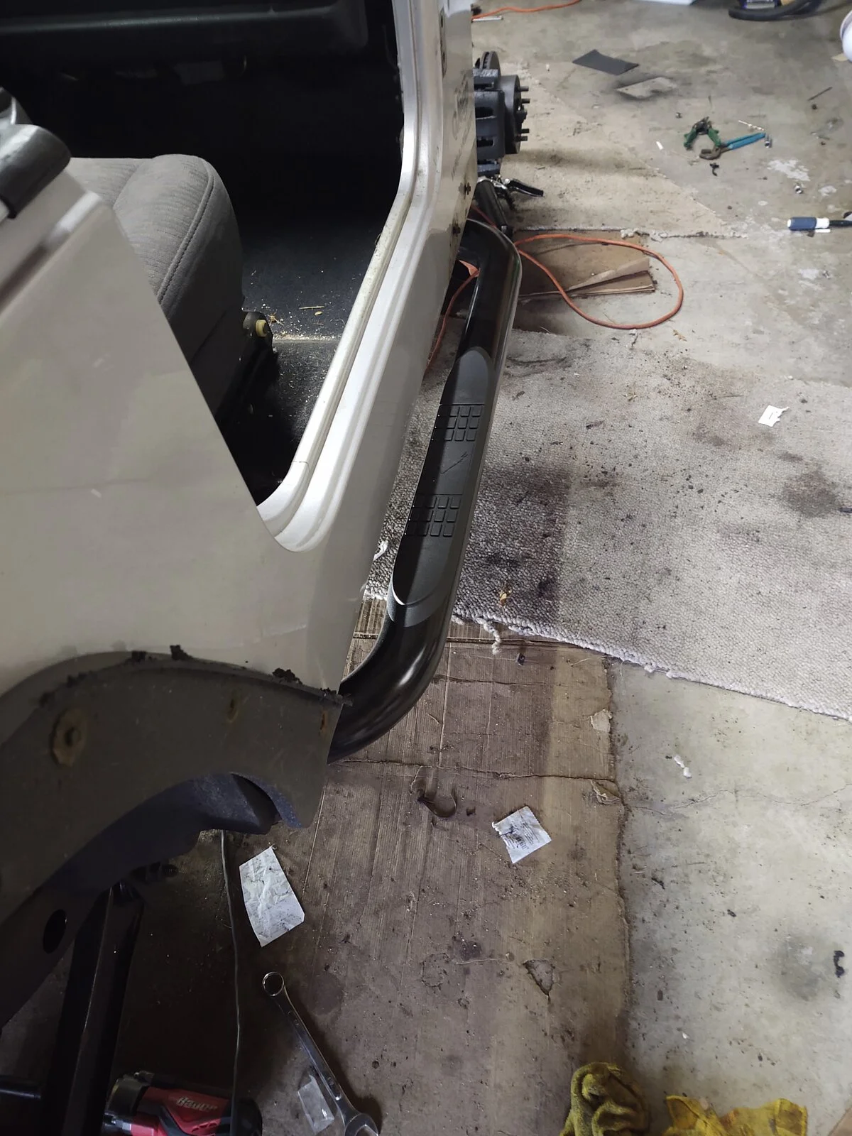

Plus I'm doing some updating to my 2004 Jeep, tires, fenders, front and rear bumpers.

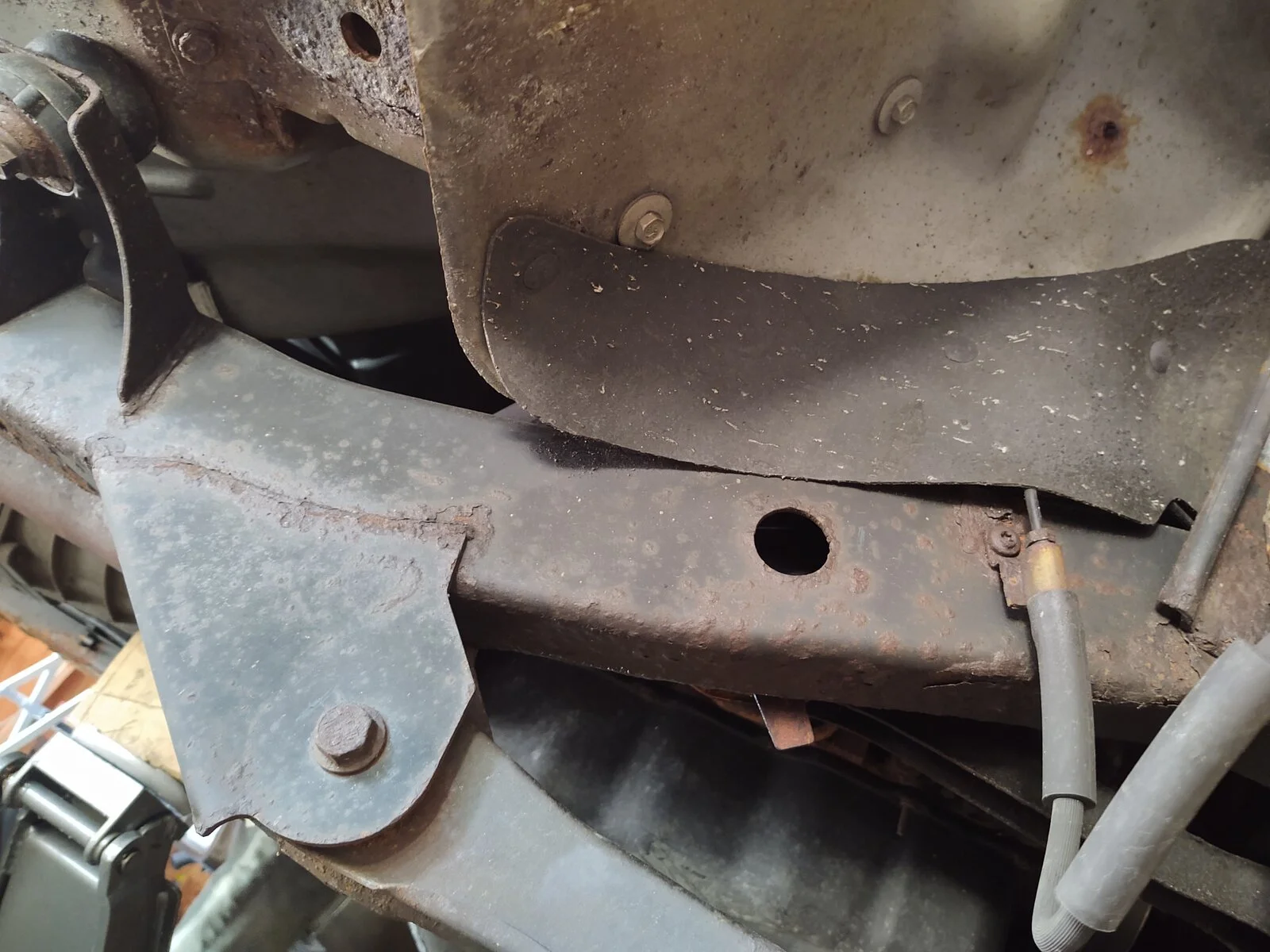

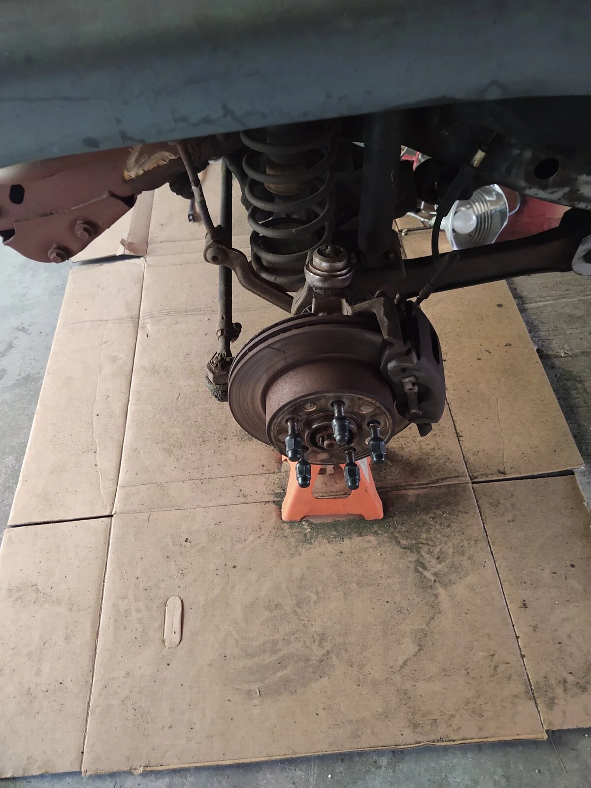

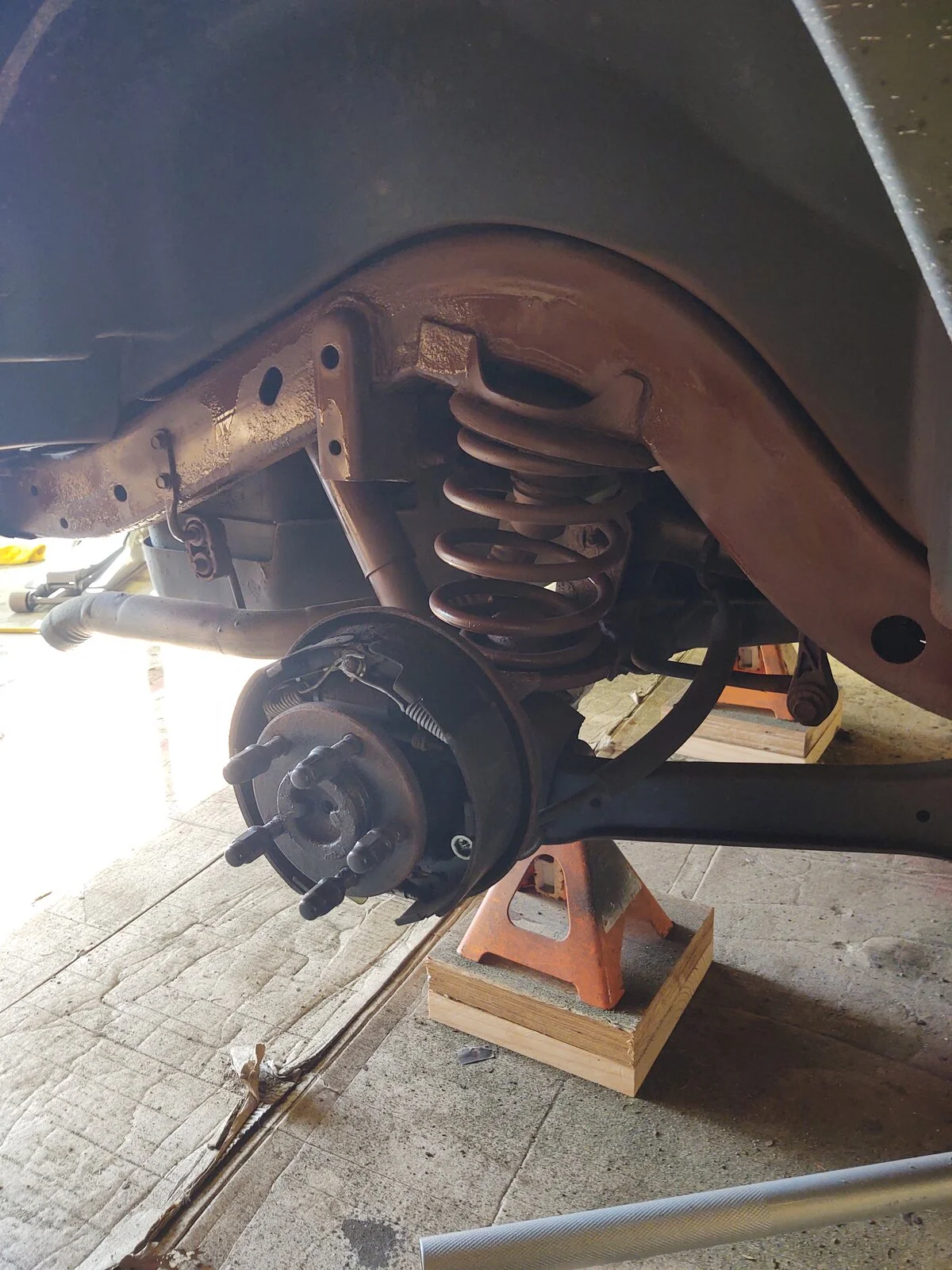

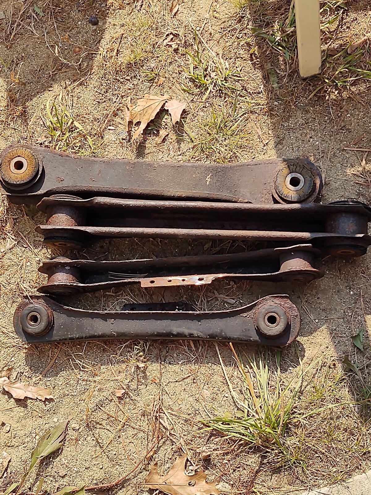

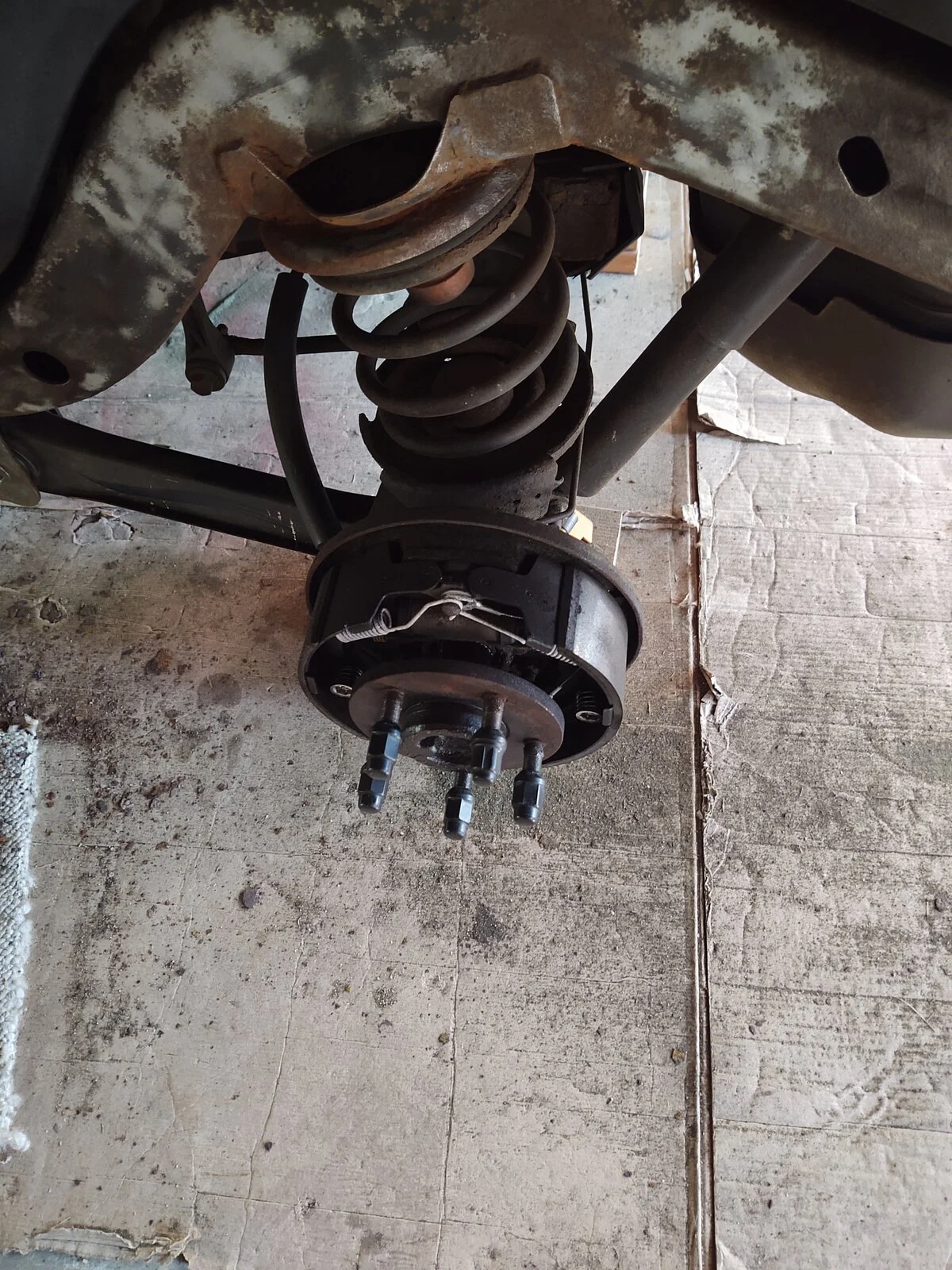

Day one changed out the rear control arms, the old bushings were dry rotted. I checked everything under the Jeep I decided to order the front control arms, figured it wouldn't hurt. The tie rods, ball joints are all good.

I'm waiting for my front control arms, and bushings to arrive. that is the next step.

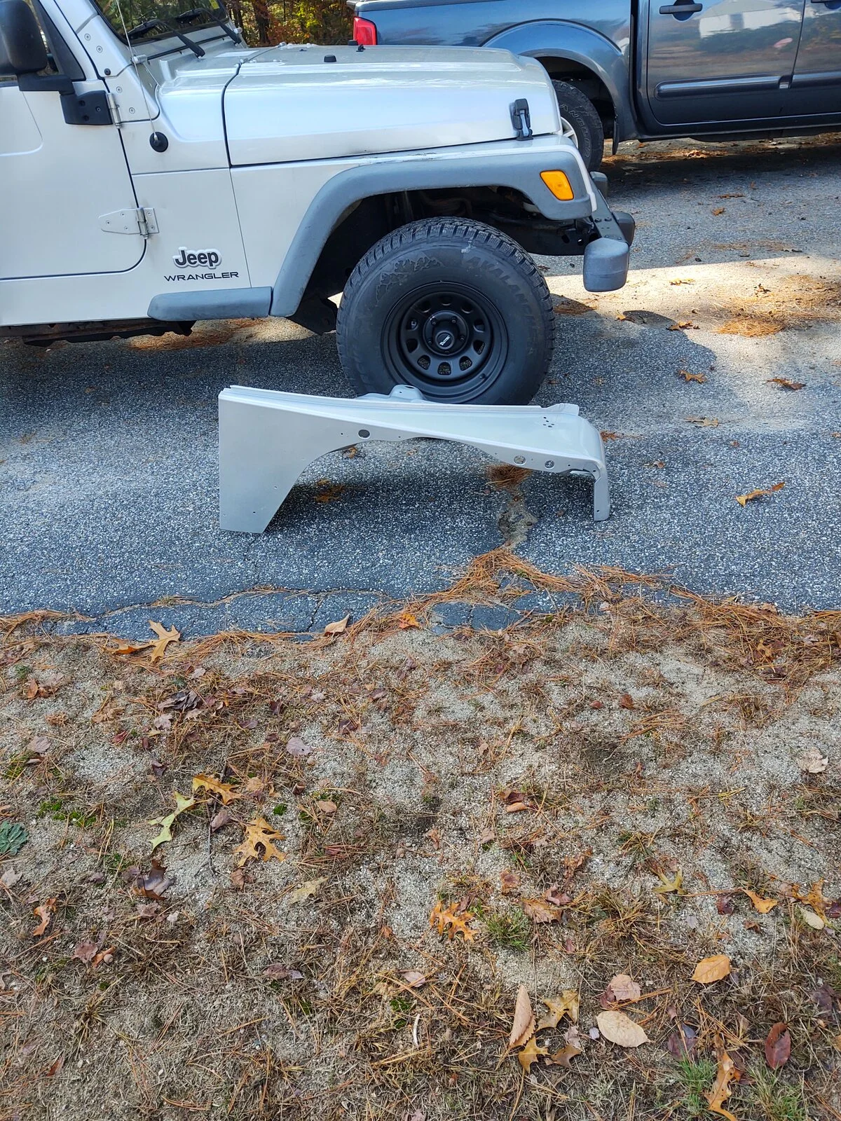

Any warpage to the fender from the heat process of powder coating?
Nope, when I ordered a pair of fenders they sent three. So first I tried to send one back, they didn't care so I wasn't going to beg. When I got the two powder coated fenders back I compared the before and after.
The before fender was flexible, the powder coated ones were very stiff. He had put on multiple coats, so it should last longer than the rest of the Jeep.

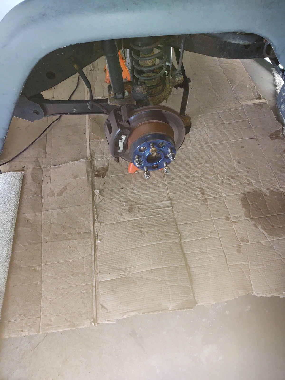

I just got my new front control arms and bushings so hopefully I'll get them on this weekend.

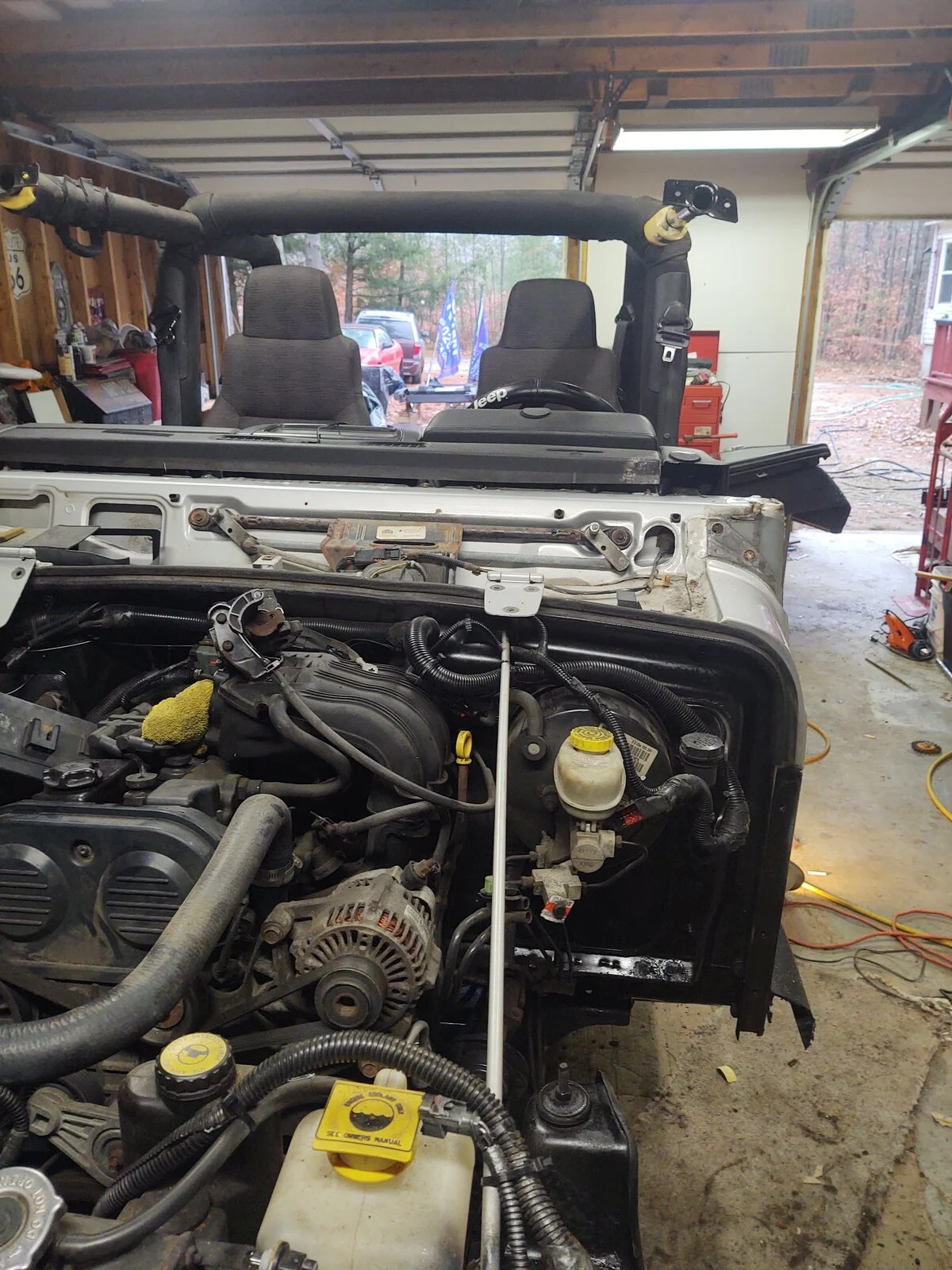

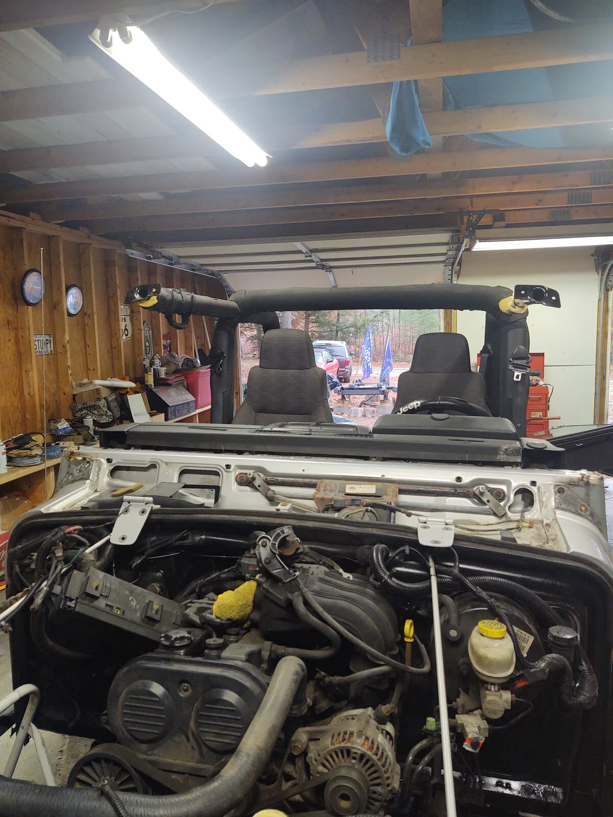

Both fenders are off, went to put the upper and lower front control arms on, they sent me two left control arms.

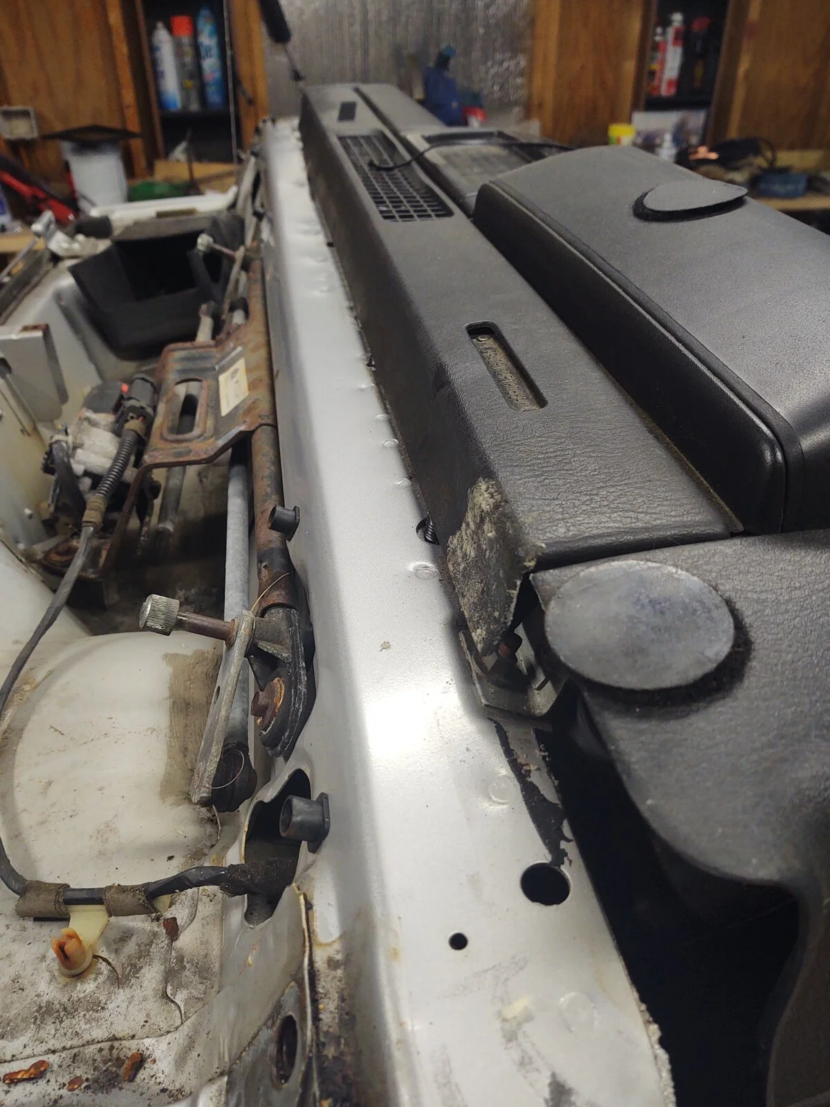

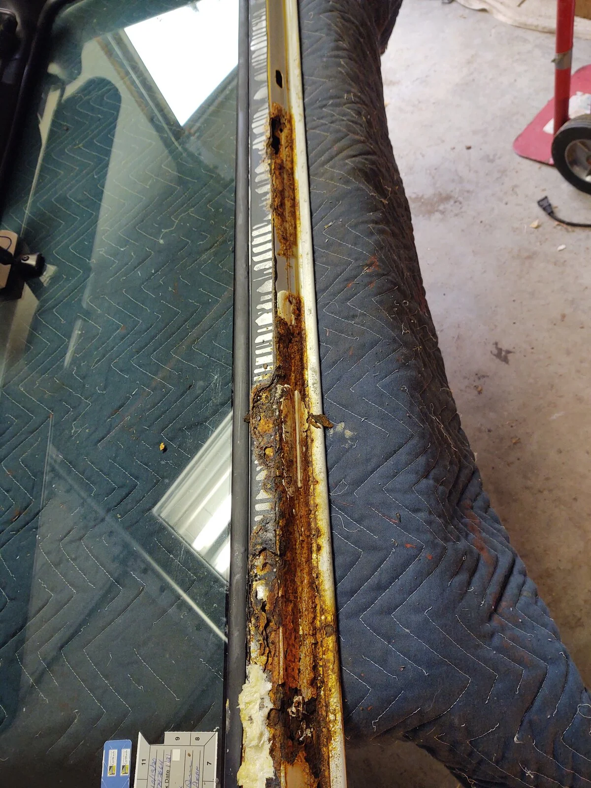

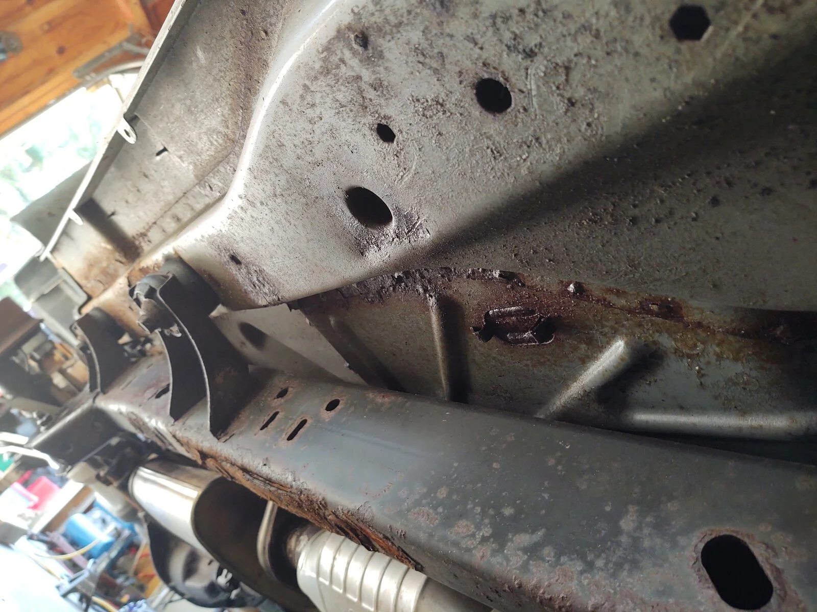

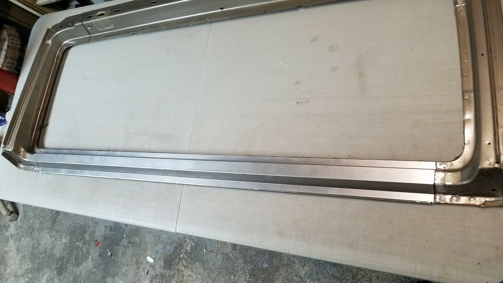

I knew the bottom of the windshield frame was rusted just didn't know how bad. I bought a repair panel, now I'm going to cut out the bad parts. The rust didn't spread to other areas, thankfully. When/if this Jeep is ever put back together, I never want to deal with another torx screw again

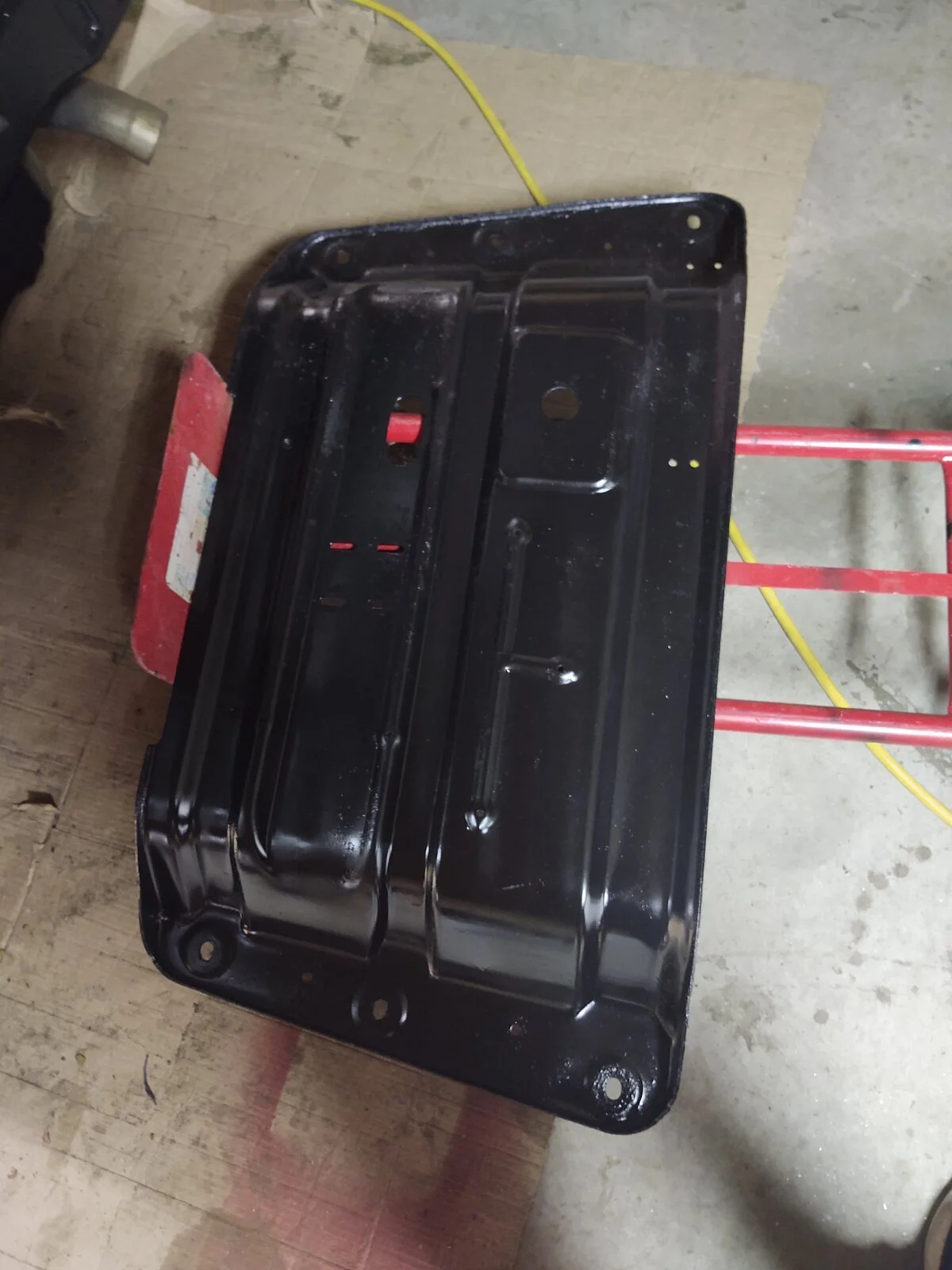

I bought the 20lb sandblaster from harbor freight. We couldn't figure out why it wasn't working then after watching a few YouTube videos it worked great.
Not enough CFM's so we put two compressors together with a tee. Plus the fittings are to far in cutting off the flow, so put more tape on the threads, and backed it off.
Fifty pound bags of black blasting abrasive from Tractor Supply for $9.99 a bag. We also took all of the brackets off the fenders, blasted them then primed and painted.
