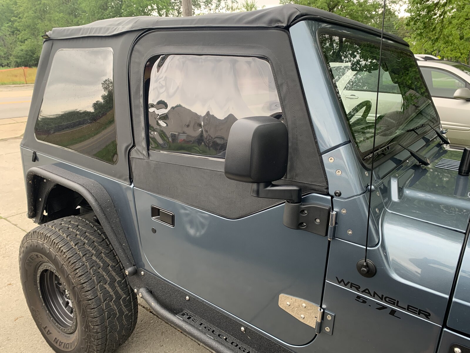

I have the polished stainless Kentrol hinges on my ‘97 TJ. I got polished as to not need to worry about flaking powder coating that will eventually happen in Ohio, with seasonal use. I got the ‘03-‘06 set as the top hinge is the thicker hinge with countersunk screws like factory. Much more robust than the button head cap screw version (all Kentrol sets use those on the bottom)…
They have been rock solid for me…
I installed delrin bushings at the windshield and body hinge pin mounting locations. I also use ‘03-‘06 style mirrors as well, FYI…
