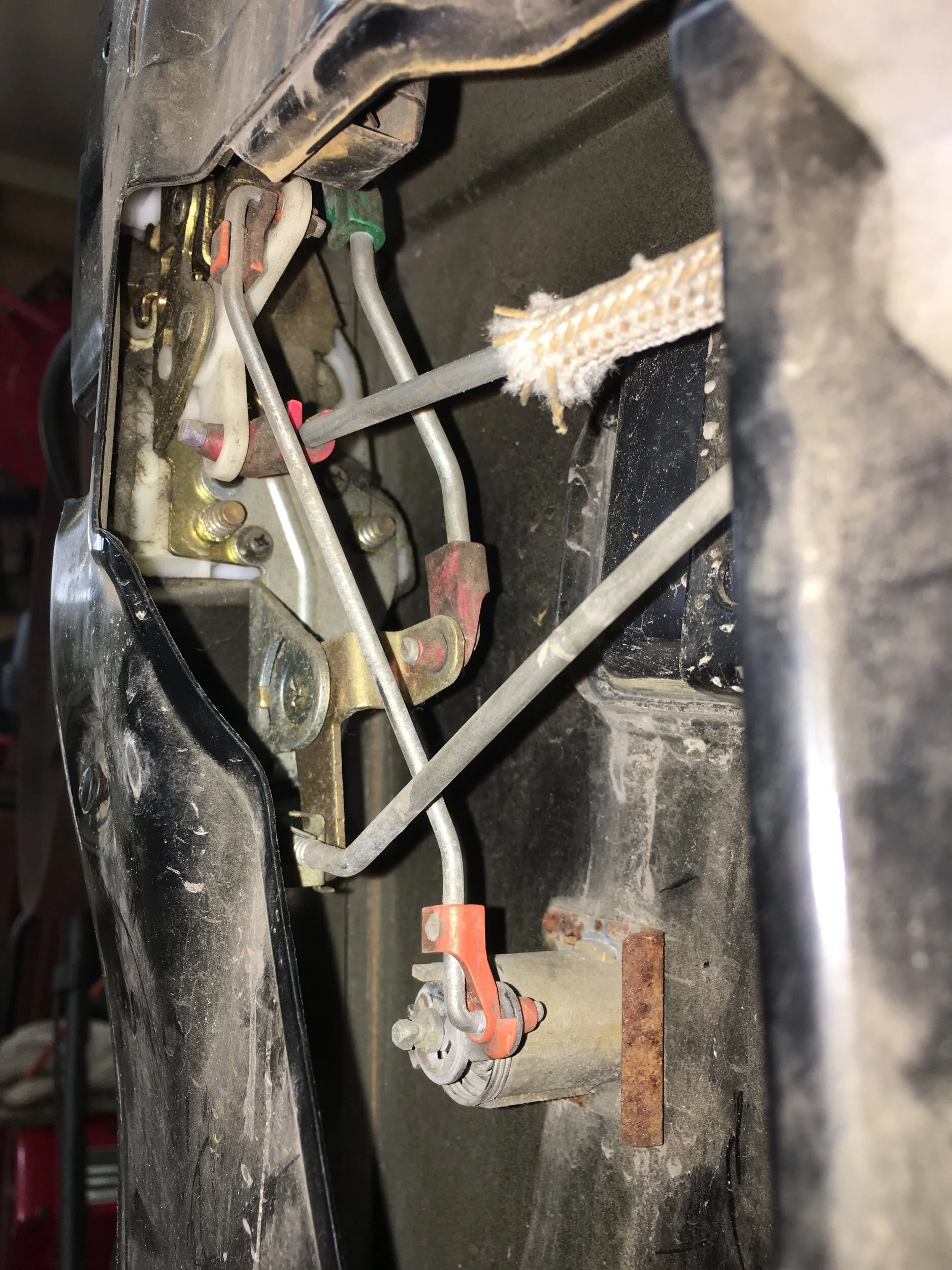

The clip that connects the two ends of the lock rod, from the inside handle to the lock mechanism likely broke..
Pretty sure it's the top rod in this picture with the red clip.. it's the clip at one end or the other..

Sweet, BUT... if the clip is broken (or gone), wouldn't that also prevent the door from being locked using the inside button/lever?
Reactions: MikekiM
The outside lock and the inside are 2 different rods so they function completely separate till they connect on the same plastic lever on the latch side. I would guess the arm has popped out on one of the sides. That’s done if the plastic at the bends has broken since they hold the rods in place.

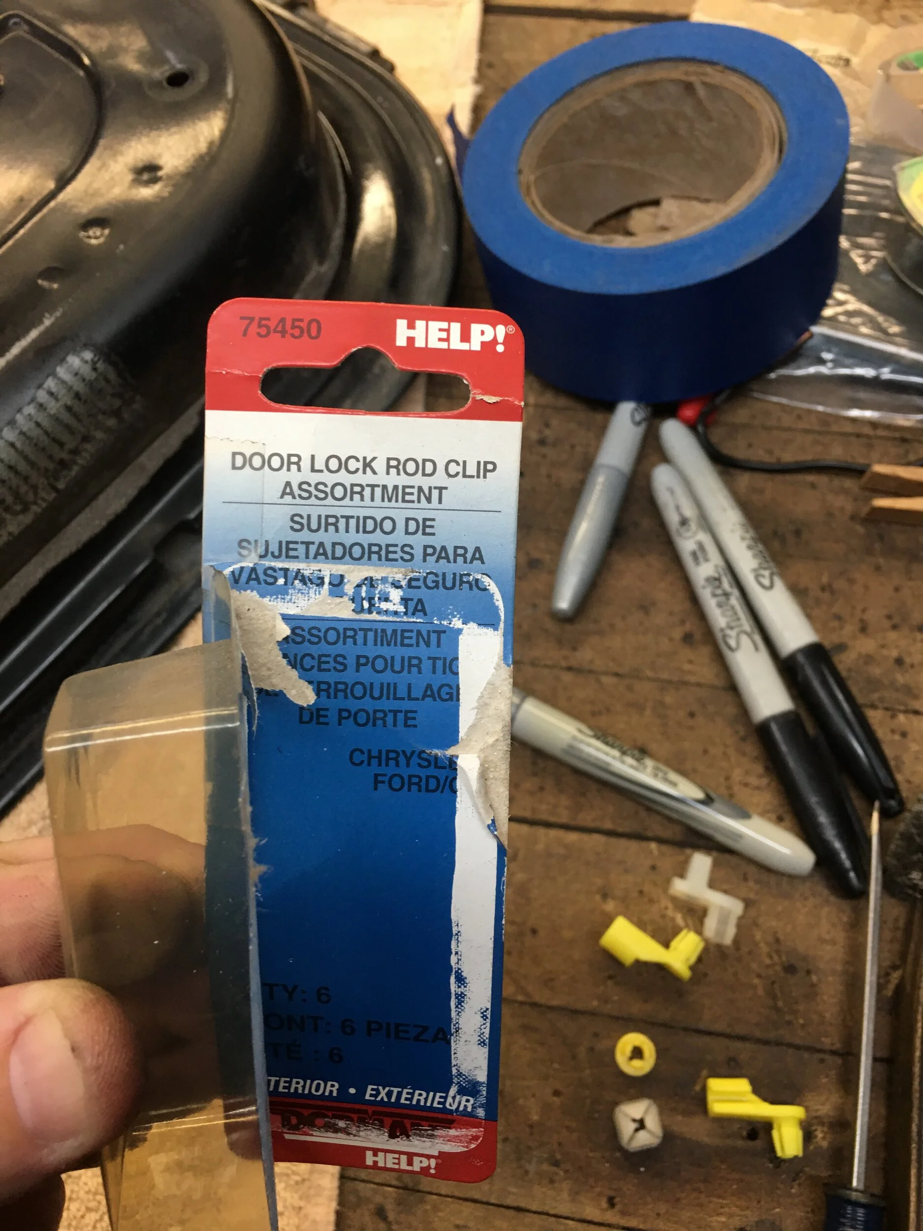

I didn't have clips but was easily able to cable tie my rods into place. I now have an unopened package of clips, too...works well enough I don't see a point in taking the door apart again.

Turns out that nothing was detached, broken, or missing.
Not sure how, but the "unlock rod" for the inside lever must have been bound up at some point and the repeated (and progressively stronger) activation appears to have caused the rod to bend slightly, making it too short of a throw when the unlock toggle is toggled.
I straightened out the affected rod a bit (making it slightly longer) by pushing down on it and then sprayed some WD-40 on the rotating/moving parts.
Then it worked as expected.
