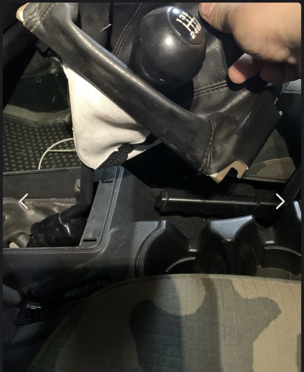

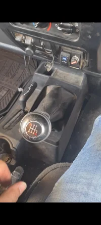

I took this pic from another post here where they said it wouldn't hit 2,4,6 or R.

I have the B&M, and yes, it was tight. I put a BL and MML and you couldn't shift to 2,4,6 and R. I was also putting on the Savvy Under Armor, and when that went on, the shifter is just fine. B&M only sells the JK NSG370 version, which doesn't have the dogleg, as you stated. On the JK it's not an issue, 05/06 TJ it is an issue. You can absolutely mod your console, but some wouldn't want to. Or you can get the Under Armor skid that lifts the Transmission, and it fits well again.

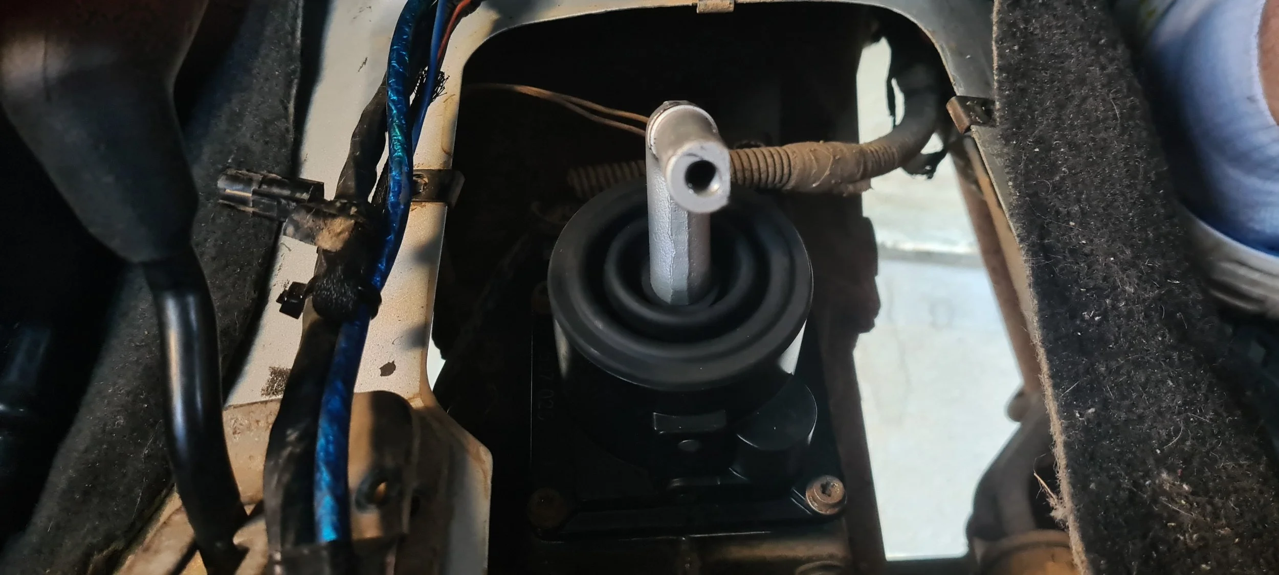

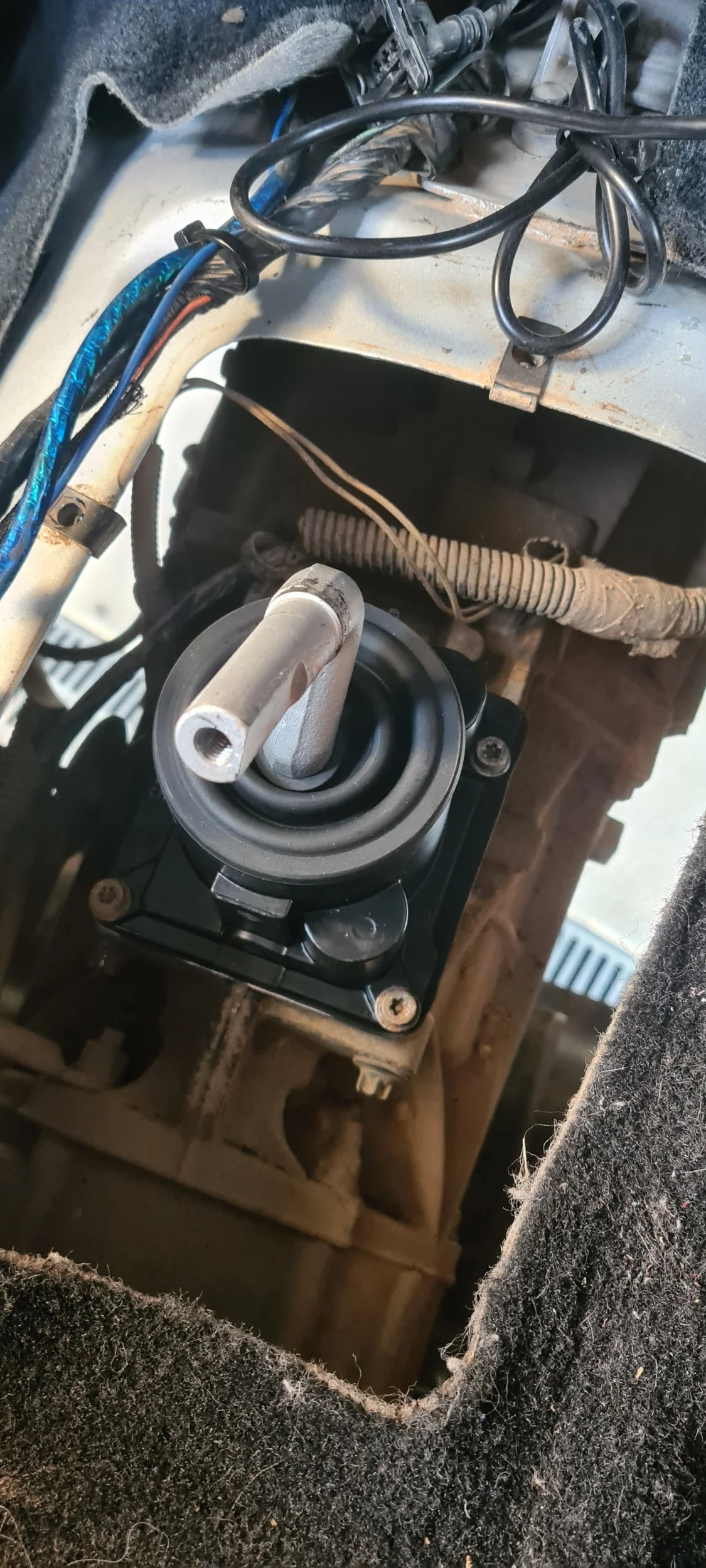

I purchased one of the Dorman 697-025 Towers off Amazon- installed it earlier in the week and very happy with it.
I was having the dreded 1st gear popping out issue with my gear box, along with the occasional horrible grinding noise if not fast enough to grab the shifter after it pops out.
Was having issues with it on hand break starts, rolling along in stop start traffic, winching when bogged in 1st gear (would have to hold it in while slowly working on the winch and trying to get over / out of whatever car stuck in/on, and also rock crawling down hill / uphill in 1st low range). Basically always had to hold it in gear.
Last two days it's been like driving a brand new car. First hasn't popped out once, done some hand break starts, done a fair bit of driving and took it off road on Saturday- no dramas.
It also feels a hell of a lot better shifting- gear changes are a bit closer together (less movement of the stick), much firmer. Reverse also has a much better feedback on it - it dosnt just move over and down like it used to - have to pull it though to the right with a bit of resistance, then down into reverse gear. (Much harder to get 6th and reverse mixed up).

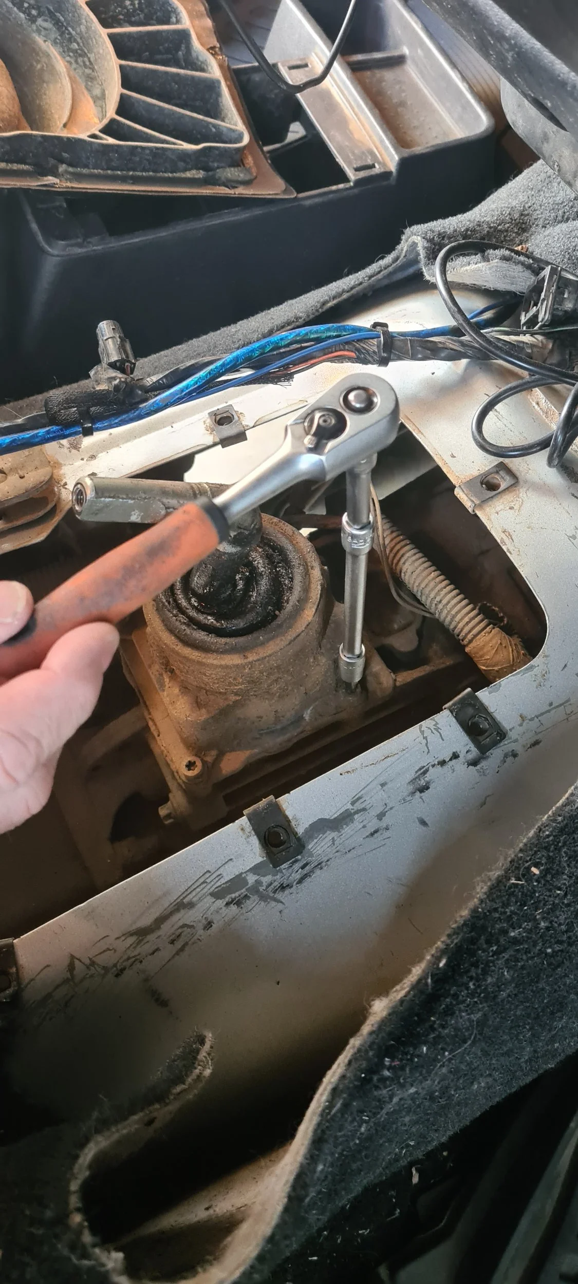

Install was easy - just take out the front half of the console and the cabin gearbox gasket (good time to change this as well).
Can also confirm no issues with the gear stick hitting the console - the dog leg in this model looks like it fixes that problem for the 95 / 05 tjs.

One thing I forgot to mention- if you get one of these throw some gear box oil into it to coat all the inner workings before you bolt it down.
I didnt coat mine when i installed it - it was a bit stiff, especially getting into reverse, until the gear box had thrown oil up into it. After the first 5 minutes driving it was much better.
