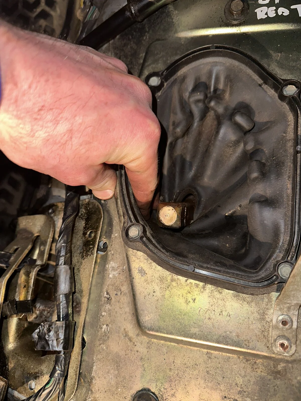

Now I needed to replace the shift plate because it had a blown out 2005 one. So I opted to get a 2004 shift plate (plate with rubber boot that bolts to the trans tunnel) because they had NV3550s in them as well. The new shift plate came in and lined up with all the old bolt holes (except for literally 1)
My issue now, is my Shifter is too big to go into second gear with the shift plate installed. And even if I take the shifter handle off the shift tower, you can see by the pics shown that the actual shift tower lever is soooo dang close to the edge as well. It’ has the bend in it. So I don’t think getting a different shifter handle (advance adapters has a few different ones) will solve the problem either as it’s just too close to the edge.…other pictures I’ve seen show the 2004 NV3550 shift tower lever as straight up and down instead of curved. Yet I see 2000-2004 shift towers for the 3550 being sold all have the curve or bend???
This is throwing me for an absolute loop. There is no way my transmission isn’t positioned right as EVERYTHING else lines up and it drives fine with the shift plate out. I just don’t believe this style shift tower goes with the 2004 Shift plate but don’t know what other shift plate I could get.

As you can see it is right at the edge in second gear.
This is the tower that is currently in my transmission.
