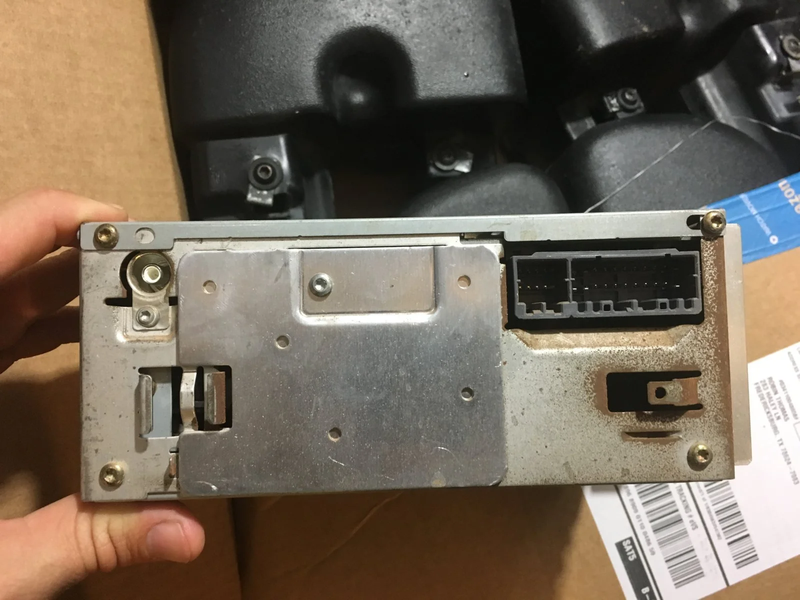

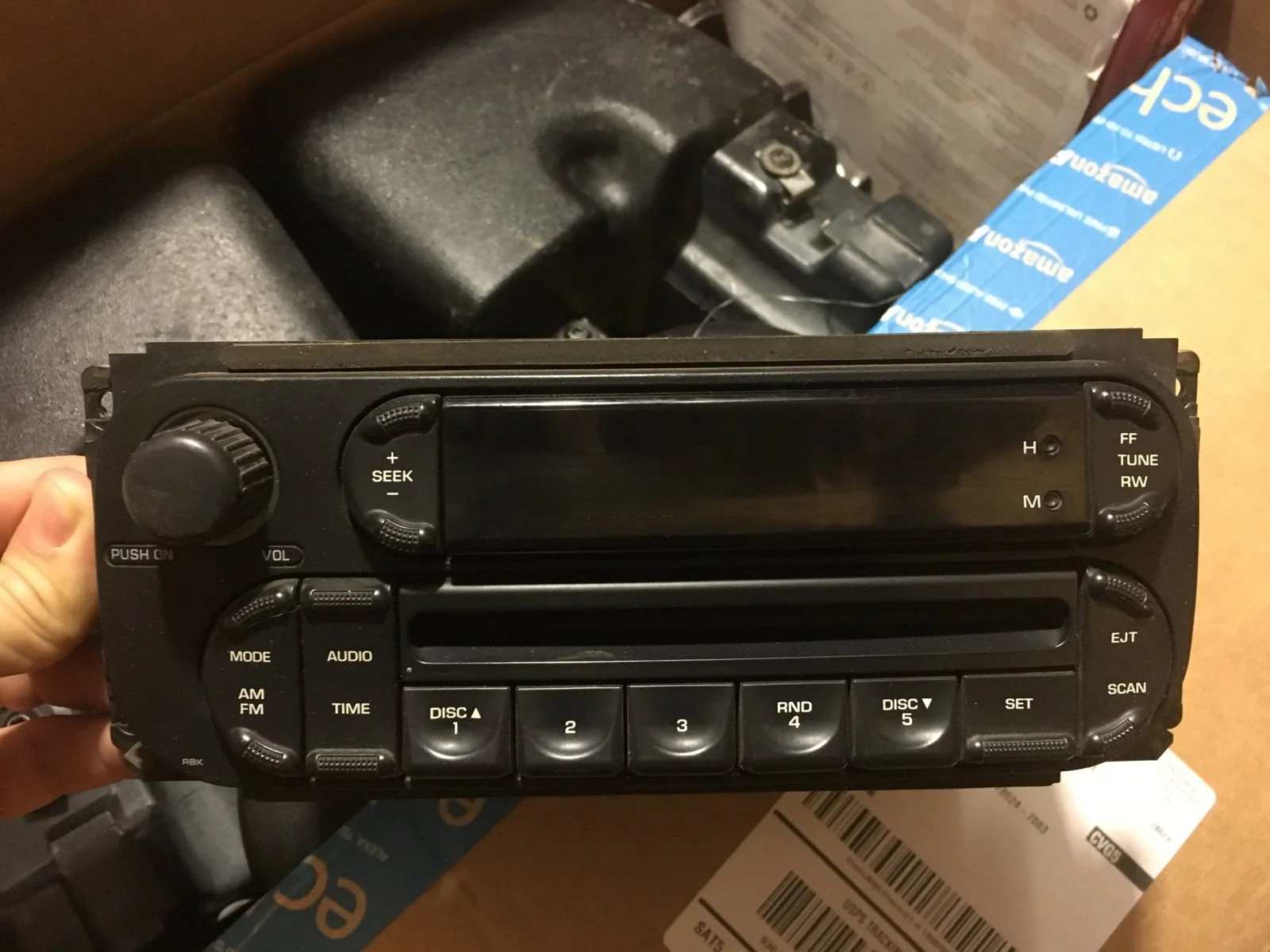

View attachment 13884 If your content with the stock, I could sell you mine for $25+s/h. It works fine. Just uninstalled from my 2005 TJ X in January. The pic of the back shows the harness connection in upper right and the antenna in upper left. If they're the same and you want it let me know.

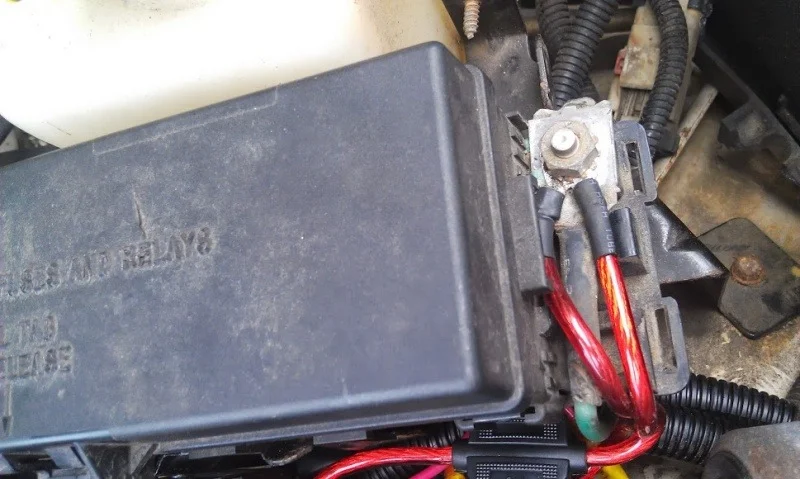

Crimp a solderless terminal onto that power wire. Then at the rear-most end of the Power Distribution Center closest to the battery, there is a lug with a nut on it that you can attach it to. It's under a small protective cover that just unsnaps off & lifts up.How would you go about hooking it directly to the battery?
That power wire from the Sony radio has a big fuse on it already.If you do it this way, make SURE you fuse that wire!

Yeah, I saw it. Wanted to make sure that anyone else reading the thread that doesn't have the Sony remembers that power wires need fuses. Usually installation kits come that way, but if you're like me, you make your own harnesses and need to add your own fuse.That power wire from the Sony radio has a big fuse on it already.
