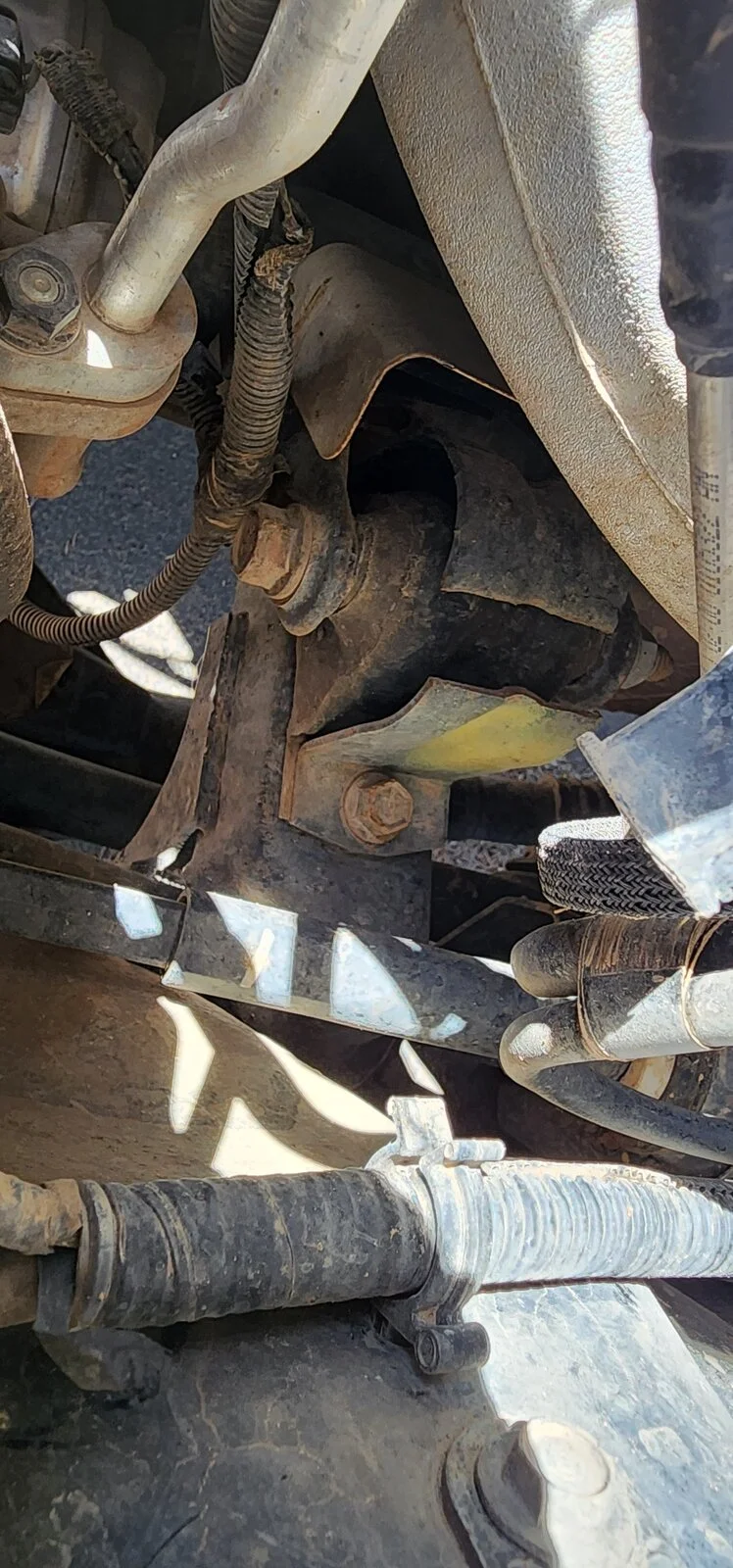

To get the big bolt out, you don't have to remove the engine bracket. Just loosen the 3 bolts in the engine bracket, and the bracket will shift enough to slide the big bolt out past the A/C compressor. Torque the 3 bolts back down (or replace them one at a time and torque them down).
Bless your soul, sir.
After researching tricks for the mount on the driver side, this post was one of the most valuable (along with do one side at a time). Made the job simple. Thank you.
