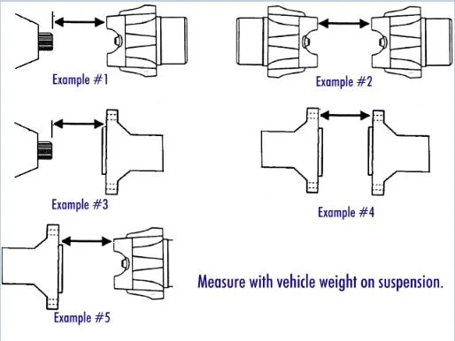

Your measurement is what it is providing you are measuring it properly. Which would be from the center-point of the yoke where the center of the u-joint bearing cap would be, to its corresponding point at the other end. Like the #2 example below. This drawing courtesy of Tom Wood's site at www.4xshaft.com
I have measured the distance as example 2 shows. I now wonder if the previous owner set the adjustable control arms to stock length.
