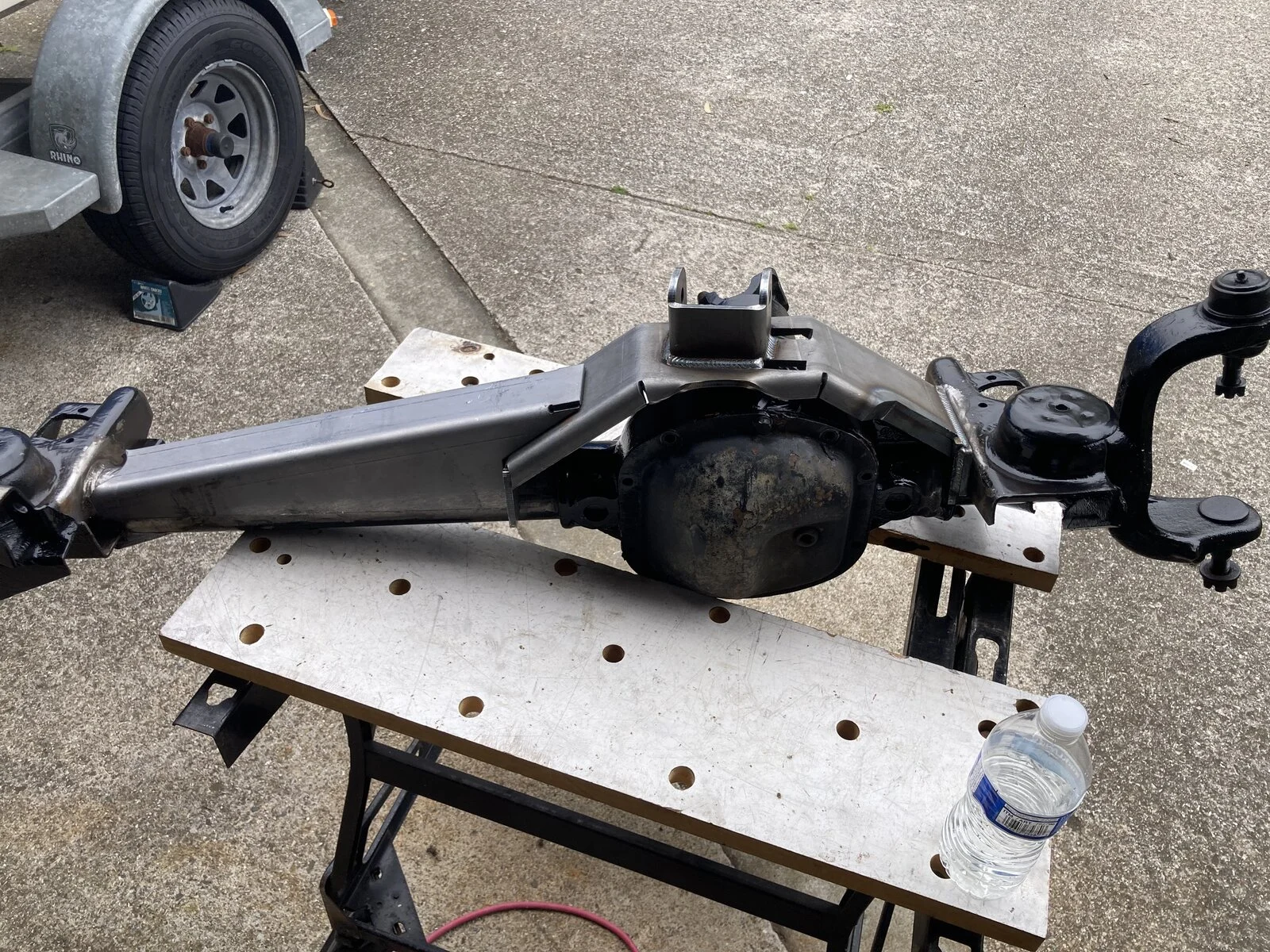

Thanks. Slow but steady, just stockpiling the new parts. Plans are currently to midarm the front with the new axle, get it regeared with new 35"ko2s, then stretch and midarm the rear. Still need lots of stuff lol
Sounds like a solid plan. I'm starting to gather parts for a 6" stretch as well but it seems like such a pita since I already have the rear midarm brackets mounted were the stretch goes.

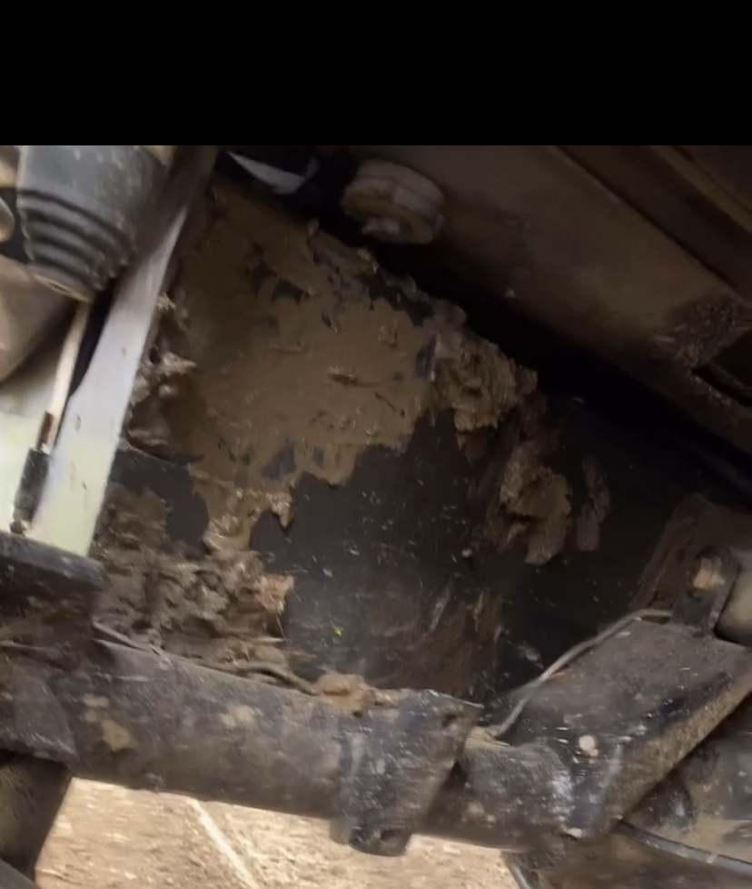

Check the facebook crawler groups I saw one not too long ago for 900, 20 gallon comp tank. Also for your plan of six inches of stretch I would recommend leaving an inch or two for tons, that way you don't have to reinvent the wheel (I don't see you sticking with rubi 44s forever lol). I was able to get 5.5 inches of rear stretch with plenty of room set aside even if I decided to run a 14 bolt lol. I also usually hate the look of a comp cut so I left plenty of room for 37s or 38s without having to go to a comp cut.
Edit: and find a smog guy who is easy on visual if you have it in your county. One guy wouldn't pass my genright tank, my solution was to take is somewhere else rattlecanned black and artificially smeared with mud.
