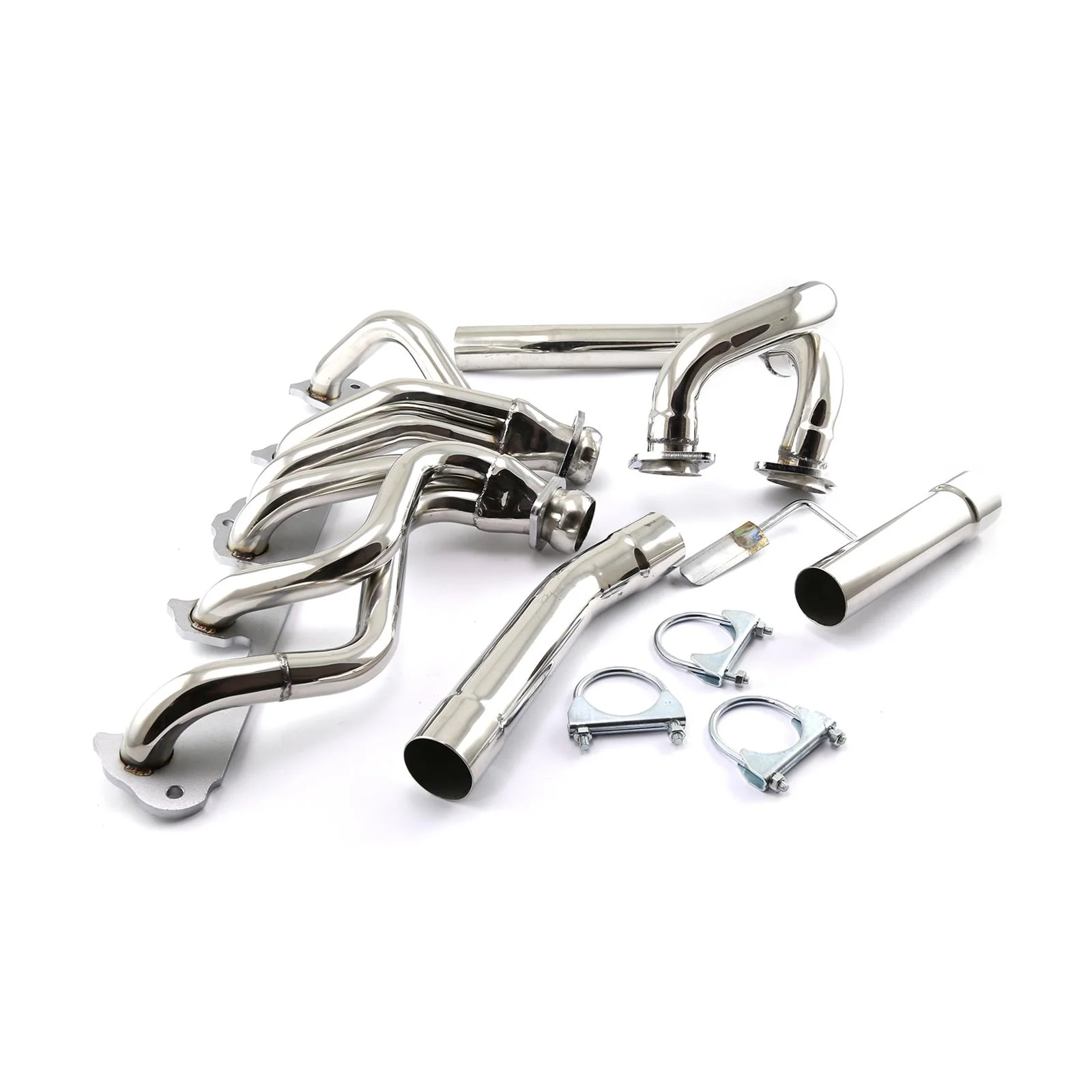

Just found this... I get a little too into looking for solutions some times...lol
https://www.summitracing.com/parts/...PrDqZIlu8hnvSXRD9IyT9VjHGTZVUlZRoCMCIQAvD_BwE

Just found this...
$346 not too bad.

$346 not too bad.
My ten cents...go with the 97/98 header because there are less pipes and one less exhaust seal.
