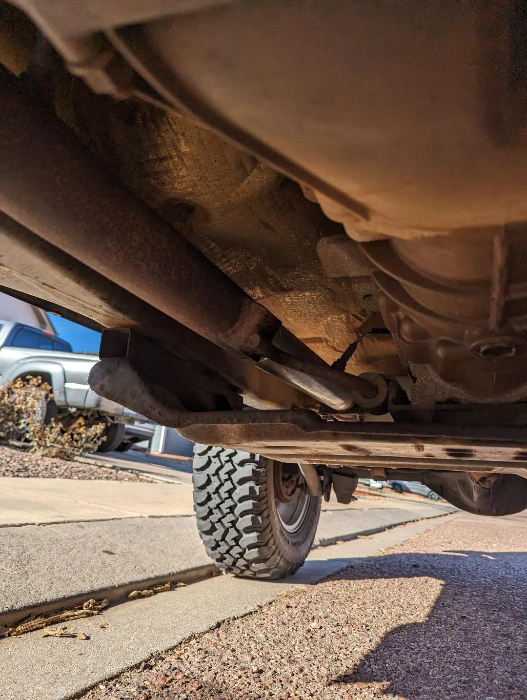

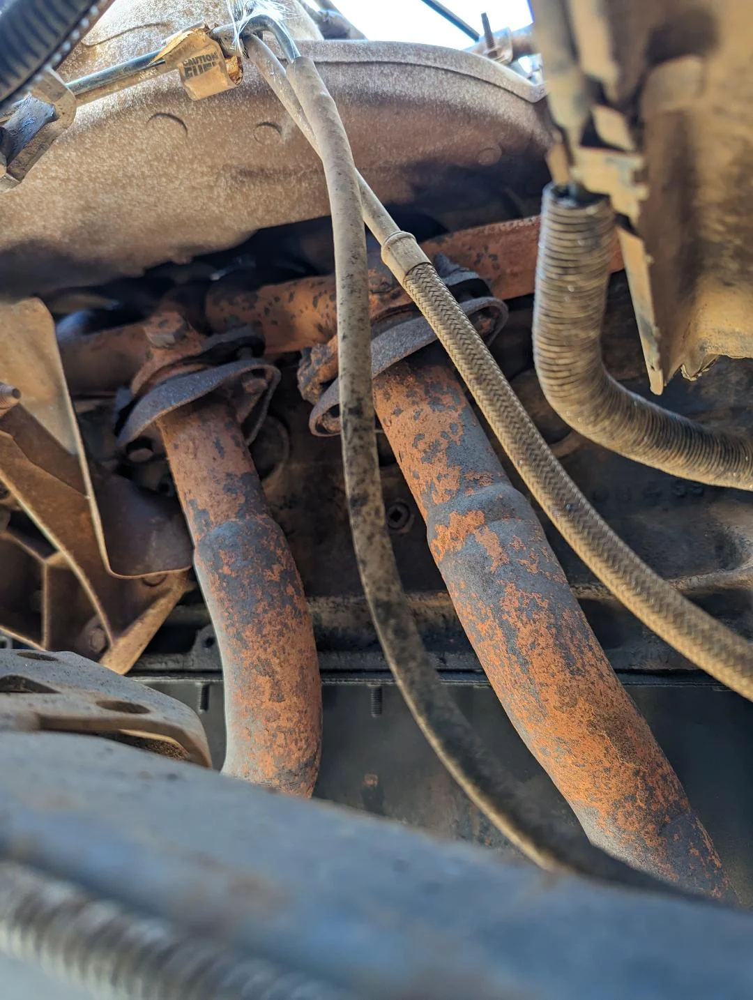

What's even more confusing for me is that the Jeep currently has a split-type header like on the later TJ models but no catalytic converters and no o2 sensors on the driver's side both are on the passenger side. non of this is lining up for me.

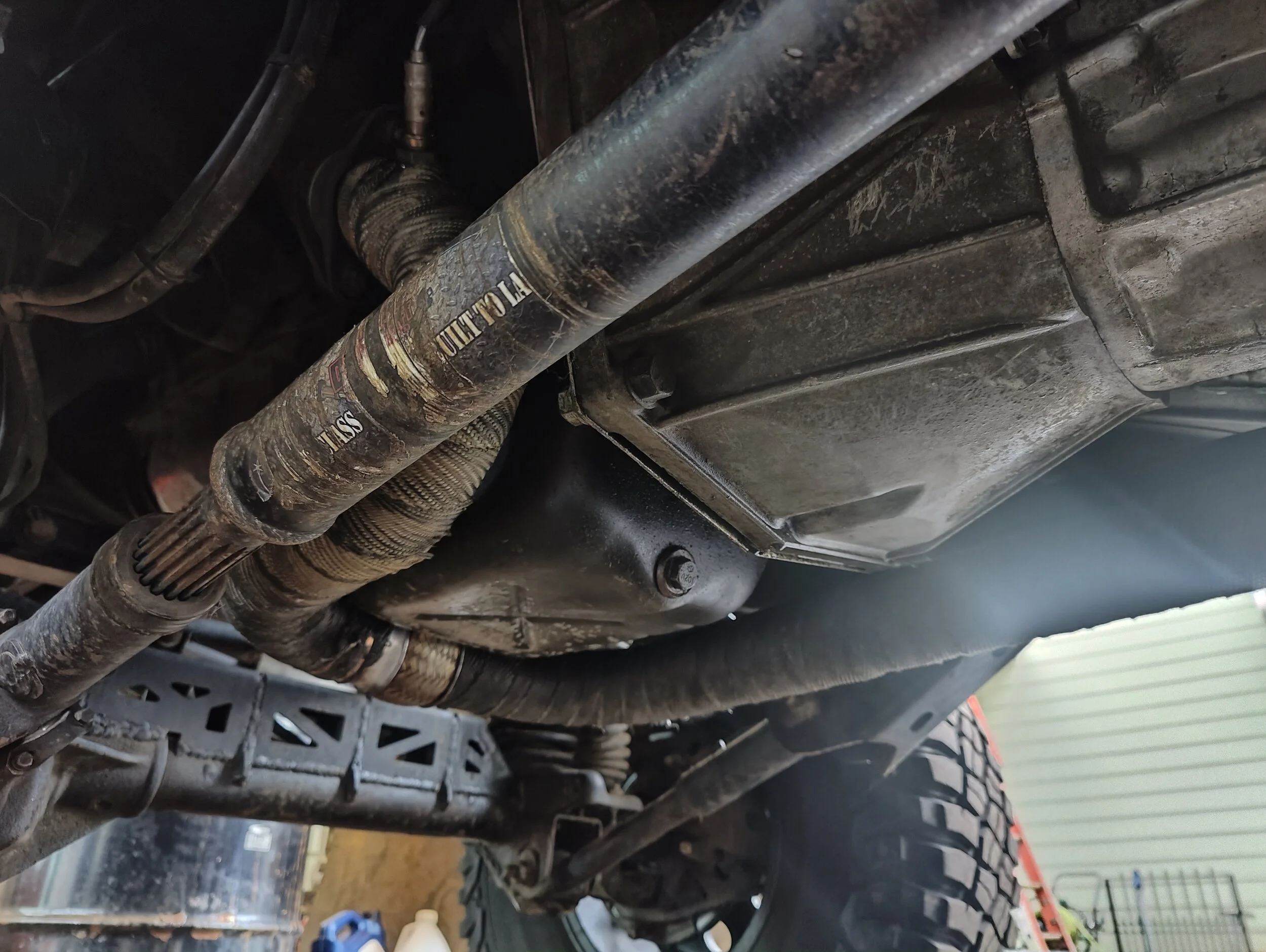

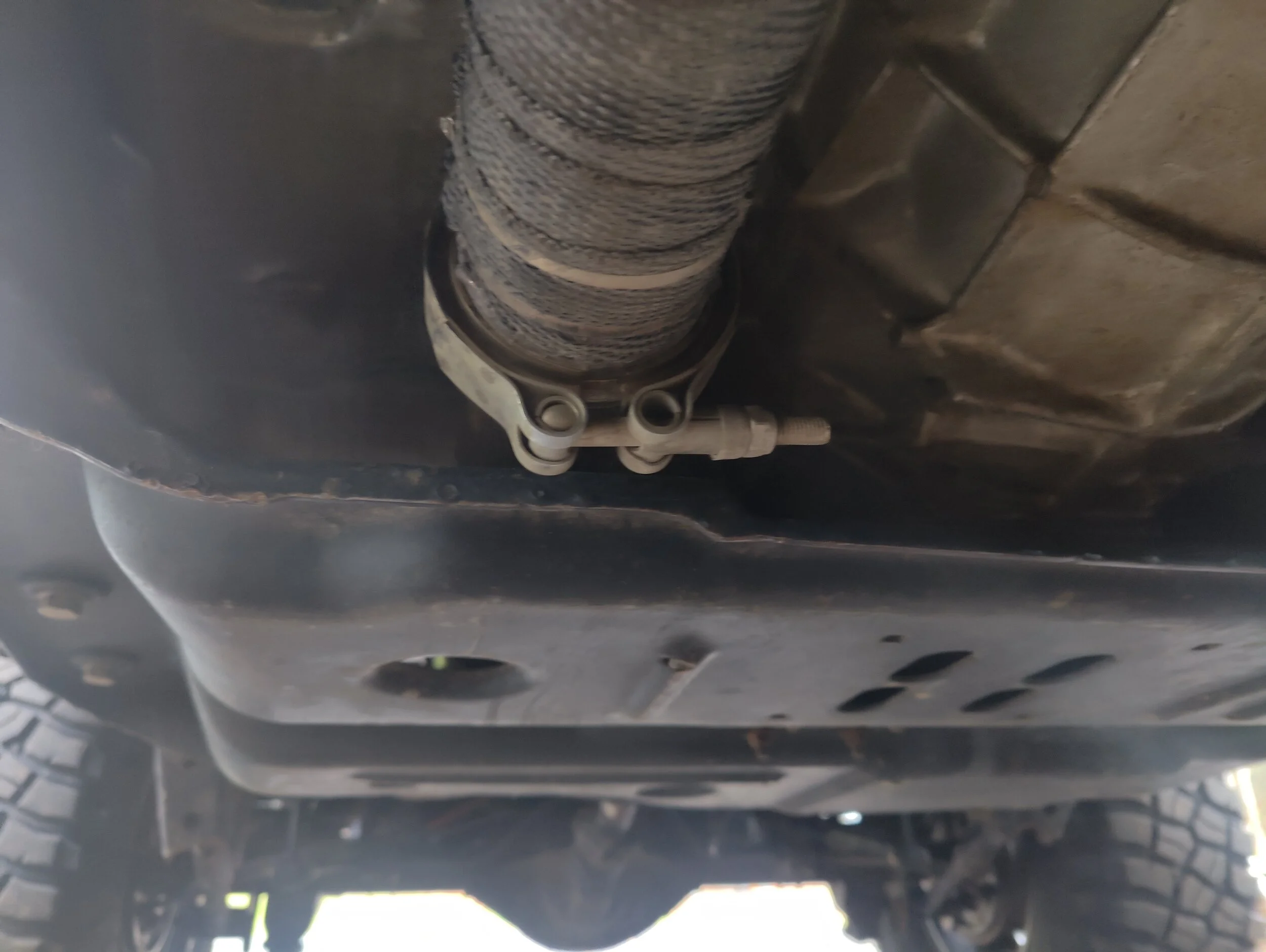

Here's what I have rigged up...Banks headers...then I welded up stainless 2.5" exhaust pipe and a v band clamp... wrapped the down pipe in DEI exhaust wrap.
-Mac

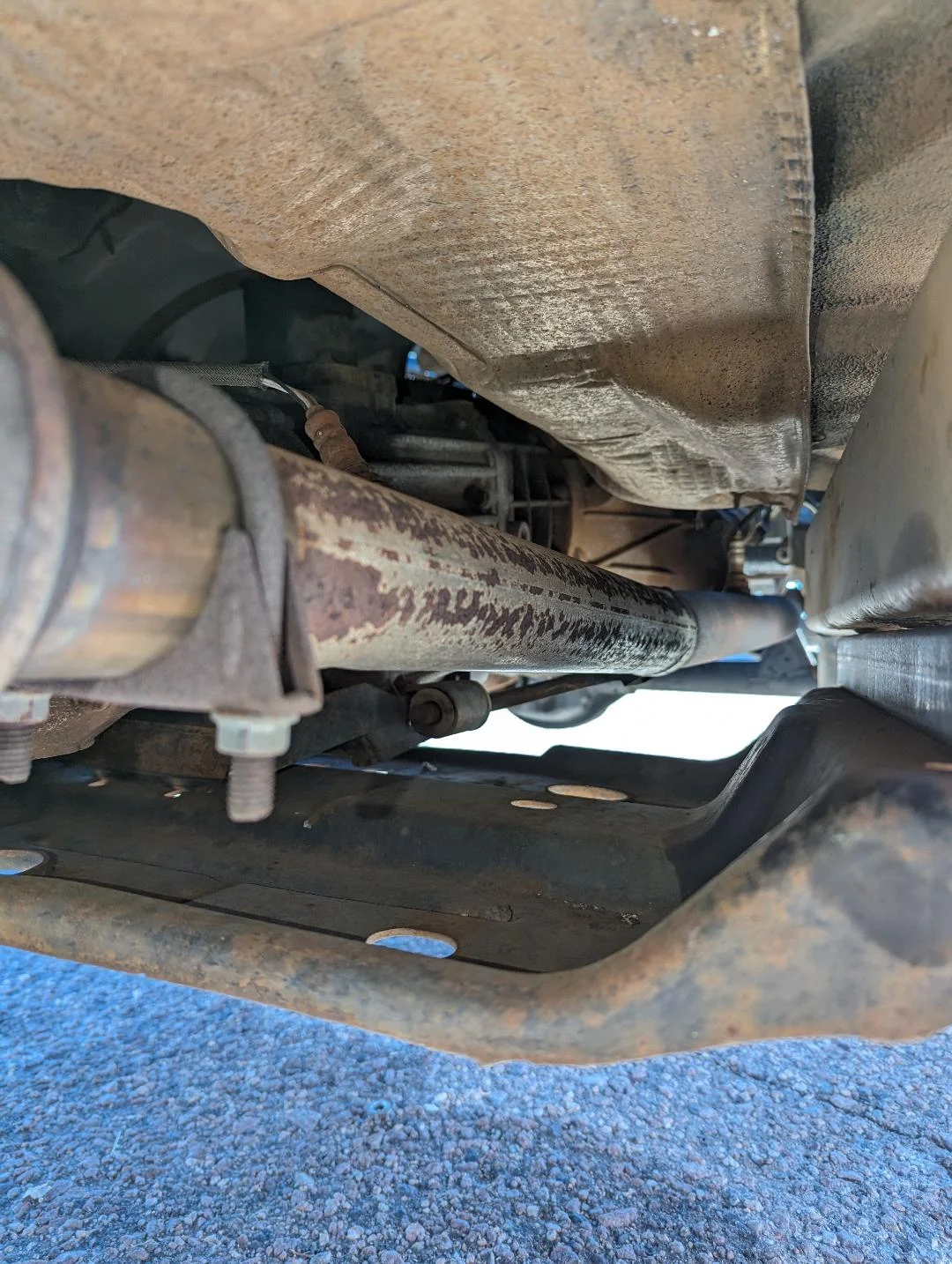

@ColoJeep and @SkylinesSuck are both correct. The 2000 4.0l is a transition year. There was Federal and California Emissions equipt. CA equipt is identical to the 2001 model year with the 4 O2 sensors and 2 cats coming right off the manifold.. The Fed equipt has the same split style manifold but only 2 sensors Upstream just before the cat and 1 downstream just after the cat... the cat is (should be) located down under the body right before the muffler.

Ok that lines up with why the upstream o2 is on my passenger side. what's the play here since no one makes the downpipe? use a 97-99 style with an o2 extension to reach?

You don't need to change the location of your O2 sensors.
FWIW, if you want to return everything to stock, I would not change out your manifol for an earlier model. While your header and intermediate pipe are rusty they look to still be in decent shape with some surface rust. It wouldn't be too much to clean them up and have them coated with ceramic or a good high temp exhaust paint.

That's definitely on the table. A lot of the rust appears to be very surface-level or is just old dirt and comes right off with a wire brush. I'm currently just a broke college student and don't live in an area with emissions so I don't really care about the cat I just want it to run well. I guess my next step will be checking the headers for any cracks or leaks and go from there.
