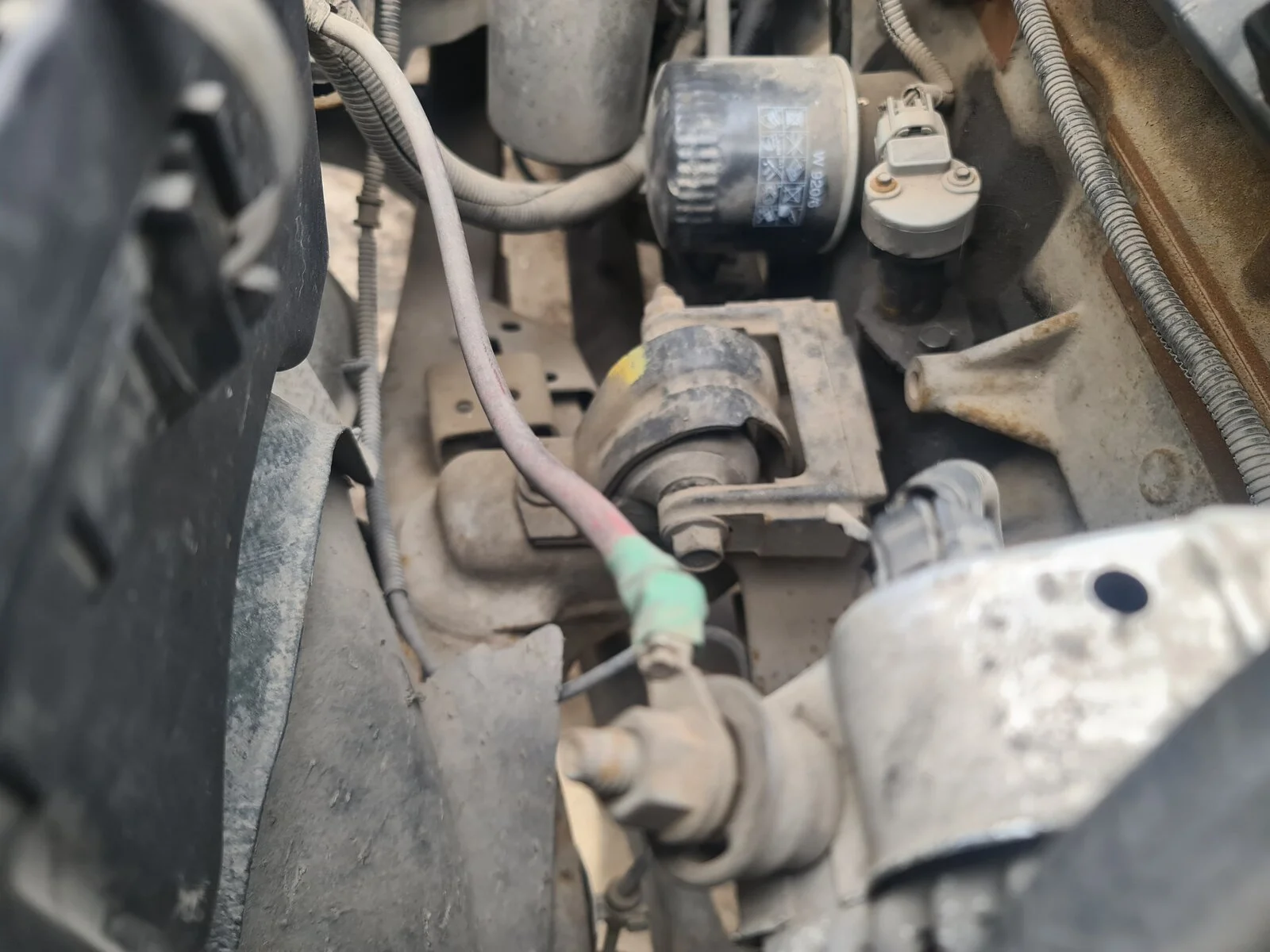

my engine and whole car shakes, no cel. it also smells gasoline very bad. i can hear sounds like valve work from exhaust, i tried to listen with wooden stick engine block parts here and there no sounds at al beside the sound fromnexhaust, i opened the valve cover, no broken valve springs, all pushrods spin around. i ve been to injector shop he checked all of them on stand and on car and said they work no problem.
the engine block is quite tilted backwards 10°. what direction i should dig? here is a foto of engine mount i think is tired.
can i check the valves without taking off the head? if i take off intake manifold and check/clean with carbon cleaner the back cap of valves? if they are leaking

Not related to the smell of gas or ticking valves, but I'd also check your motor mounts if the engine moves more than it should.
