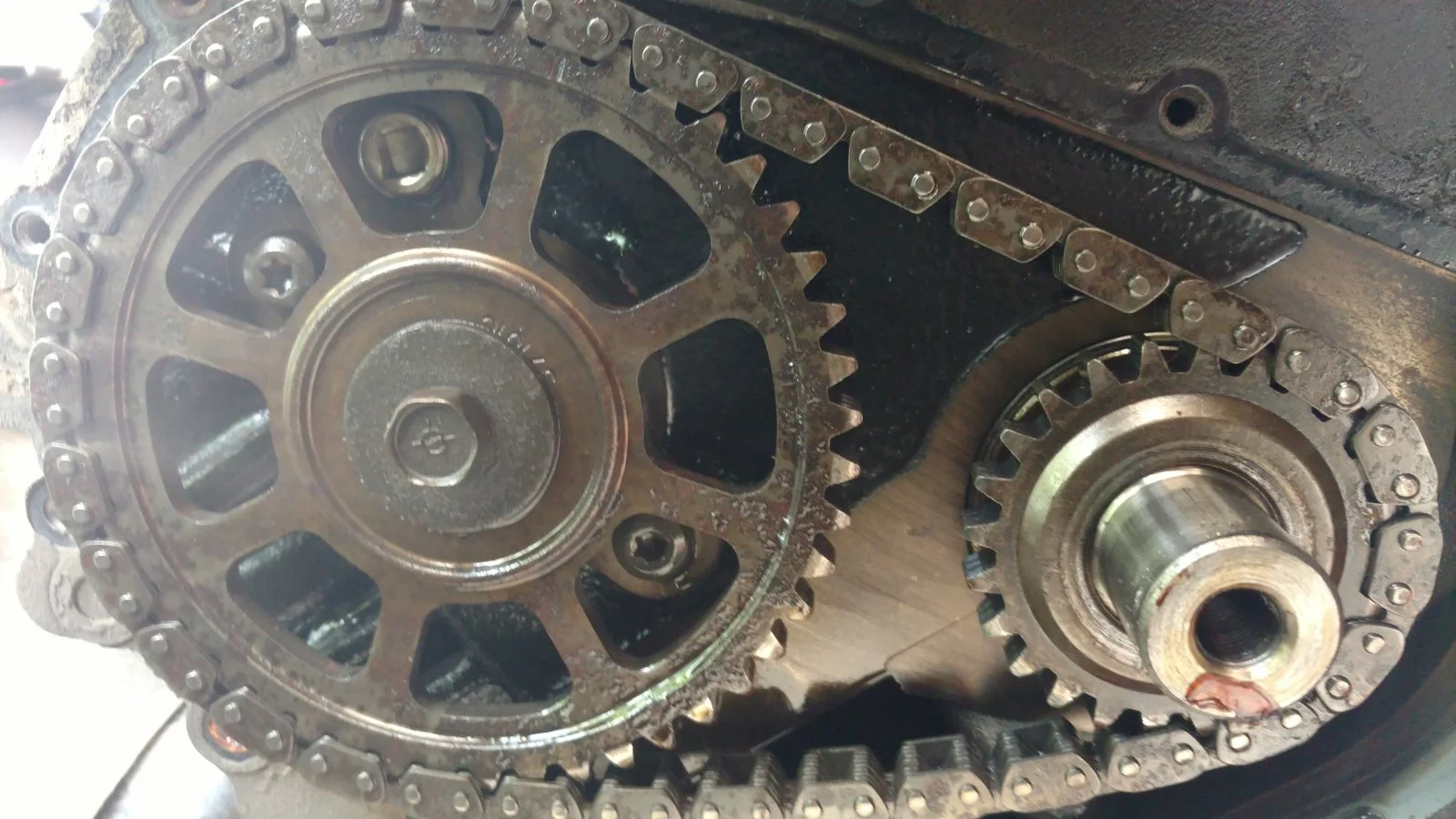

Had a chance to get under the Jeep with a buddy and look things over a bit today. I hadn't noticed before but noticed today I realized I could see the timing chain a bit. And when I checked, it appears to be really loose. Possibly the source of the noise I am hearing.
Mine was like that too at 120K. According to the internet they never wear out. I used a Cloyes set from Rockauto.com, you can always find a coupon to save a bit off the $70+shipping. I think Cloyes is better than Crown but I'm no expert.
Edit: looks like $75.24 shipped with a 5% coupon
Reactions: Airjunky

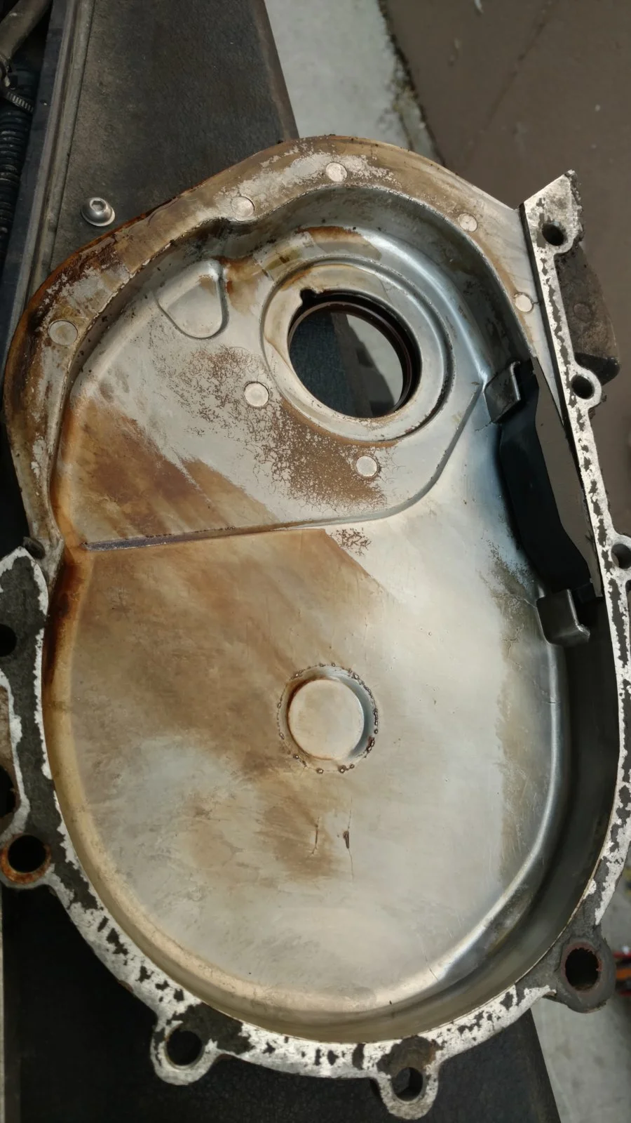

Timing cover off. Still nothing glaringly bad, other than a loose timing chain.

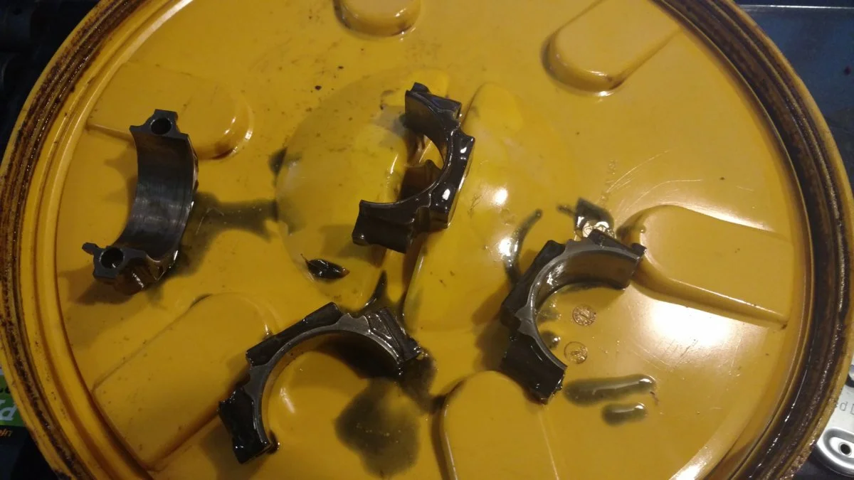

Wow, that looks pretty bad. Excuse my ignorance but what will you do in this situation? Grind the crank and replace the bearings? Rebuild the entire engine?
I thought about just replacing all the rod bearings and buttoning it back up. But recently found a guy who says he will do it for $1500, parts and labor. So I think I'm going to rebuild it.
That bearing is too far gone to just replace the bearings. The bearing journal on the crank is ruined. You’re doing the right thing by rebuilding the engine.

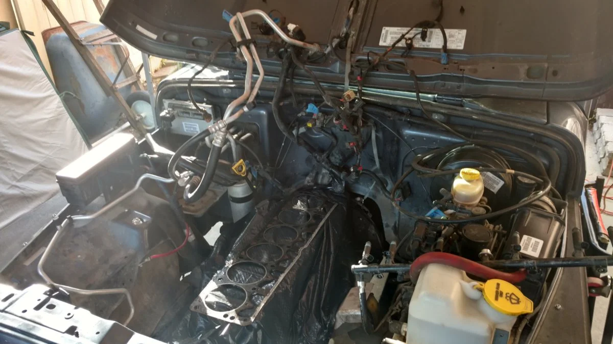

Tore it down in the Jeep today. We were going to pull it whole, but my partners hoist had leaked. Took about 3 hrs to get it down to the block, Pistons & rods are out. He's going to refill the jack on his hoist and we'll pull the block/crank tomorrow.
The last pic is the weird oil still in it. Like Rotella diesel oil or something. Any chance this is why the rod bearing spun?
