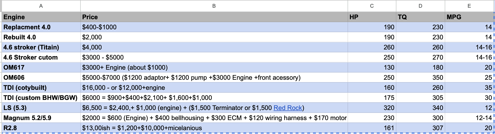

You were talking about a engine swap and that would take about a month if you did not run it to any issues ( ECU to swapped engine) which is always going to happen plus the tow to the muffler shop to get the exhaust system made.
That said SCB with carb and Turbo 350 would be the easiest but then you are still dealing with the wiring for all your systems.
