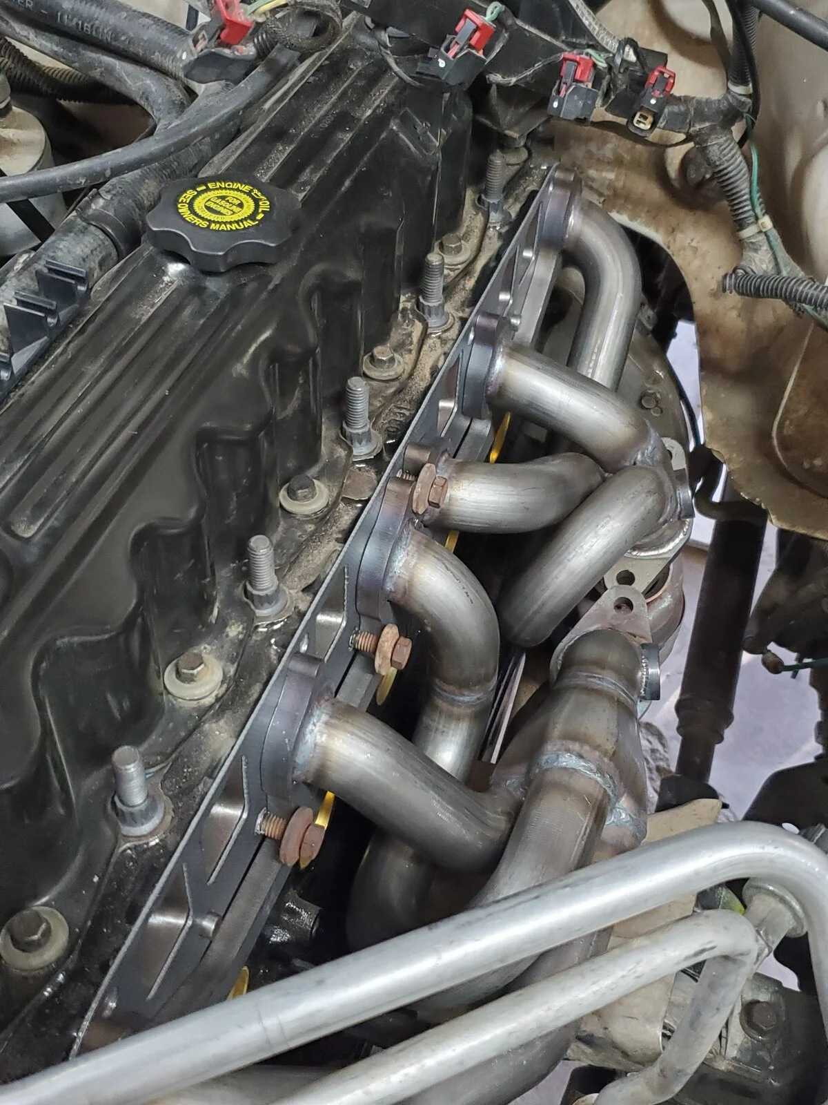

Banks Torque Tube (Header)
let me know how you like that header
Russ Pottenger recommends using the Banks header for his builds. In order to pass smog inspection I needed a CARB compliant header which the Banks one is. As long as it doesn't crack I'll be a happy customer.

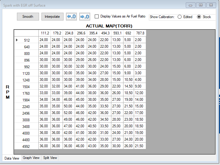

I was told by russ and several reputable tuners it would be a waste of time and money to do more than bigger injectors unless i wanted to run on premium fuel. Passes emissions just fine
I am surprised they said a tune would be a waste. The timing table under higher load is very conservative. When you need more power the ECM is pulling timing. This is a stock timing table for a 2004. A member posted a 2005 table and it was the same. 395.4 torr is about 53 kPa.

It isn't. I was running an Edge 62mm TB before. I changed it since the Edge is not CARB compliant.
