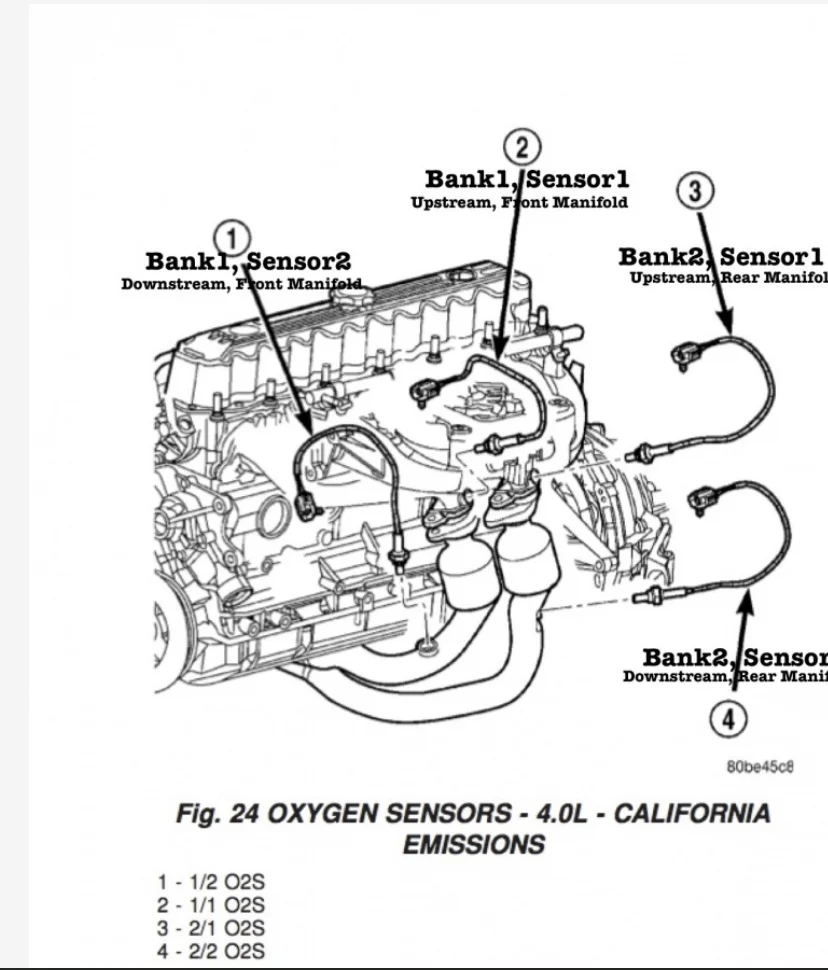

Bank 1 is the front catalyst off cylinders 1-3. You have a bank 1 sensor 1(pre cat) and bank 1 sensor 2(post cat). You have the same for bank 2 which is off the rear 3 cylinders. In my experience p0420/430 usually are not bad o2 sensors but you can certainly try to change them if you like.

I don’t want to change all 4 if I don’t have to. I’m thinking bank 1 sensor 1 is the code I’m getting?

4 different 02 sensors. Go to Rockauto website and go to jeep-Wrangler-2000- emissions-02 sensors.
Corrected for you but you need to buy only NTK/NGK the reason it may be best to change all 4 is if you dont currently have NGK or Mopar you dont want to mix&match fail
Honestly not sure what I have. I’ve only had the Jeep for the month. I’m thinking Of replacing the top 2 to start. Thoughts?
