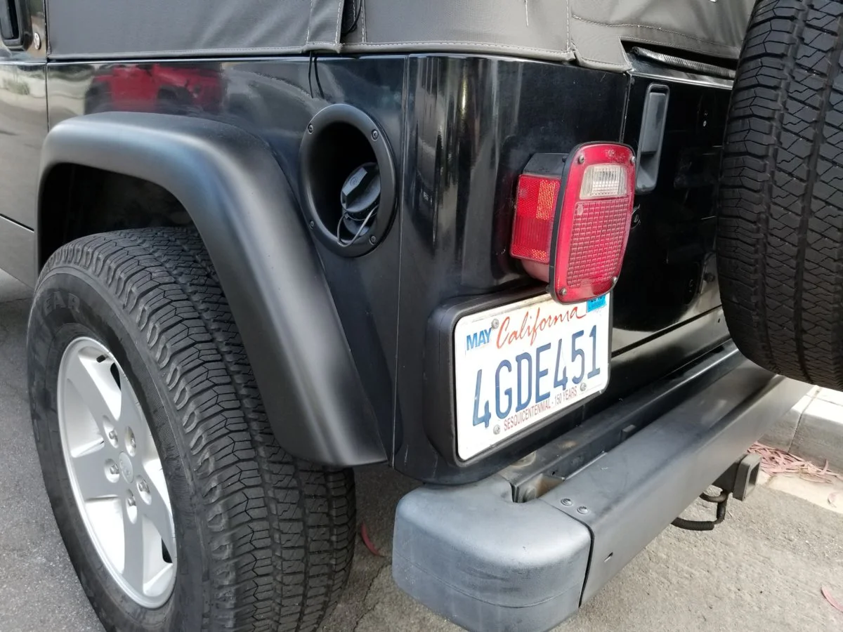

Suggestion - if/when you take off the rear bumper, that's a great time to hit the rear crossmember with a coat or two of paint. I forgot, and later had to tape everything off in order to get mine painted, as it was too much trouble to remove the Dirtworx bumper just for that...
Good idea. Thank you. I also want to paint the frame on the sides. After taking off the fat side steps. Alot of ugly dirty frame is visible. I tried pressure washing it at the car wash. But didn't make much difference.

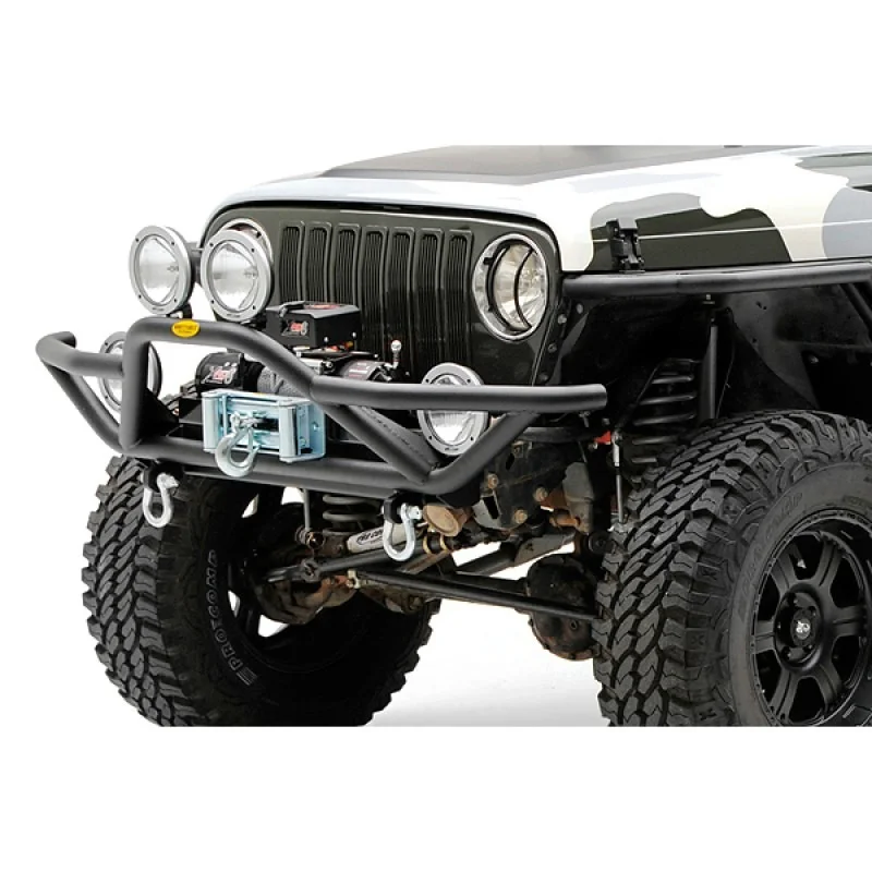

I'm torn between just painting the rear bumper - or - putting my tubular bumper with tire carrier on. It won't match the front stock bumper. And my plan was to wait until I at least had the front bumper to put on and match it. And then maybe some sidestep/rails along the side. After the tube bumpers.
I also need to either finish supporting my spare tire on the standard tailgate mount. OR switch to the tube bumper with tire carrier. Seems like a waste of time to spend beefing up the bracing for my spare tire. If it's gonna get put on a tire carrier anyway. Decisions. Decisions. Do I rock a non matching rear bumper so I don't have to beef up my spare tire mounting? Or do I just paint my bumpers and wait until I have the tube front bumper to put on with the rear tube bumper?
(Did you notice I didn't mention the name brand of my tube bumper? Cause it's a Smittybilt. lmao. But I only paid a hundred bucks for it. And it's a $450 bumper. So if it's a big fail. No biggie. I can get a hundred dollars out of it.
I hope it works. I never quite got a full explanation from the guy I bought it from. As to why he was getting rid of it. But I suspect it was a loose and squeaking/rattling tire mount bracket. I've read a few solutions. One of them involves aluminum backed sound deadener material inside the catch. And I have a ton of that stuff laying around. Other solutions abound. But we'll see if there's any malfunction at the junction with the bumper/tire carrier once I get it on.
I'm really only putting them on for looks. And to give me some cheap protection in a slow collision. The front isn't even classed as a bumper. It's a "brush guard". (The rear is class III #9000 two rating.) So hopefully it will crumple before my sheet metal does. And not cause me a totaled vehicle.
It's one of the things that drew me to Jeeps in the first place. It's the only vehicle you can surround with a steel bumper. and have it look halfway normal. My wife has had two vehicles totalled in very slow collisions with very little damage over the past few years. I'm hoping if I get into a small accident all I'll have to do is replace a cheap bumper. But I also like how they look to be honest.)
The rear bumper:

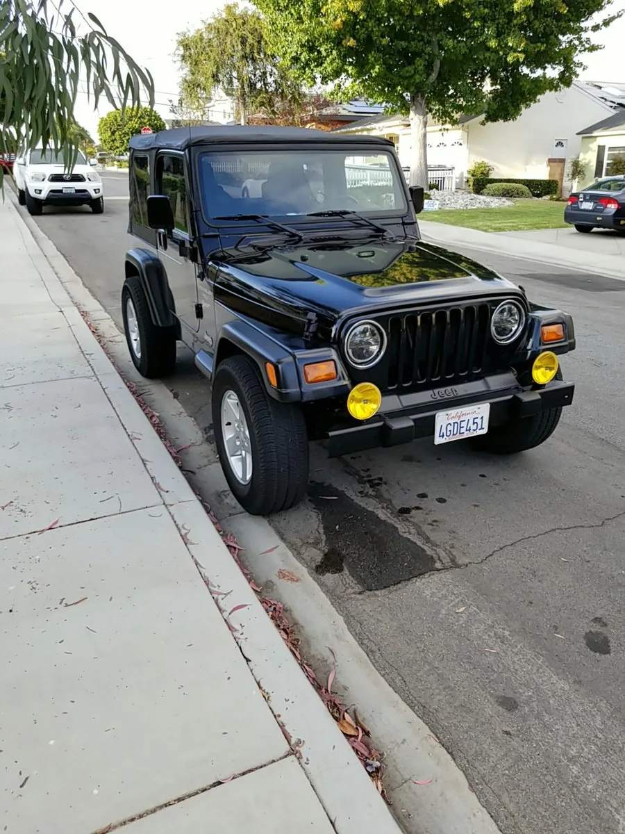

The front bumper:

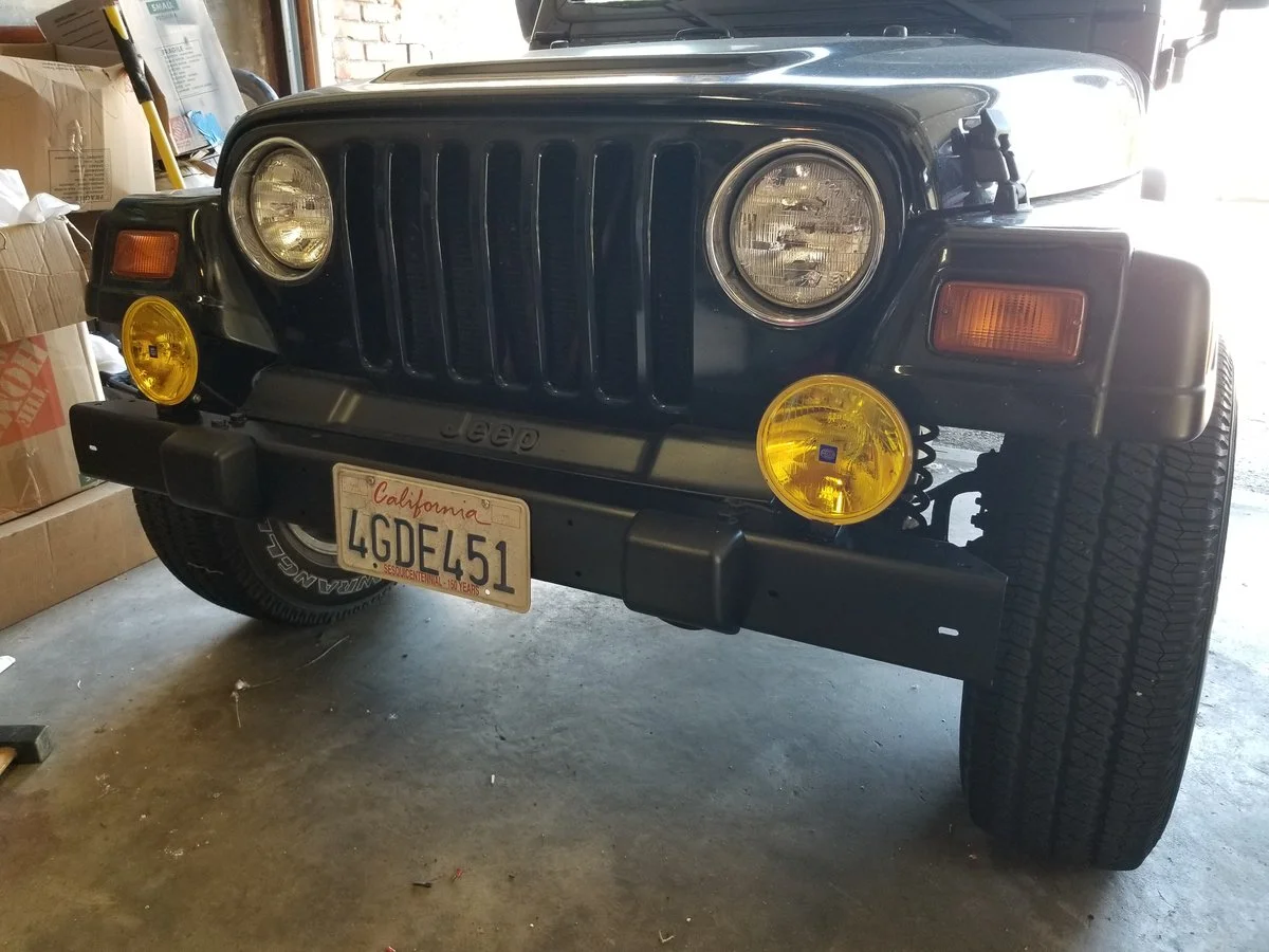

I took the front bumper and fog lights completely apart and painted them. What a huge difference. Prepped with dawn, acetone, adhesion promoter and SEM trim black. Then I got the flu. And had to put them back together this weekend.
Then decided after completely refurbishing the fog lights. That I wanted to put the yellow Hella 500's on. Glad I did. Had to hardwire the lights. As both connectors were female. And I didn't have any male connectors. So I just joined the wires with couplers and covered them in shrink tubing.

Next up is the rear bumper and removing the tow bar in the back. That will have to wait until tomorrow or next week. As the tendonitis in my elbow is at max about now. Gotta let it rest. Or go get a cortisone shot.

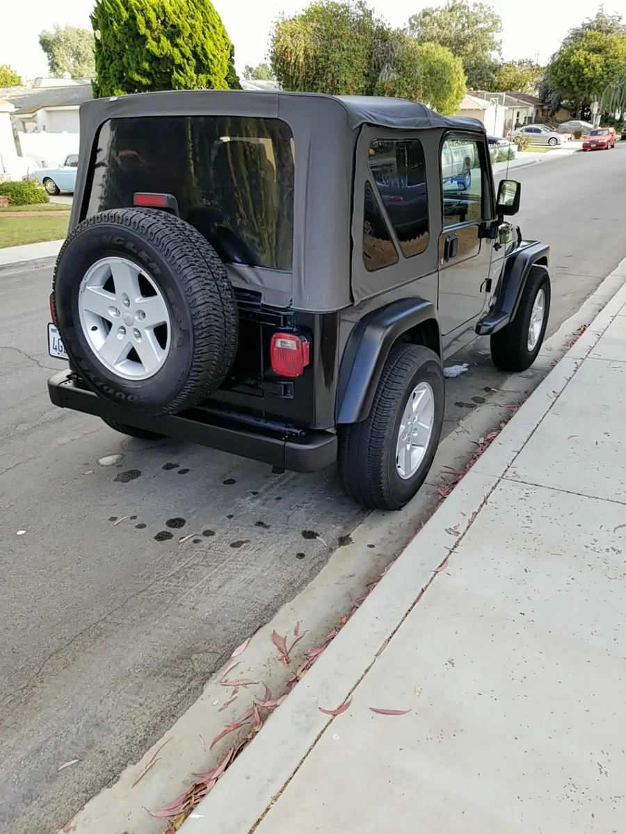

Before:

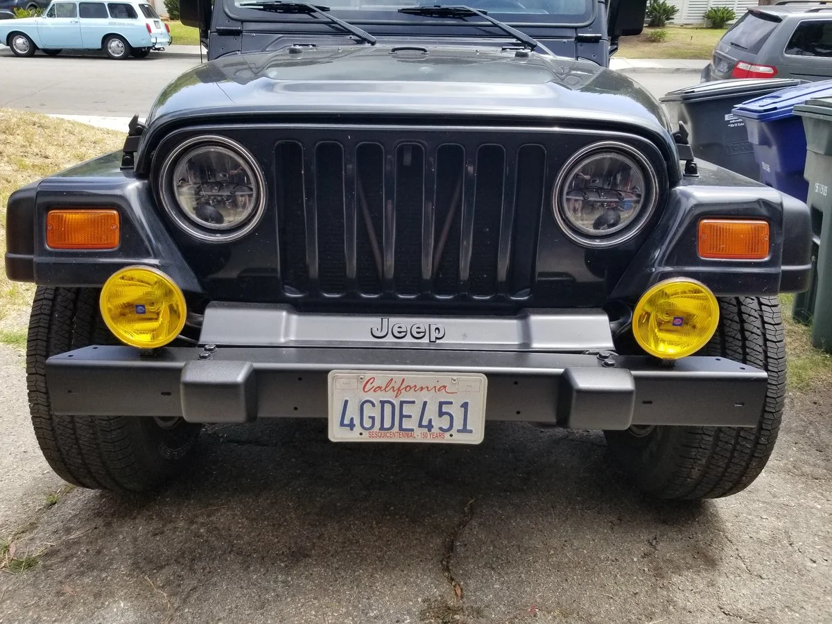

AFTER:
I like the yellow fogs. I've always been a fan of yellow fog lights on any vehicle I owned. I did the same thing with my M3 and my M5, put yellow fogs on them.
It looks particularly good on black.
Thanks bud. Ya. I restored the original ones. But then got a nice birthday check. And got the yellow Hella's. :) I only wish I could find those metal screen protectors.
Just put some Lamin-X film over them. That will protect them from big rocks and pitted lenses. I put that stuff on all my headlights and fog lights.

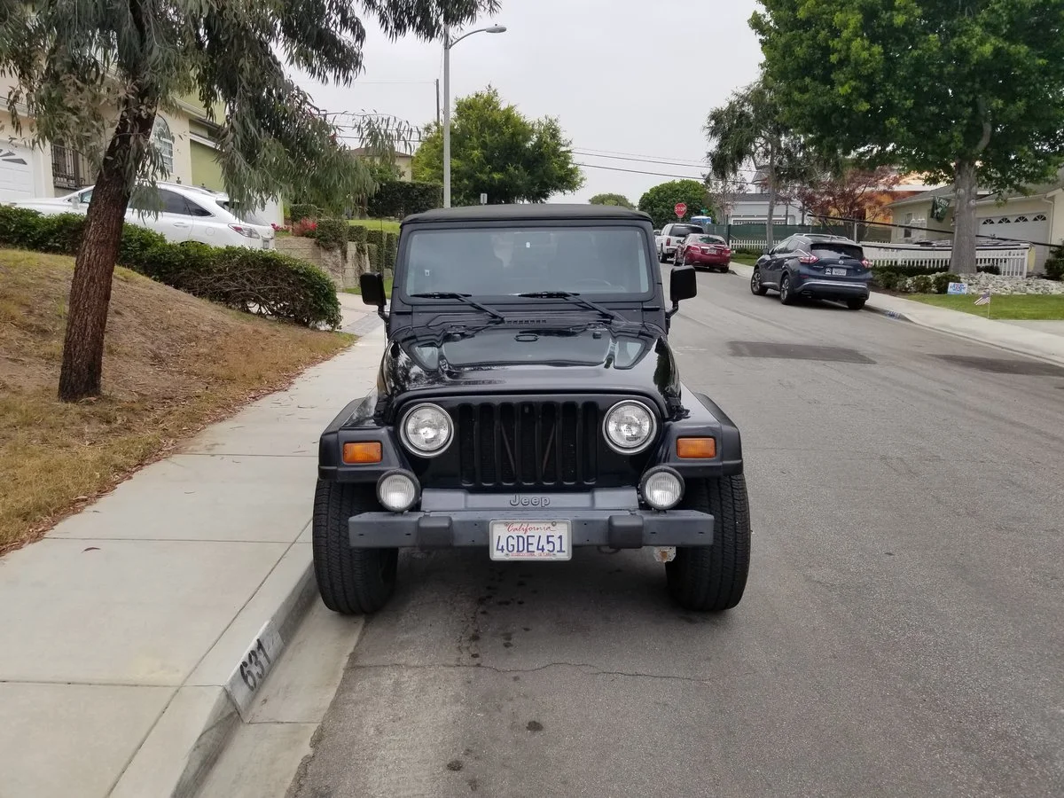

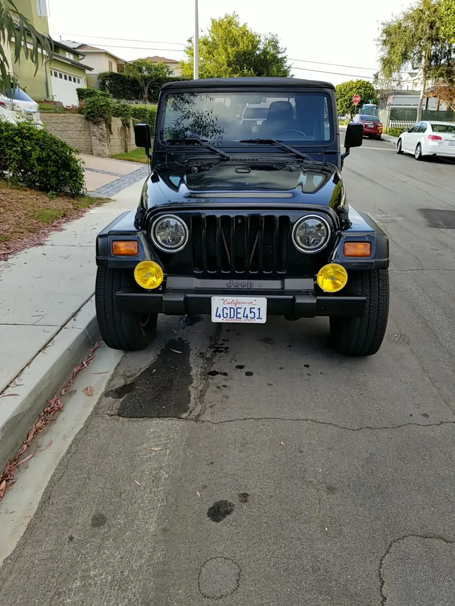

If you look back at the original pics. I've really improved the look of the Jeep overall. I'm not embarrassed to drive her in public anymore. lol. Next up is to paint the door handles and rear view mirrors. Then onto the interior and sound deadening and new carpet. Saving up for new PAtagonia M/T tires too.

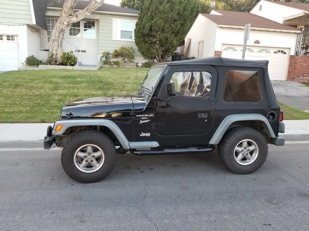

Here's a before:
From pig to princess. lol.
