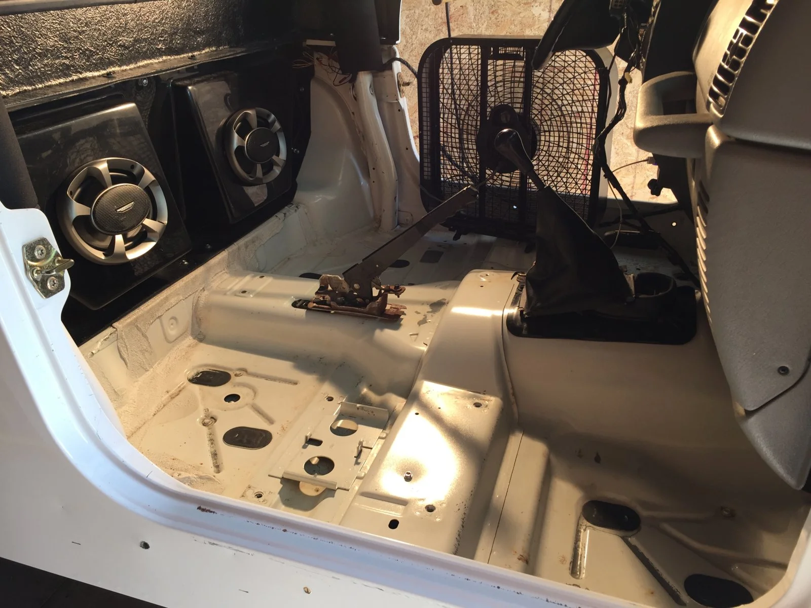

My 05 has a plastic panel on the tunnel around the shifter, underneath the center console. Held on by 8 or 10 10mm and 8mm bolts. If you have that as well which I think all this do? Pull your center console, shift lever and that plastic panel. It gives you pretty good access to those bolts
Here's the only picture I have showing the panel
