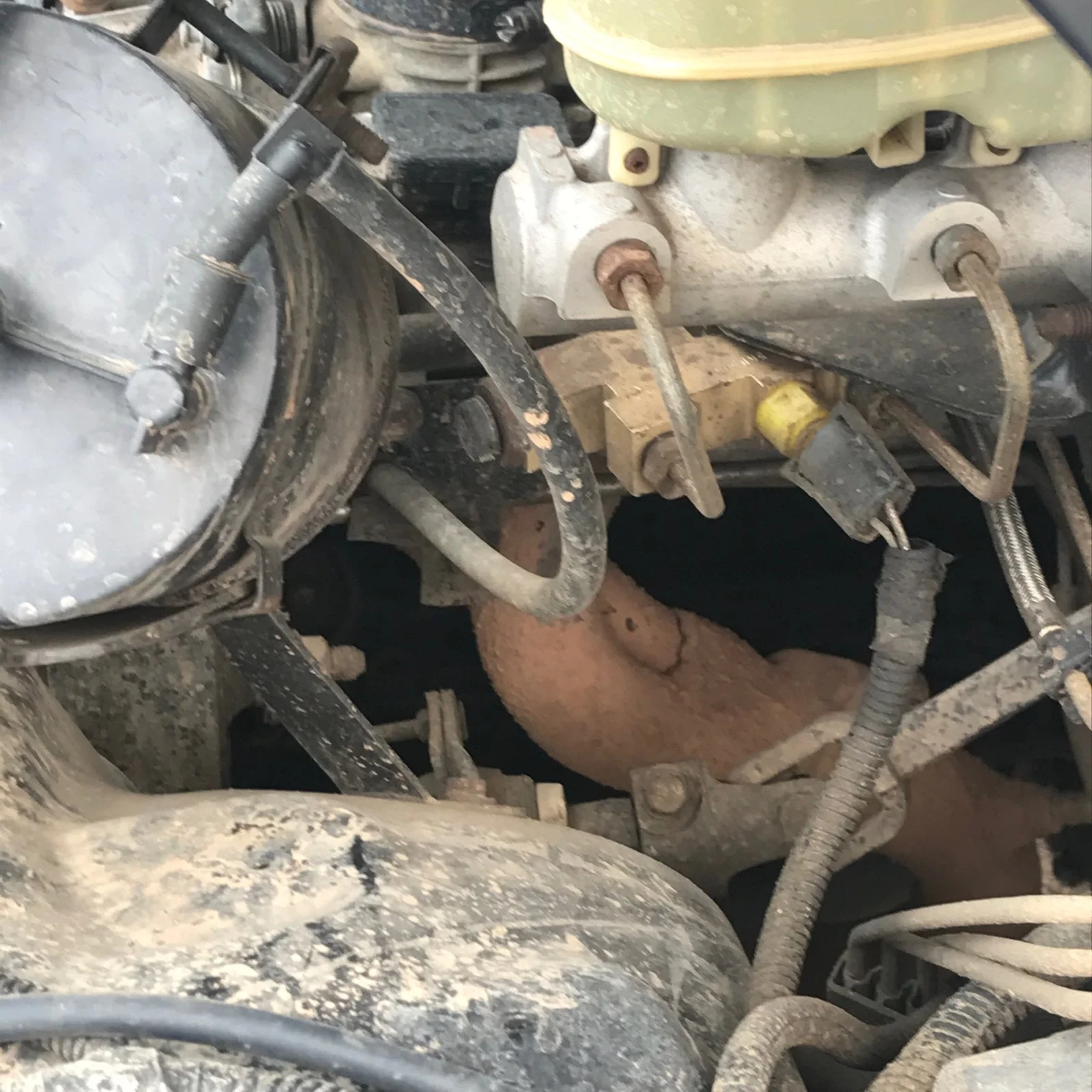

Spotted this crack in my exhaust header. Hoping for a few recommendations on replacements? Also is it easy to do yourself or is it better off just having the shop do it for me?

In that case, this is the best one you can get IMHO.
https://www.amazon.com/dp/B004CIK628/?tag=wranglerorg-20
There's others out there (like the cheap ones on eBay), but they WILL crack (I guarantee it) in short order, as they're stamped out pieces of Chinese crap.
Changing the header isn't easy. I've done it before and you have to be a contortionist to get up there, seriously.
It makes it fifteen times easier if you remove the entire driver side fender, then it becomes a walk in the park. But with the fender on, it's one of the most cumbersome tasks I've ever done.

Is something like this the cheap stuff that will crack? Also does just taking off the fender flare gets me there or is there more I would need to remove? I haven't done a lot of work besides the basic stuff so I want to make sure I don't get in over my head.
That's just some Chinese header. I have no experience with it, but I wouldn't waste my money on it personally. You're free to give it a try though and report back. For all I know it could work out!
No, you need to remove more than the fender flare. You have to remove the entire drivers side outer fender and inner fender.
Like this:
Just the driver's side fender though.
It makes the job so much easier. Try it with the fender on and you'll be cursing, busting knuckles, and wondering how it's even possible.
