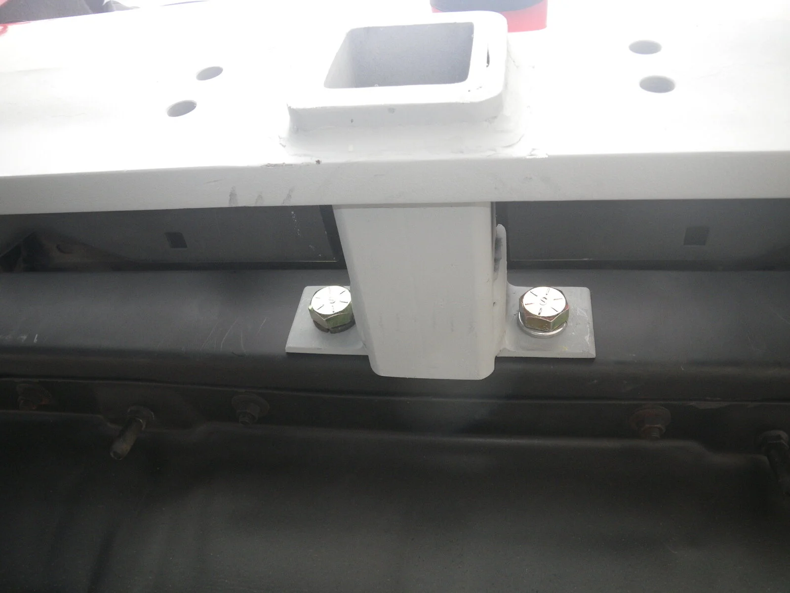

I really like your design. I can see part of the receiver on the other side of the rear crossmember. How did you do that?
I have an LJ, so I was able to bolt it to the second crossmember. I cut through the bottom of the outside crossmember to make it removable.
Was that done by hand are did you design and cut it out on a plasma cutting table? That looks fantastic!
My idea. It's just 4" x 3/4 bar stock. I took it to a shop premarked; they did the bolt holes and cut out for the hitch.
On an older jeep, I made a similar one out of 1/2" bar stock. No hitch, but I cut and drilled everything by hand.
