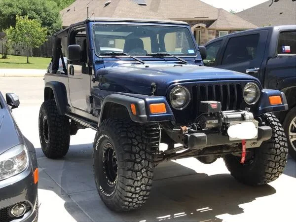

Really interested to see some factory bumper mods. Front or rear. Post what you did, how you did it. Maybe even the cost? Even if you are running an aftermarket bumper post pics of what other people are doing that you like and etc. winch plates, cutting, etc.

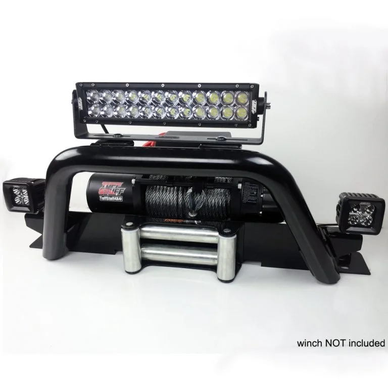

I'll start. Looking at doing a factory chop and the Tuff Stuff winch plate. Over all cost of the plate is $120. For the value and the look I think it's right up my alley!

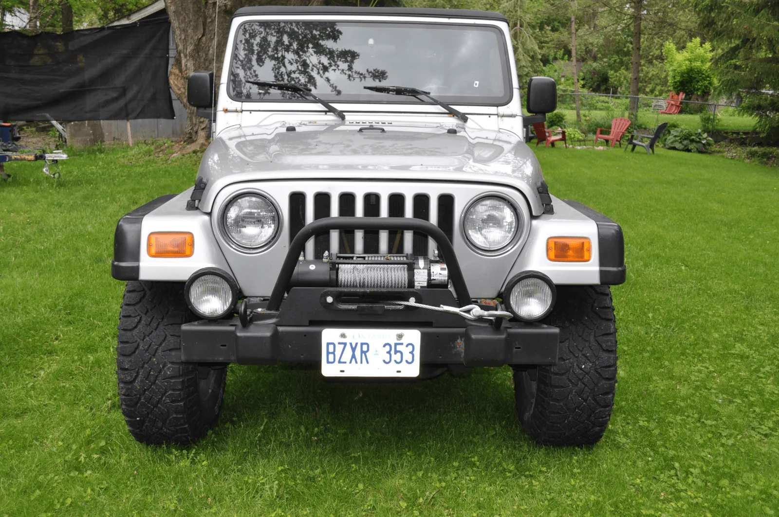

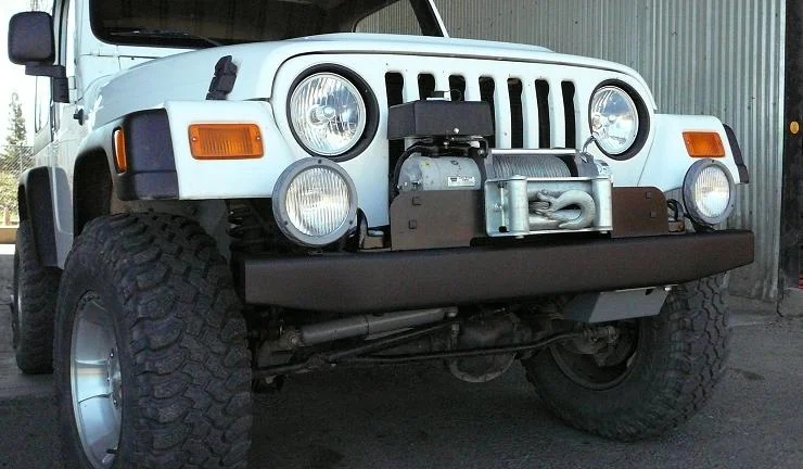

I modified the front bumper of my LJ by cutting 4" off each end. I wanted to retain the original lights so 4" was the max I could take off. I duplicated the original angles so I could reattach the MOPAR plastic end caps that you pictured above. I added a Warn winch plate and welded on a pair of brackets to fit a Warrior hoop to it. I couldn't reattach the original tow hooks but a pair of Reece hooks fit fine.

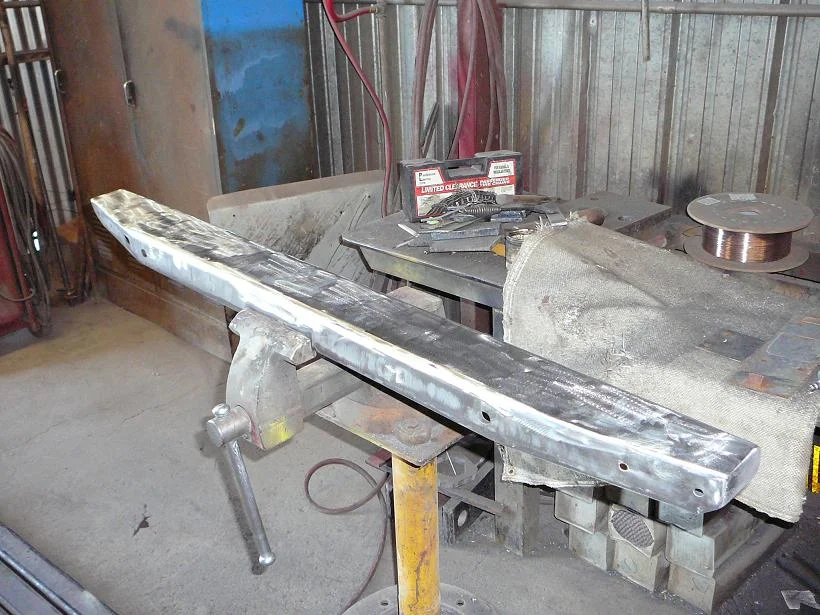

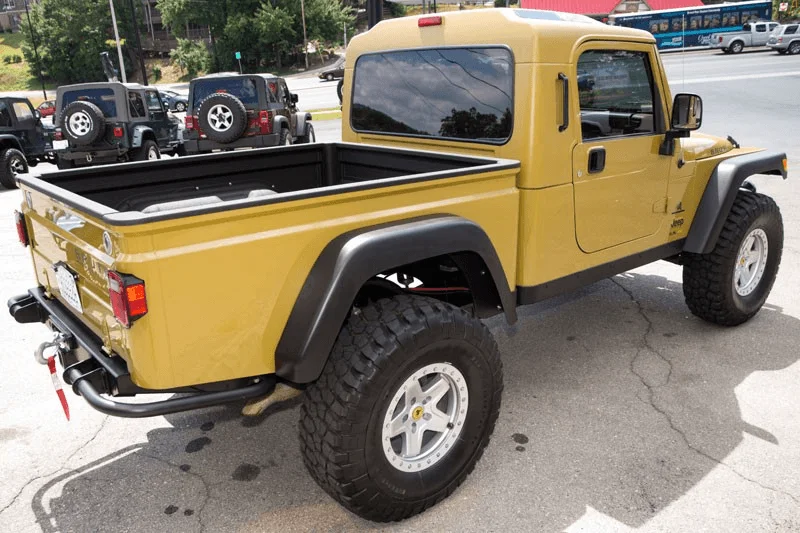

I haven't modified my rear bumper yet but I plan to make a rough version of AEV's Brute bumper. I've fabricated most of the parts that I need and just have to weld it up. It will look something like this ...
I like where you are going with this! Can't wait to see what the rear looks like.

That's awesome! After putting the angled cuts on the bottom did you weld it up?
Yes, I welded up the ends and wrapped it at the corners. I have better pics on my work computer. BTW, I still have this bumper if anyone wants it. I bought a stubby winch mount bumper, so it's up for grabs for the cost of shipping, which shouldn't be much since it's light.

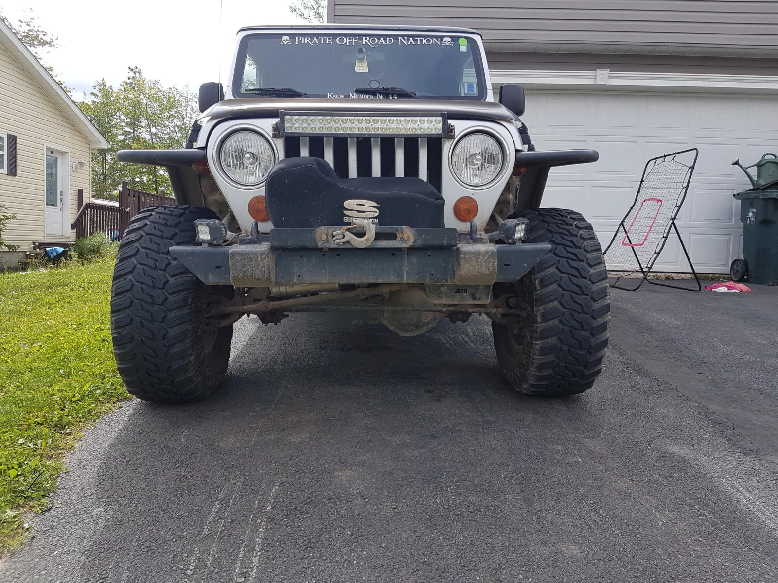

I also like this bumper chop.
Yeah if I don't buy a different bumper, I plan to do this mod here, chop it close or flush with those front rubber bumpers.

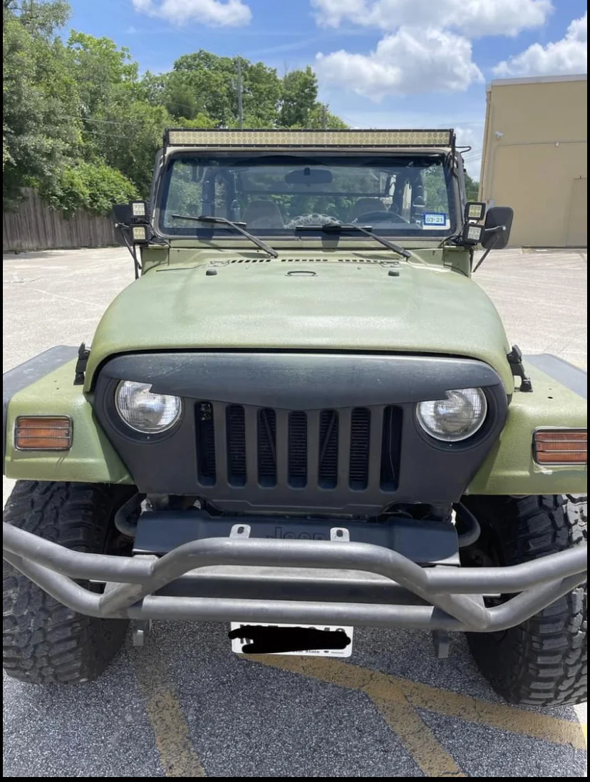

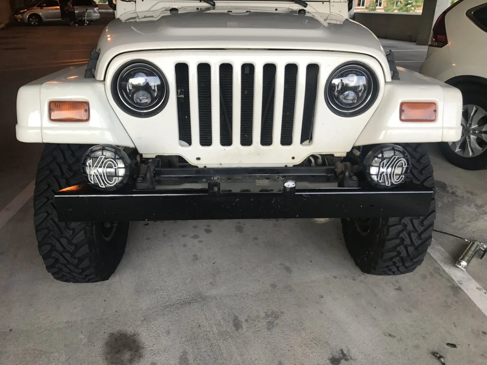

I cut about 4" off each side of my girlfriend Jeep and added some lights for the front on the rear bout some end caps and bolted em on
