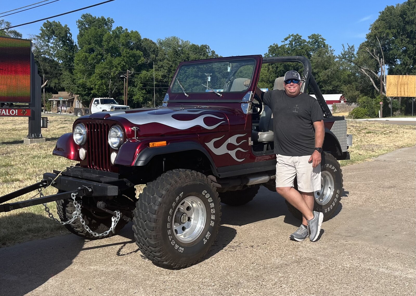

post up some pics. of the flamed out machine. me likes flames!
Big Red is my new this July to me 1982 CJ5, but it has a 1978 AMC 304 V8 and a 1980 Dana300 TC, 6" lift and 35's with side glass packs. Caster is for shit, ha, bounces all over right now, but it's no biggie, I drove my 78 CJ5 for 5 years in college all over, and it was loose as all get out, crazy stuff ha. Flames just came on it, I wanted a candy apple red....the silver flames are growing on me, ha.
I have my 05 TJ Black Rock Crawler project that I love, and my Big Red now that just nostalgic. No frame or concerning rust, overall, and the engine puts out, I just bought wide track axles I found on FB Marketplace, gonna slow rebuild those and get them looking factory clean. Gonna be fun to tow it to the beach and make some noise in Galveston or down in Padre.
that’s too cool!
