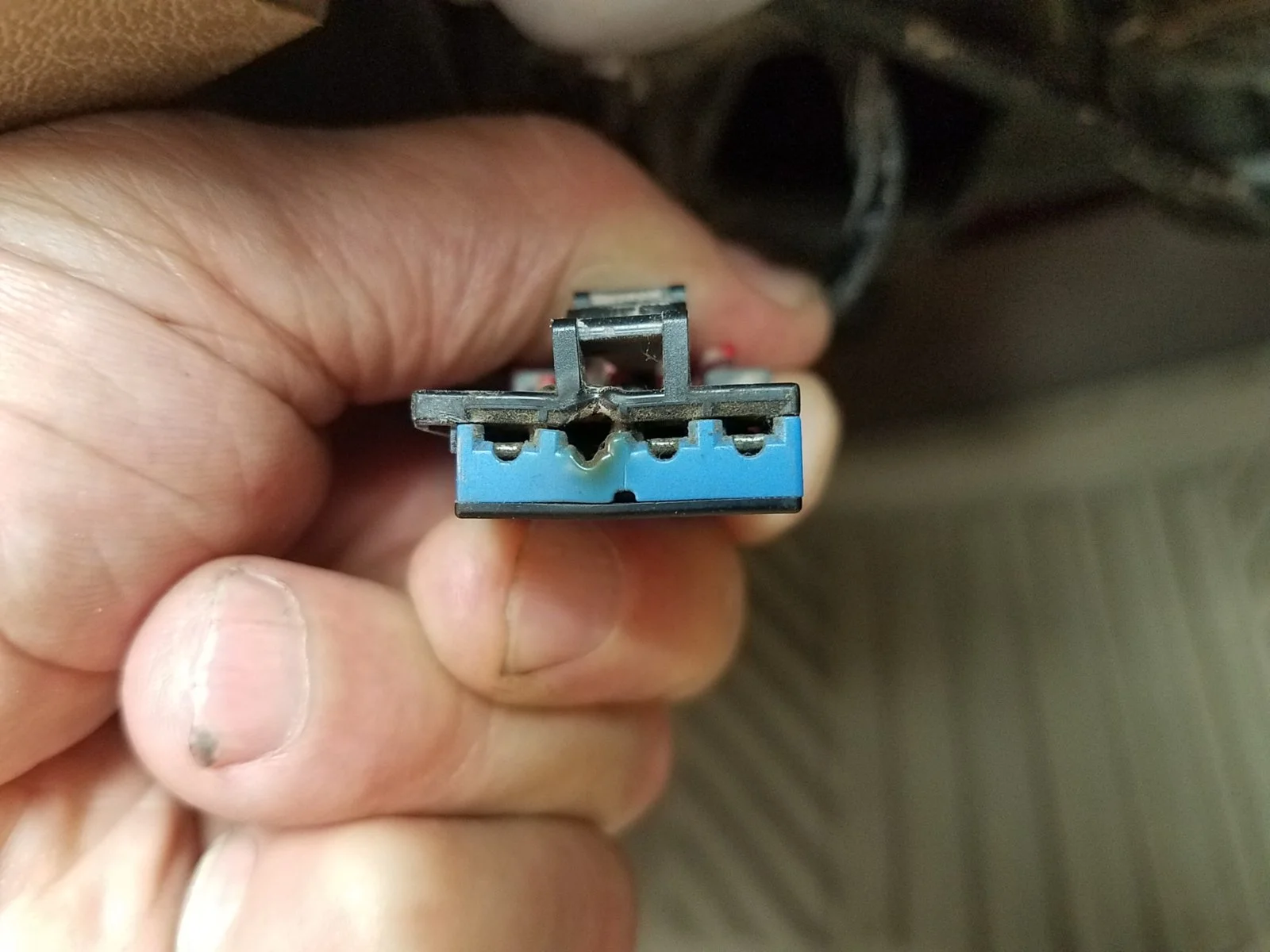

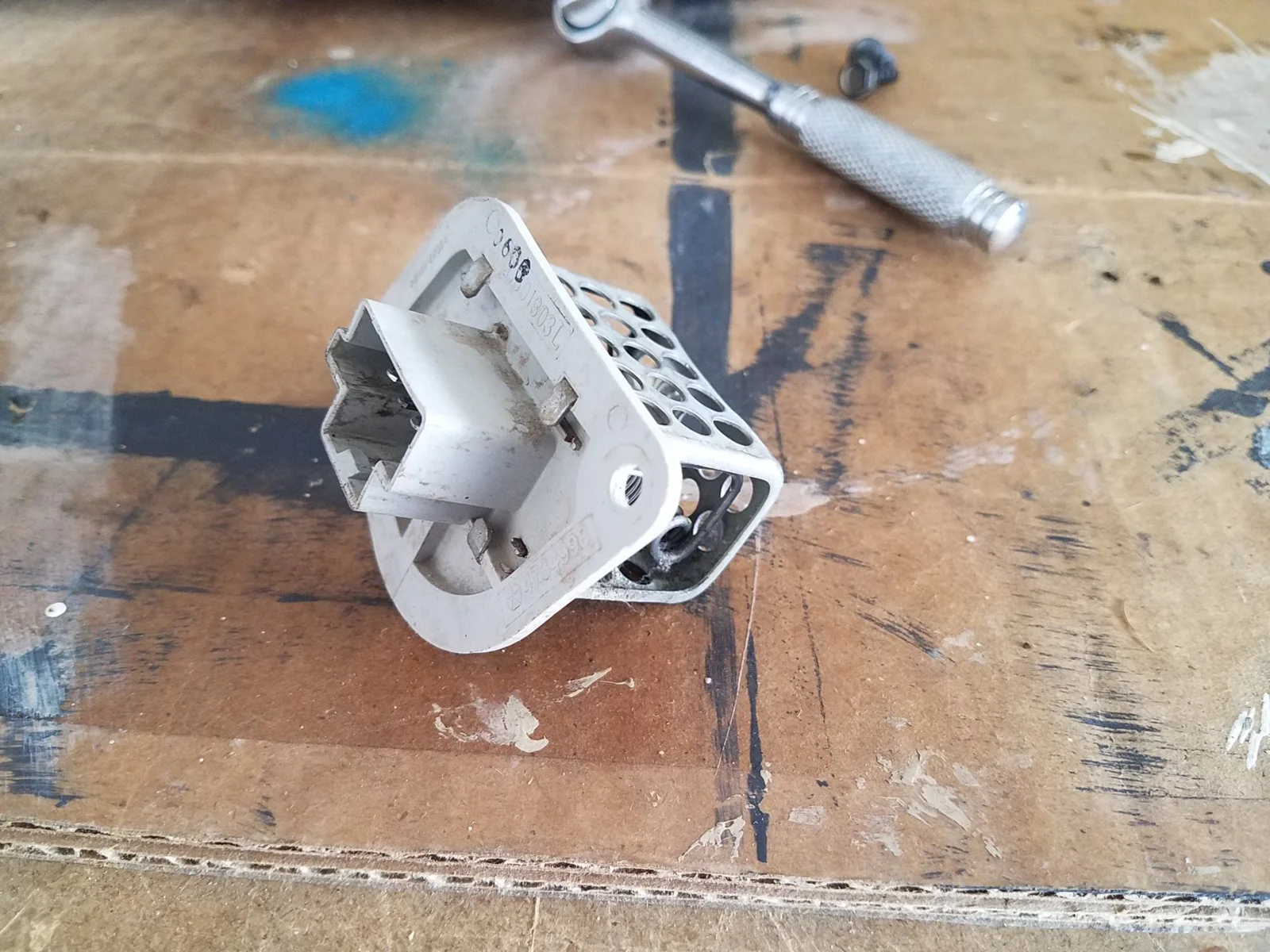

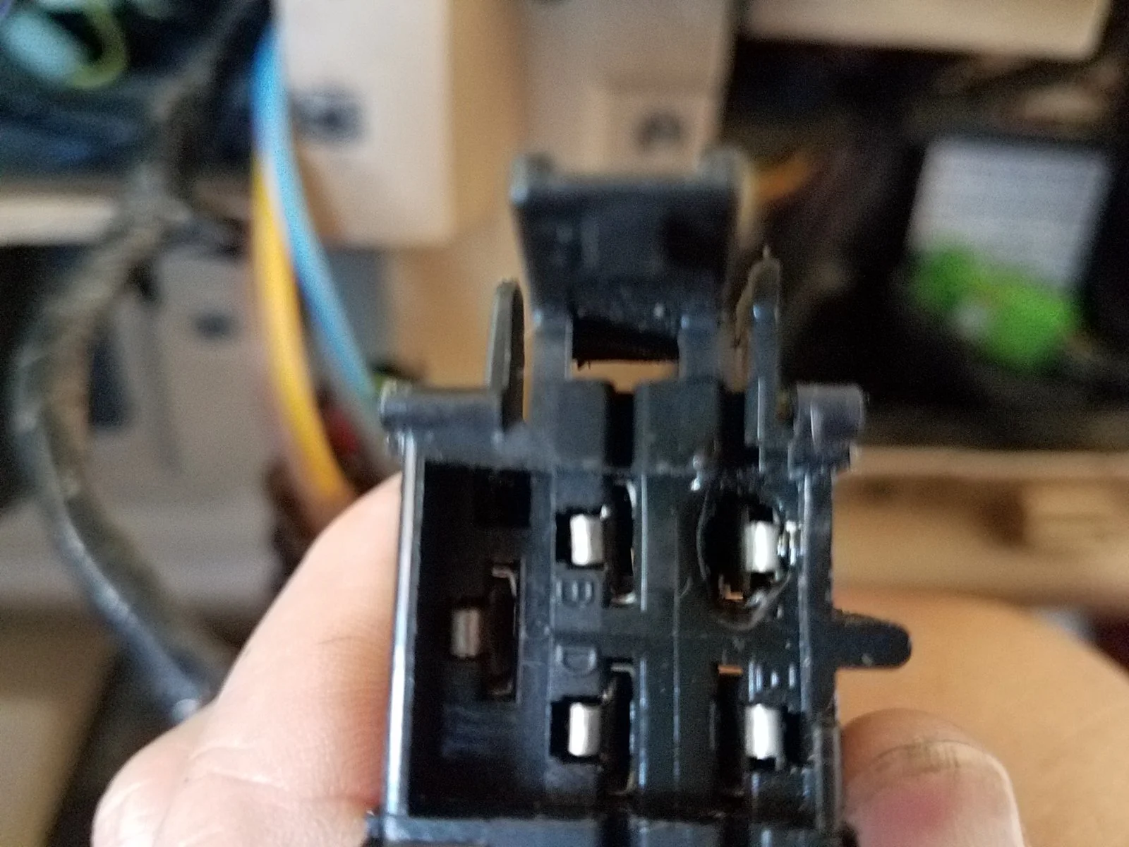

I have a 1999 TJ with after market AC. After going off roading, I turned the fan switch to high and no AC was blowing. I pulled out the blower motor resistor and the harness to it had melted on one of the connections. I then removed the blower motor and tested it with a connection to the battery, it worked fine. I also pulled out the fan blower switch and noticed than one of the connectors in the harness was also melted.
So Far I need to replace the resistor, the harness to the resistor and the fan switch. Should I also replace the blower motor?
99.99% chance it's the blower motor itself melting the wiring, connections, switch, etc. When its windings start shorting together, it starts drawing more current. So while it still spins when you apply power to it, odds are it's drawing double the current it should be.
