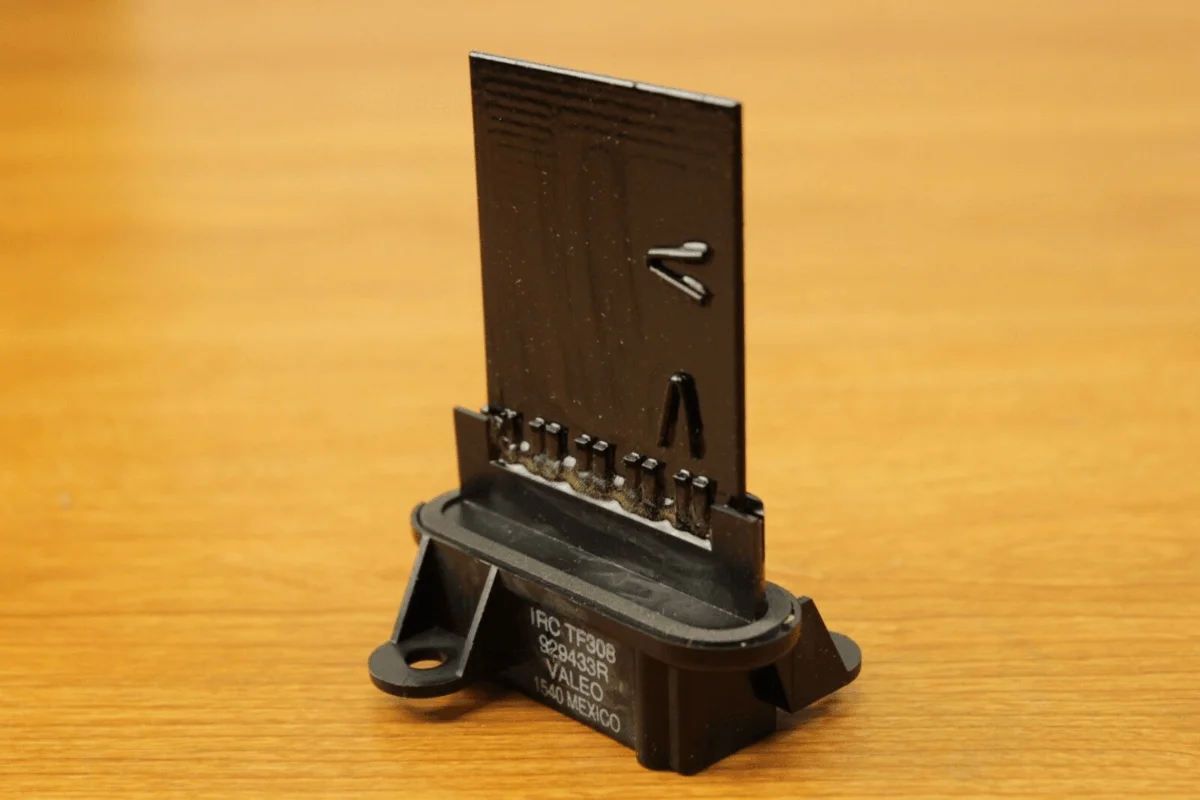

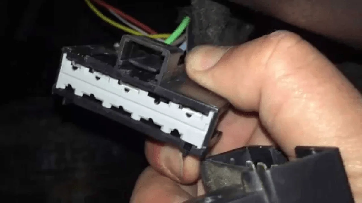

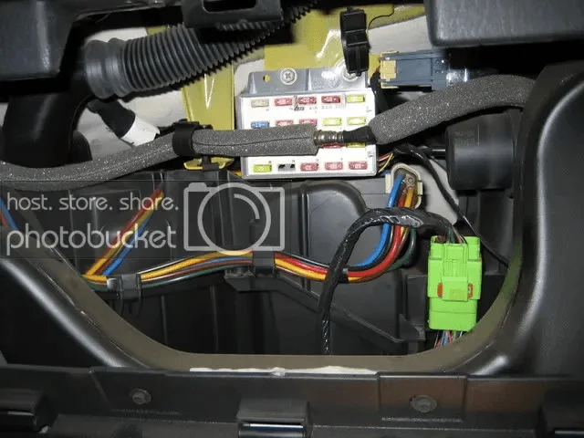

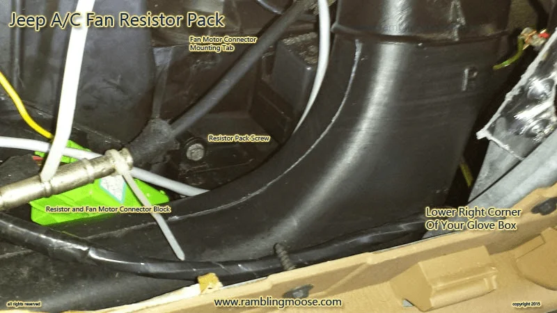

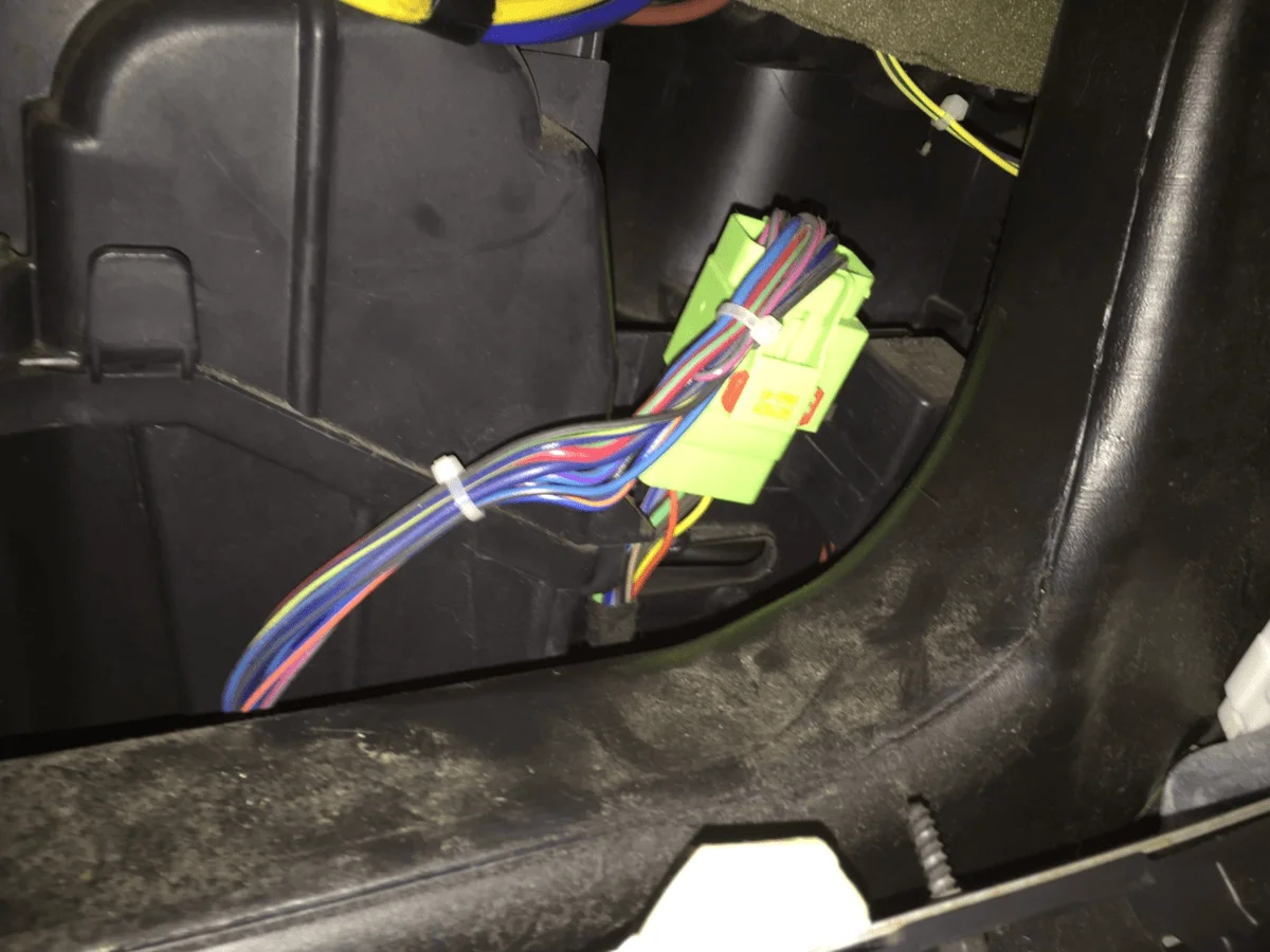

I recently did mine, unless you have very small hands, and don't mind being upside down at neck breaking angles for about a 1/2 hour it's a pita to get out, easier back in. I hate the electrical clips with tabs, they always seem to brake, there is a big green one and a smaller black one. The job itself isn't bad, it's just the location, but it is 100% the resistor & will correct the fan speed issues if only some speeds work ( usually 1 or 2 or both ) & others don't.
OEM on ebay was $25 shipped. For others that haven't found one yet or need to do this these pics should help.
