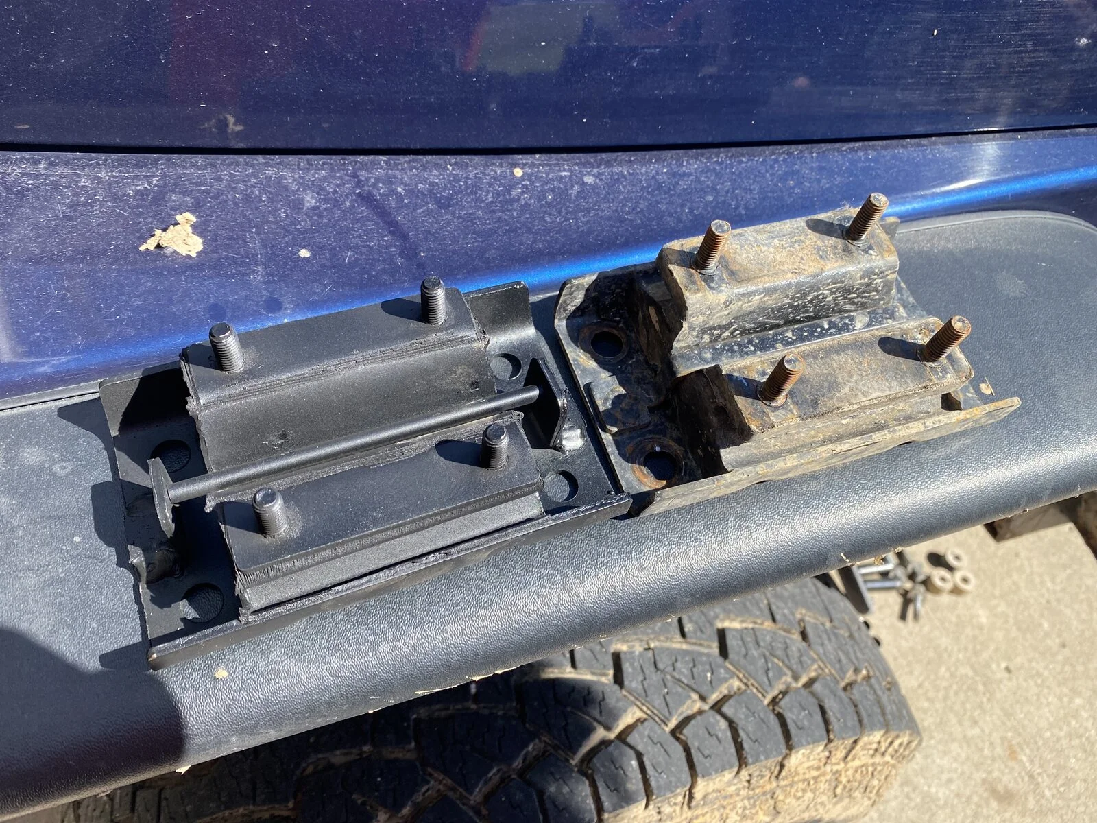

Last year when I was installing my Savvy tcase shifter cable I noticed my tranny mount was torn in several spots. I went to Autozone and bought a replacement. Every since then I have had a pretty bad vibration at idle when in gear after the Jeep warms up. At the time I couldn't find a mopar replacement to try to see if it was the tranny mount that was causing it. I was reading a thread a few days ago and saw someone said the Crown replacement was the same so I ordered one off of Amazon and installed it today. The vibration is 100% gone. Kind of mad I waited so long to replace that piece of crap Autozone mount.
The cheap Autozone mount's bushing was likely polyurethane which passes vibrations far too well. For engine and transmission mounts always stay with good quality rubber-based mounts. Some rubber mounts like from Brown Dog are stiff enough to be nearly as bad as polyurethane for passing vibrations.
