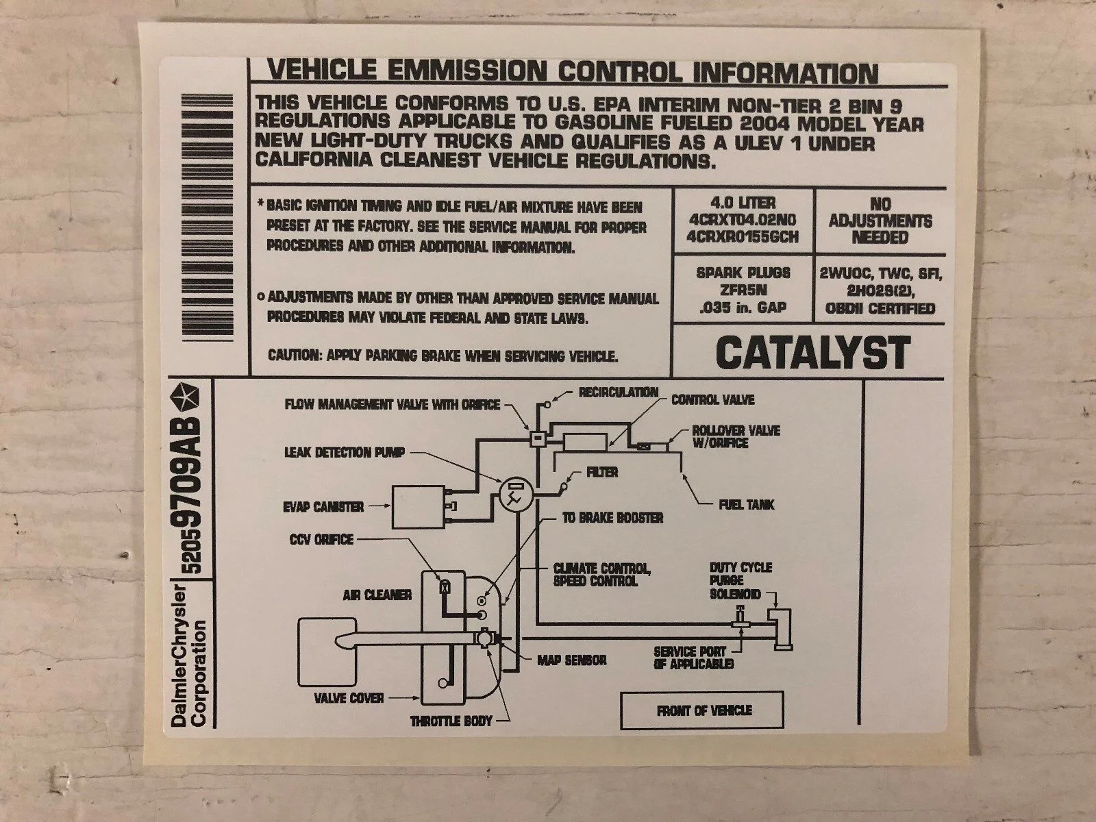

You don't need it anymore, but fyi here is the '04 TJ 4.0 emission decal:
