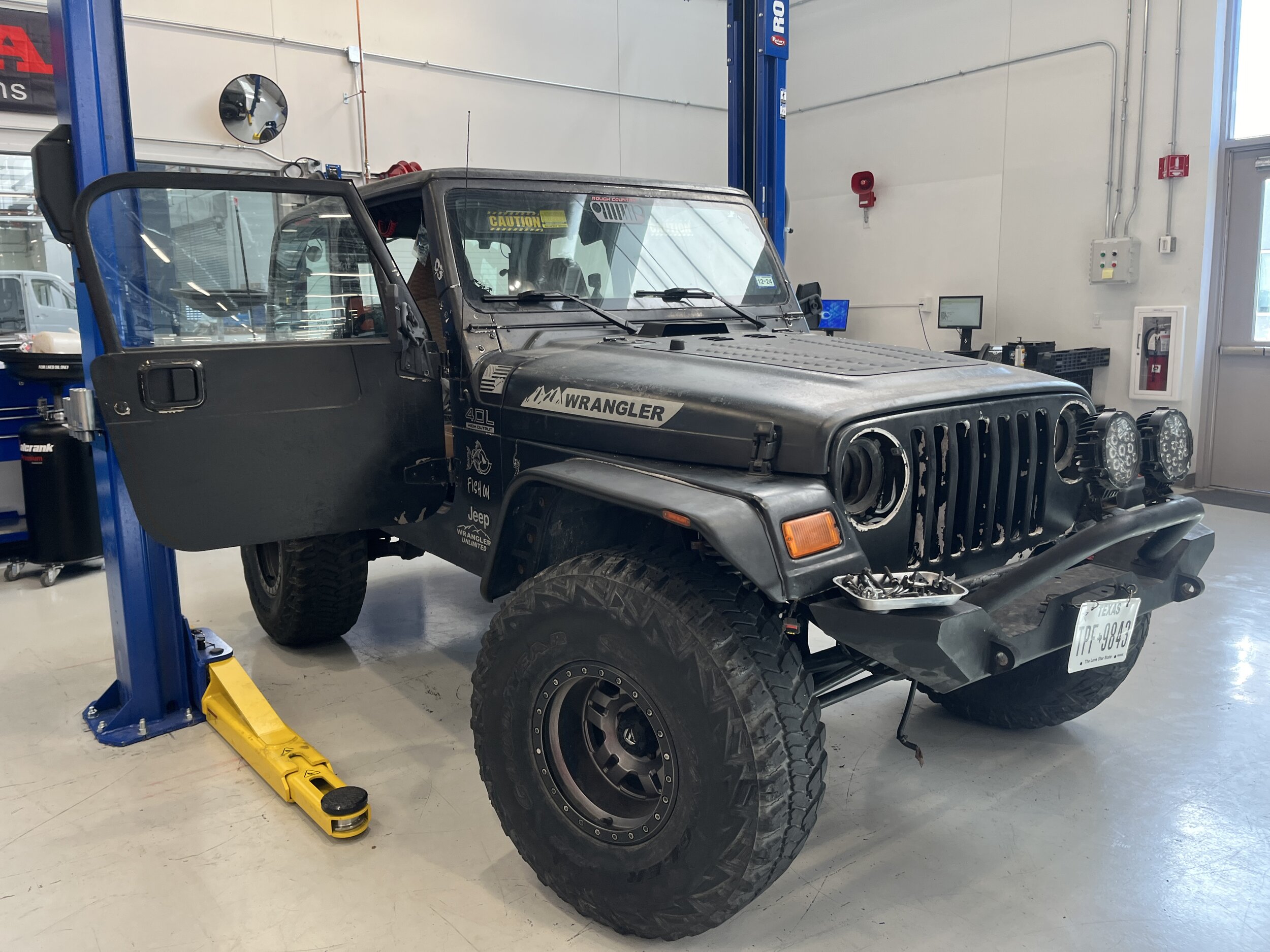

As I’m getting closer to completing my Wrangler, I’m wondering the proper procedure for first start-up and break-in. I’ve read couple of threads and check the Haynes manual about this and I’ve come across multiple different methods and I’ve came to this conclusion:
First start up:
Use 10w-30 break-in oil (Royal Purple), start engine and run for 20 minutes at 2k rpms.
Then, change oil to 10w-30 conventional. For 500 miles, drive with full throttle 30-50mph and let it slow down to 30mph and repeat for 12 times. (No sustained high speeds)
Then after 500-600 miles change oil and drive few hundred miles normally, and after 2000-5000 miles change oil.
Break-in done.
I’ll like to know if this is the most correct way and what y’all think.
1998 Jeep Wrangler with 05 4.0 swap
