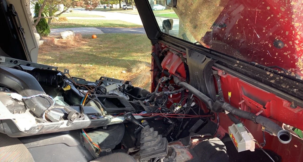

The ongoing battle of no heat has come to an end (y). When I first bought my jeep I had no clue what I was doing. I had a shop install a heater core (spectra brand) and have not had heat for a little over 2 years now. Tested everything, flushed the coolant, and did any little thing you could think of. I thought it had to be a faulty heater core. To make a long story short, the heater core that was installed blew up on me and I knew I had to do something. Got a performance radiator brand core, just installed it 2 days ago and boy do I finally have heat!
Unfortunately with the dash removal I smacked my windshield and received a nice crack, the trade-off, a cracked windshield for some heat on those -40 mornings is 100% worth it LOL. For about 5 hrs of work, and my first heater core job, I am very pleased!
